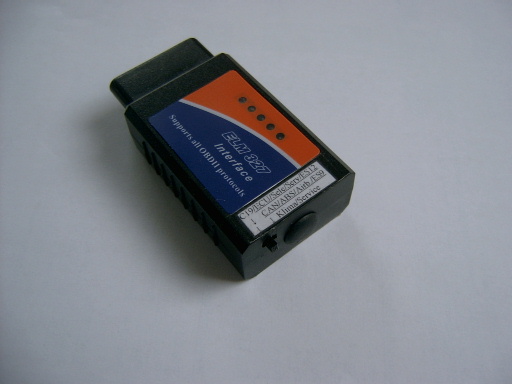

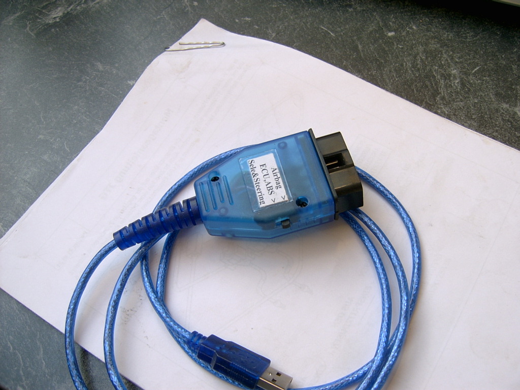

Re: PURPLE ADAPTER # 4
hello
You have only one adapter ???? :)
Why did you ever an adapter? ;)
As I have written before, I have no adapter
My interface could pin this already 4 years ago :D
SV300002 (2).JPG (201.73 KiB) Viewed 8839 times
For explanation
But the other users here need this adapter ?? ;)
