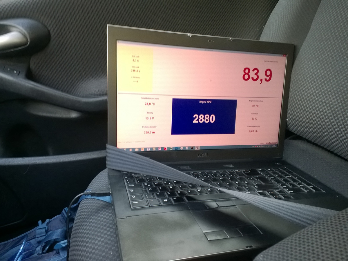

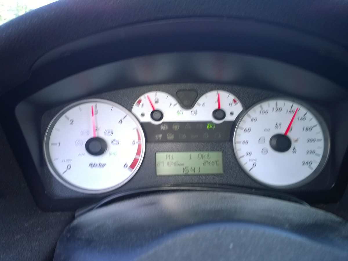

yesterday i have used FES Dashboard for the first time and i have found a bug (on Fiat Stilo 1.9 JTD). The vehicle speed is not correctly (is it mph?). Look at the pictures.

So you have been driving 150 km/h and FES Dash was showing 84 km/h (or something else)?
Did you checked speed with MES? How much there was your speed? The same more-less or totally different?
If with MES is all OK than I guess it is a bug in FES Dash...

Yes, i was driving 150km/h with cruise control and FES Dash was showing 84 km/h...
The speed in MES is correct.
