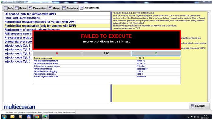

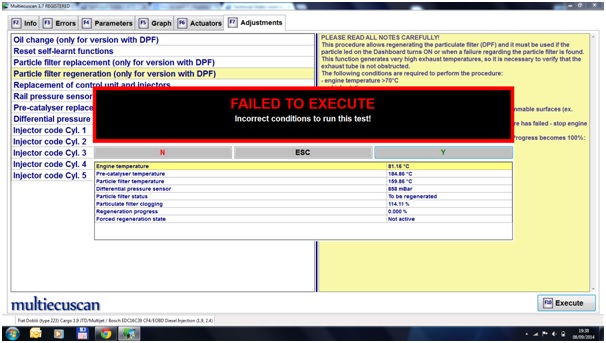

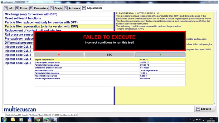

In the last two days I just tried to do the force regen, with same failings. See pics
Doblo-DPF force regen-fail-1.jpg (94.58 KiB) Viewed 3354 times
Doblo-DPF force regen-fail-2.jpg (94.24 KiB) Viewed 3354 times
Doblo-DPF force regen-fail-3.jpg (75.38 KiB) Viewed 3354 times
So what conditions exactly needed for force regen?
Pleeeeease HELP!!!
