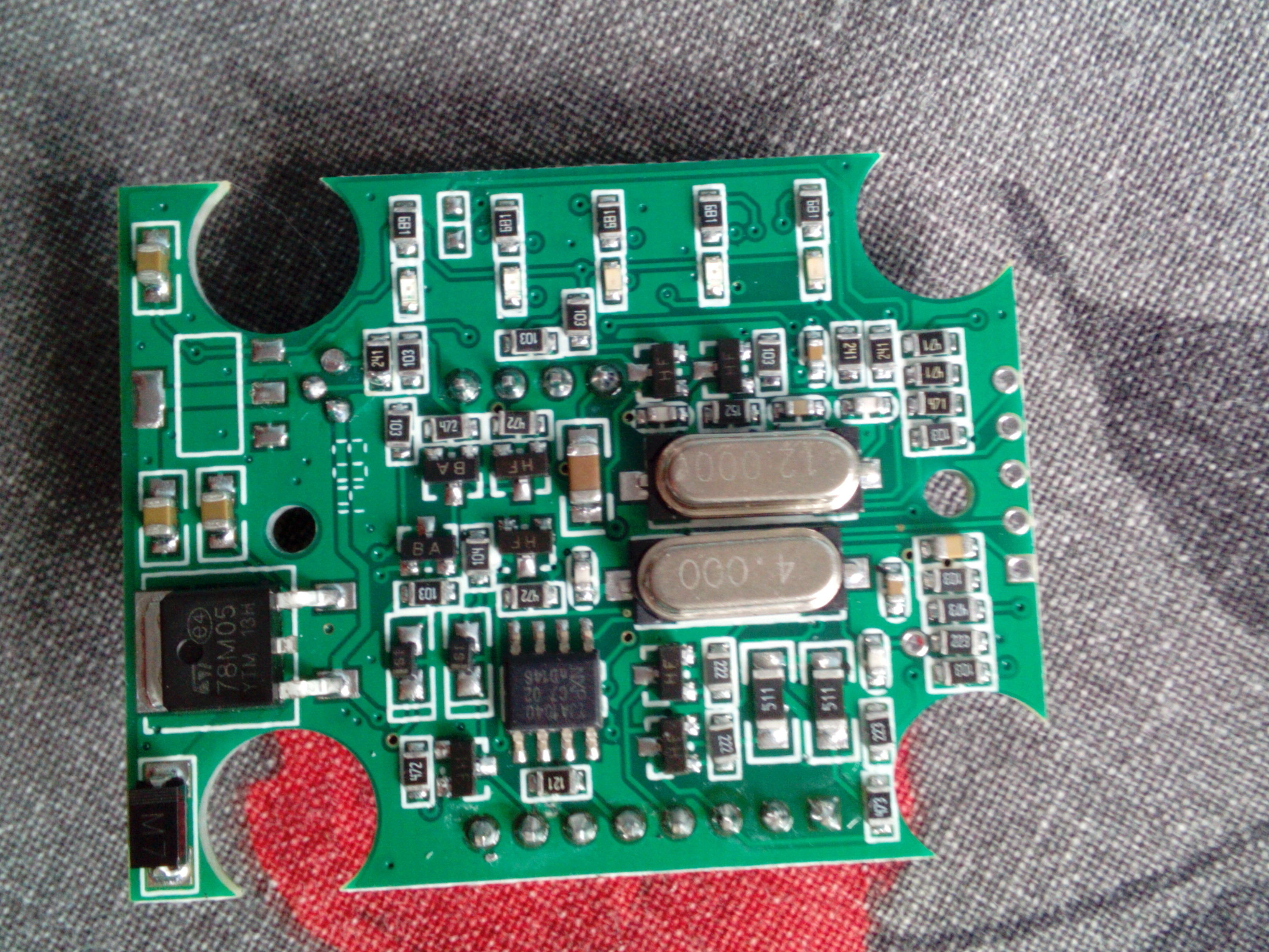

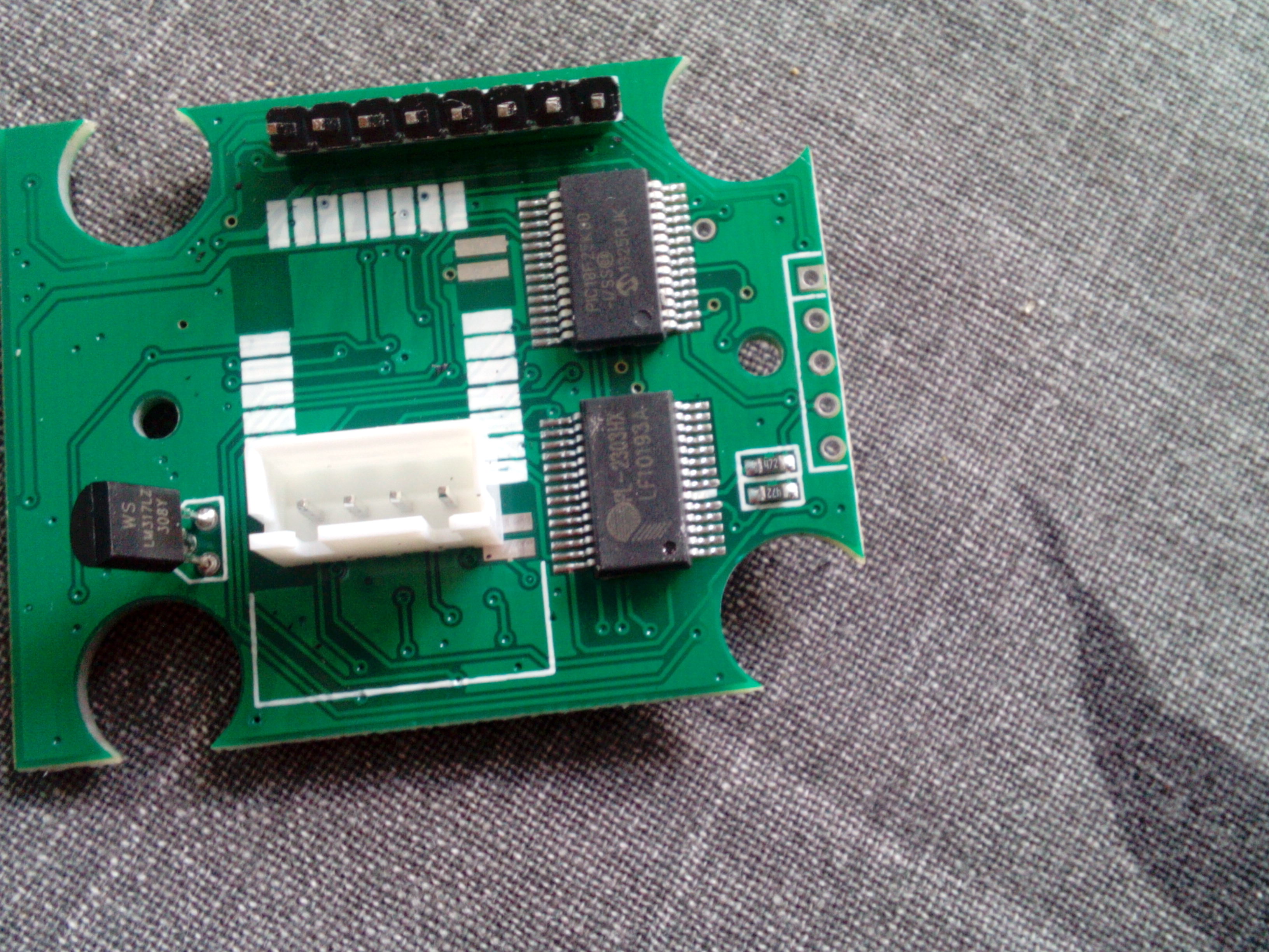

Hi.I can not conect to dashboard, servise and body computer.Could someone point me on which resistor should I remove or what I should do?I can only conect to engine.Thanks.

That car which I try conect is alfa romeo gt 2.0 jts 2004 year. Please help me.

Re: Problem with my ELM327
hello edgarss24
If a CAN bus problem! I told you already answered here.
viewtopic.php?f=5&t=1493&start=1410
Just as Walter already asking what software you want to read?
and what controls?
With MES you can read
Engine ECU, ABS and Xenon you must can read without removal of the resistor.
For Body , Clima, Instrument Panel , CAN setup you must remove the Resistor
