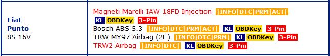

This is your Punto, right?
Fiat Punto 85.jpg (20.14 KiB) Viewed 2587 times
There is yes you need a KKL interface
with the ELM interface, you can not do anything
Buy yourself the KKL from your link and you'll be able to connect
But you need the registered version to your engine control unit to correctly read.
