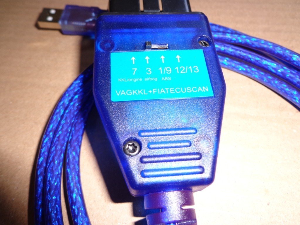

Hello I would like to buy a used multipla bipower cng 2002-2003 year and I bought Vagkkl interface cable:

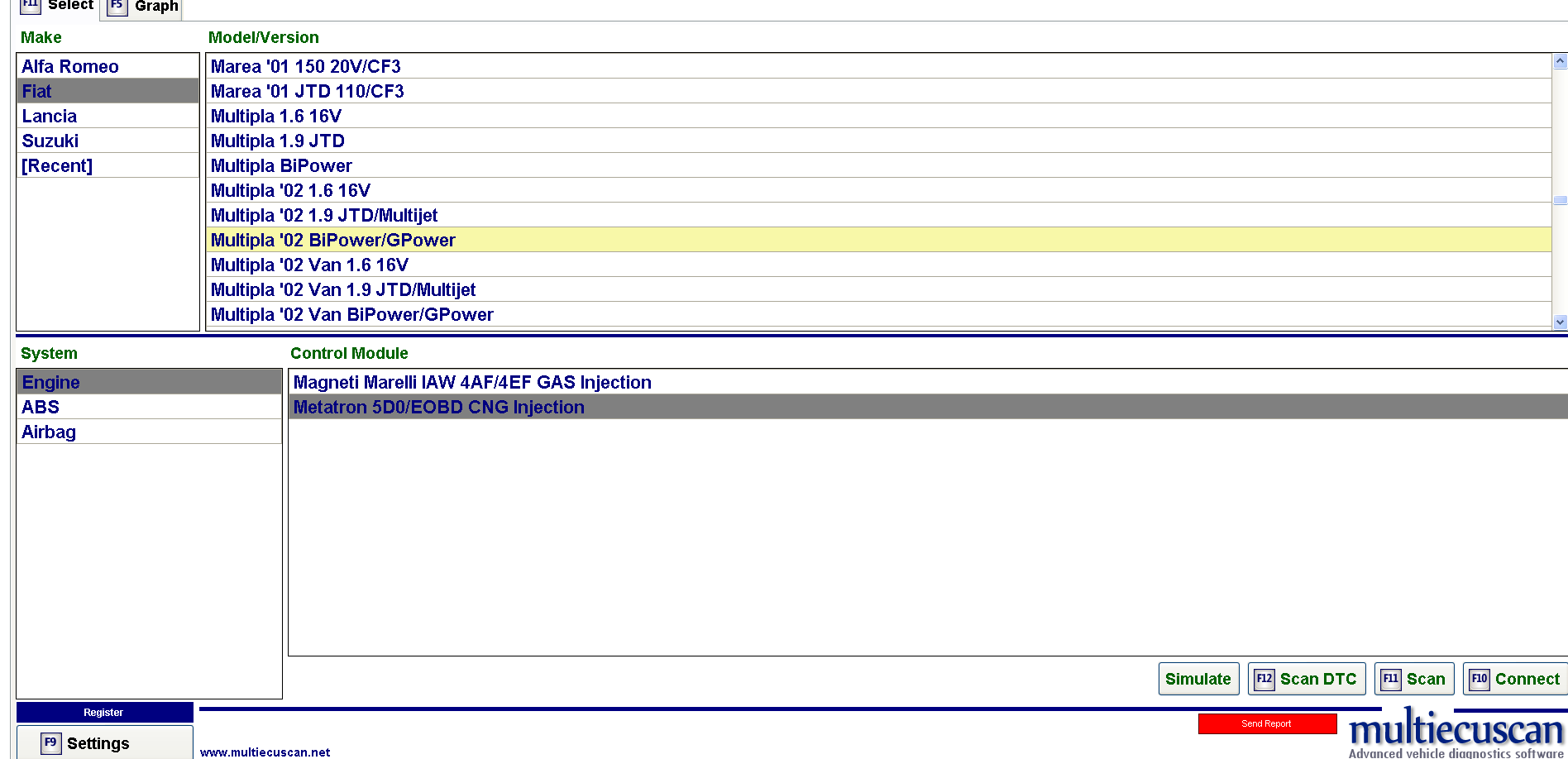

My idea was that I hunt for the odometer km on dashboard, engine, abs and airbags but:
I played in simulation mode and in simulation in Multiecusacn 1.4 version I can only see engine, abs and airbags there is no dashboard and body (proxy alignment for example)
www.imagebam.com/image/c776ca280308839
Do we have in multipla at all the dashboard, services, body, climate control and other system ecu options like on punto, bravo and other Fiat cars.
Or is this just it? Or its just like that in the simulation or with this particular interface.

I know where are odometer parameters in Engine ecu.
I'm trying to find out how could I connect to body, service and dashboard ecu system and also I'm trying to find out how can I see parameters like km from abs and airbags like on Stilo models which I saw on Examiner.
Re: Vagkkl interface cable /Multipla /searching for odometer
In MES only the ECU, ABS and airbag is supported for your Multipla
You can read all this with your KKL interface switchable
I do not think the example the air conditioning is supported
But press nevertheless simply times when the switch is set to 1/9.
Whether an air conditioner is found.
I do not think.
