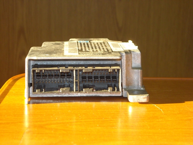

please pinout alfa 60675880
12V ?
GND ??
K-line ?
s130

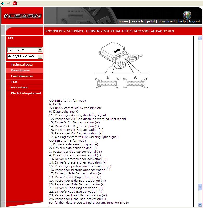

This ECU comes from Alfa X1 156 MY 2002, T7 156 BENZINA (1997-2002) and T8 156 TD.ID (1997-2002)
If you can locate and electrical wiring diagrams for a Alfa 156 then you will be able to get the pin numbers ok.
Re: help me airbag alfa 60675880 pinout
@ michal_m
The easiest way is to find on internet Alfa Romeo 156 eLearn CD.
In that CD you have all electronic schemes which include airbag system as well.
You even have which wire is which colour and of course pin out from ECU to each airbag...
Here is photo... ;)
Alfa Romeo 156 airbag pinout 2 way connector.JPG (102.55 KiB) Viewed 3409 times

Thanks !!!
Is OK !!
