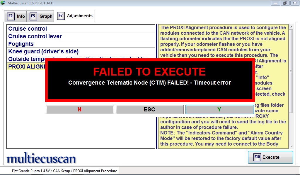

A friend has updated his Blue&Me on a Grande Punto 1.4 16v. This has left his odometer flashing, which we understand to need a Proxi Alignment.
Carrying out the Proxi Alignment, it writes CAN configuration data to Body Computer, Dashboard Node and Airbag Node, but the next module is the Convergence Telematic Node (CTM) which fails. The message is Convergence Telematic Node (CTM) Failed! - Timeout Error (see screenshot)
Would appreciate any help in identifying the problem.
Some thoughts:
Have we selected the correct vehicle? We chose Grande Punto 1.4 16v T-Jet/Starjet. This is the only 1.4 16v listed. It is not a turbo, so presumably it is known as Starjet. Is this correct?
If not the correct vehicle, is the correct vehicle supported?
Can MultiECUScan select the vehicle automatically?
Log file reproduced below.
Reading CAN configuration data ...
CAN CONFIGURATION DATA:
6F 80 00 04 02 00 00 00 6F 80 00 04 02 00 00 00 00 00 00 00 00 00 00 00 00 00 00 00 00 00 00 00 00 00 00 00 00 00 00 00
6F 80 00 04 02 00 00 00 09 00 00 04 02 00 00 00 6F 80 00 04 02 00 00 00 09 00 00 04 02 00 00 00 09 00 00 04 00 00 00 00
33 38 31 39 39 30 30 33 37 32 38 4F 55 54 50 55 54 2D 4A 49 54 20 06 03 31 6F 80 00 04 02 00 00 00 09 00 00 04 02 00 00 00 90 20 03 07 58 00 2A 20 A3 80 00 0E 00 00 00 84 06 01 01 00 00 00 00 00 3A 51 05 0C 0D 00 00 00 00 00 00 00 00 31 12 40
CURRENTLY CONFIGURED CAN MODULES:
Body Computer Node (NBC)
Engine Control Node (NCM)
Electric Steering Node (NGE)
Dashboard Node (NQS)
Receiver Radio (NRR)
Brake System Node (NFR)
Side Acceler./Yaw Node (NYL)
Airbag Node (NAB)
CURRENTLY AVAILABLE CAN MODULES:
Airbag Node (NAB)
CAN MODULES THAT REQUIRE EOL PROGRAMMING:
Airbag Node (NAB)
06/09/2013 19:53:18
CONNECTED TO:
Fiat Grande Punto 1.4 16V T-Jet/StarJet
CAN Setup / PROXI Alignment Procedure
CURRENTLY CONFIGURED CAN MODULES::
Body Computer Node (NBC):
Engine Control Node (NCM):
Electric Steering Node (NGE):
Dashboard Node (NQS):
Receiver Radio (NRR):
Brake System Node (NFR):
Side Acceler./Yaw Node (NYL):
Airbag Node (NAB):
Convergence Telematic Node (CTM):
CURRENTLY AVAILABLE CAN MODULES::
Airbag Node (NAB):
CAN MODULES THAT REQUIRE EOL PROGRAMMING::
Airbag Node (NAB):
EXECUTING ADJUSTMENT...
PROXI ALIGNMENT PROCEDURE
Writing CAN configuration data ...
Writing to module: Body Computer Node (NBC) SUCCESS!
Writing to module: Dashboard Node (NQS) SUCCESS!
Writing to module: Airbag Node (NAB) SUCCESS!
0
Writing to module: Convergence Telematic Node (CTM) FAILED! - Timeout error
FAILED TO EXECUTE

Which interface do you use? Clone or original? :roll:
