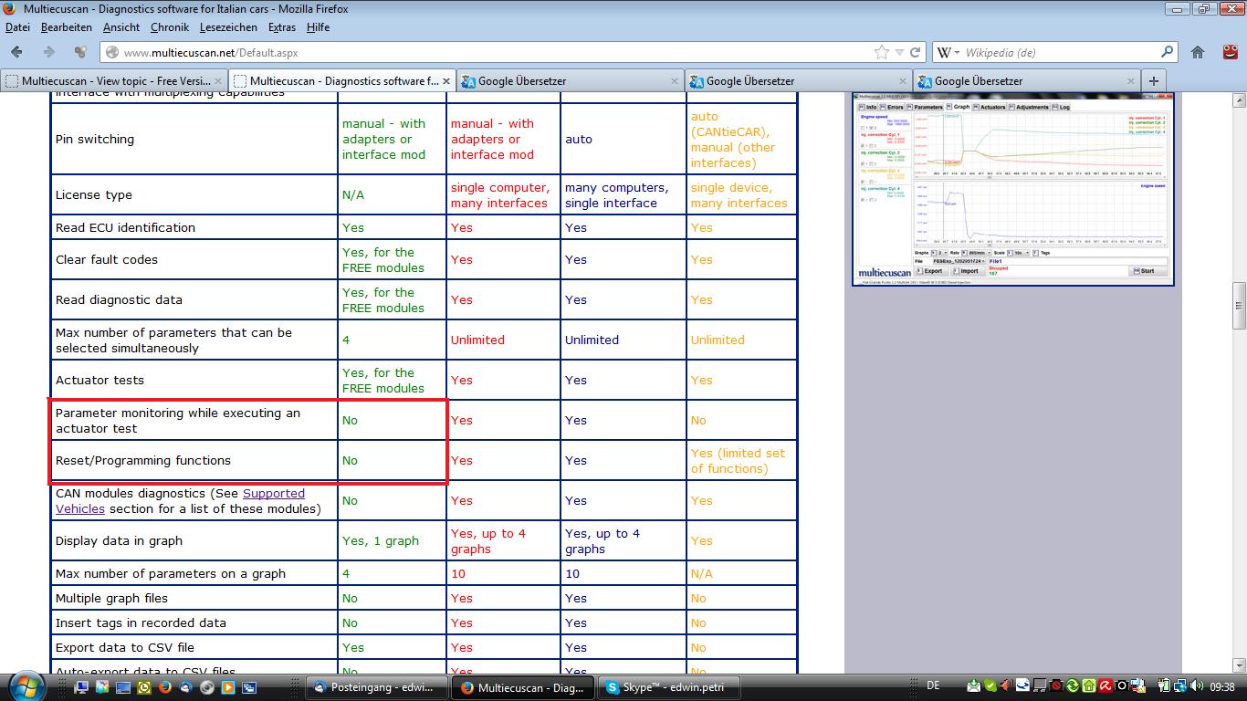

I'm trying to do a clutch bleed and EOL on my 147 selespeed using the free version of the software, but I get an error saying I need to the registered version. Is this right? I thought the free version had full access to all supported modules?
Re: Free Version Restrictions
Even if your controller is specified as free, there are some limitations.
It does not mean that you can take full advantage of this without a license.
You can also read on the first page here
Go buy a license (50 €) is to drive a lot cheaper than in a workshop
