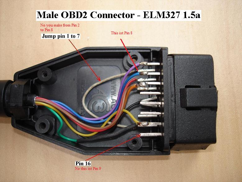

Thanks for the reply. I may have found the reason for the ELM327 1.5a not work with ABS.
In the "Supported Vehicles" section it is shown (adapter cable 1) that the pin 16 of the male connector must connect to pin 16 of the female connector.
However the pin 16 of the male connector (ELM327 1.5a) is not connected to the circuit, in other words the pin 16 is disconnected from the circuit.
Can this be the reason?

Re: ELM327 does not connect in ABS system
Post by Overdrive »
My ELM is in aluminum alloy housing. :(
Below photo of the connector with the jump from pin 1 to pin 7
Pin 16 not connected to the circuit ELM
Now it becomes clear why it is not working.
You've confused the pins and counting started from the wrong side.
tvEYh geändert.jpg (71.28 KiB) Viewed 37899 times
