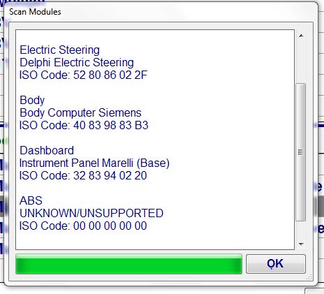

Sent off reports. Tried connecting through 500 1.2 ABS. This doesn't work either. Causes clock and trip meter to clear. Causes U1602 can error.
Can't actually connect to the ABS module, only see it when scanning. Sees ABS with OBDkey and with OBDkey/Green connector. Can't connect.
I have attached a JPEG of Green connector scan.

Re: ABS panda 1.2 2009
I saw the report which you sent....
The result you see from the SCAN function is a misidentification - it doesn't find any ABS module.
The ABS module in your Panda is Bosch ABS 8 and it is the same even in the 2010 model.
You should be able to connect to it by using the green adapter and any of the interfaces. If you cannot connect then then there is probably a problem with the power supply/grounding on the OBD connector or ABS module.
Of course it is recommended to first check the wiring of the green adapter with an ohmmeter. It should have connection between pin 1 and pin 7.
