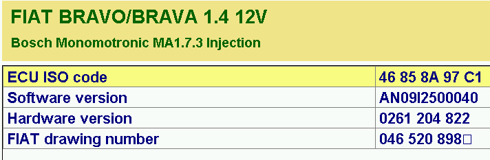

Re: Fiat Uno 1.0ie assembled in poland 2000, Bosch MA1.7
Hello again
I attached ISO code I read out from first page.
maybe it's not directly connected with what we are talking about, but here is another, Polish made software to diagnose MA17 working with FSO Polonez:
http://www.youtube.com/watch?v=vfBOekw98Pw
I still have to fix problems with very frequent disconnects.
- uno iso code.png (5.13 KiB) Viewed 8161 times
