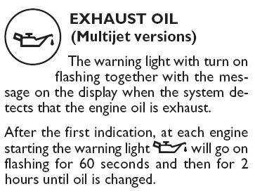

I made Oil change
EXECUTING ADJUSTMENT...^M
Wymiana oleju (tylko dla wersji z DPF)^M
WYKONANE^M
and now the Oil degradation level is set to 100.00 %, the oil light on dashboard is blinking.

On vehicles with a DPF, I believe aswell as the service resets on the instrument cluster, there is a separate oil service function on the engine controller (along with DFP regen etc).

On your Croma there are TWO resets that need to be done. The Service Reset and Oil Change Reset.
The Oil Change Reset is done via the Engine ECU under "F7 Adjustments" control section/tab

Ok, now it's not blinking, i'll monitor this and i'll inform if there is still problem.

I am wondering with much of the individual ECU software versions and levels that it takes a shut down/restart of the ECU to correctly report the new state. A shutdown/restart would be a disconnect of the ECU software. A disconnet of the hardware followed by and ignition off/on cycle.
