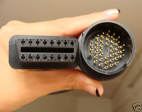

I have actually an iveco daily with an 2,8JTD Power Motor ( like Ducato 2,8JTD Building 2003) The Problem here is, that the iveco don´t have the normal 16PIN OBD-2 Plug . this vehicle have a round 38PIN Plug.
Does anyony have an idea how to works with this vehicle an ecuscan ? Unfortunally i don´t now if it´s possible to work with an adapterplug to connect.

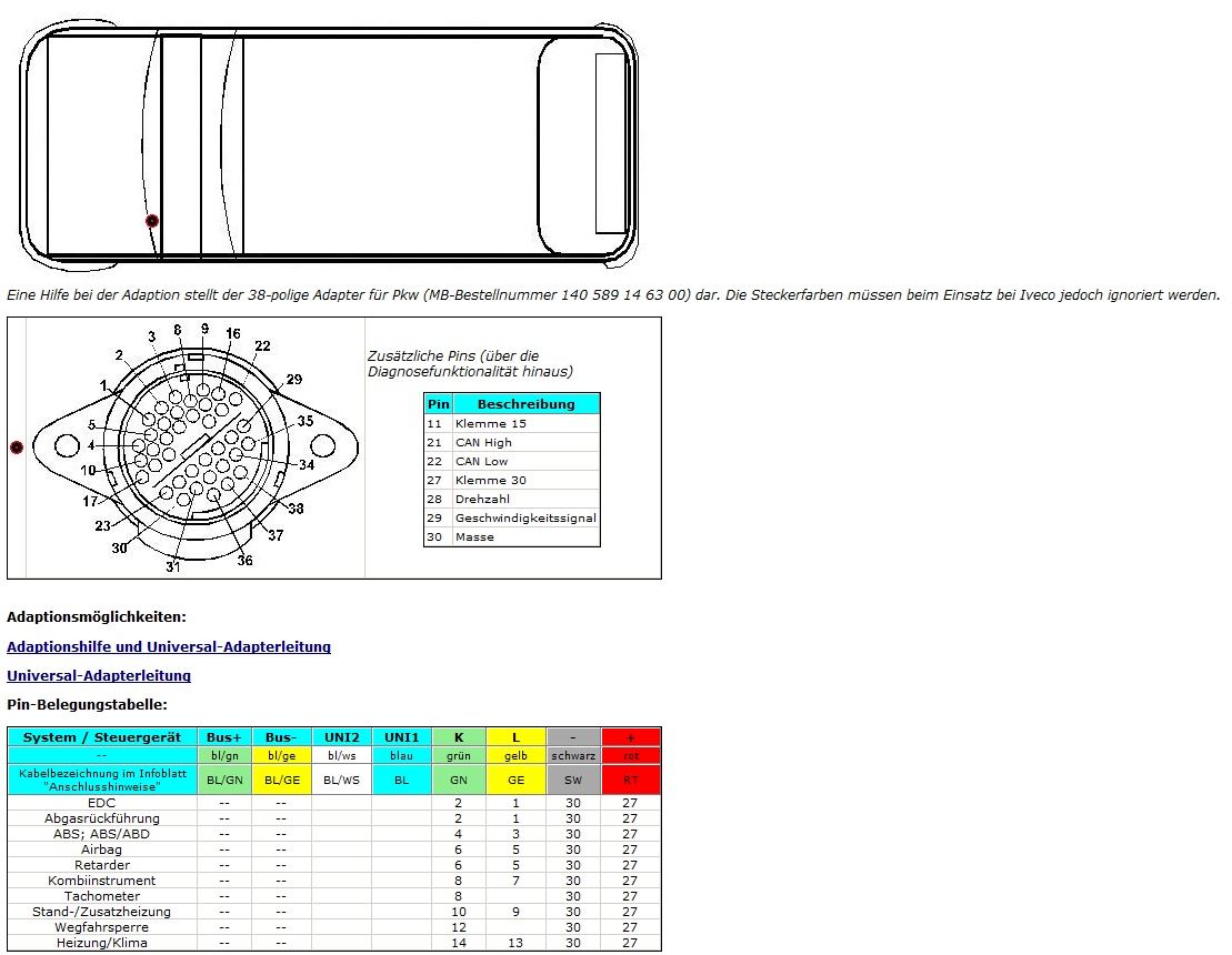

Hey here is the connector pin description

Thanks for the plug diagram !!!
greetz Freddy
Re: Congratulations to this very good software
i am not sure,
but for me it looks like you need a Mercedes Benz connector...
testourii
Joined: 04 Dec 2009, 15:28
Post by testourii »
yes, it's same as mercedes benz connector, I use it to program key to IVECO daily
