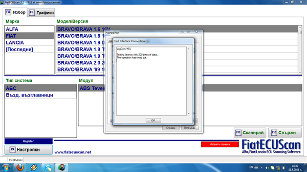

i have a problem with the connecting to the interface and here in the picture you can see the false wich give the FES; what i have to do now ? i have been put the drivers and i made change in the default configuration in control panel, but i still can`t connect

Did you connected interface from laptop in to the car?
Re: i can`t connect to the interface
yes i do, the cable is working correctly, the LED is lighting, but i have a problem maybe with the software

Did you try to do it with an English set up language (both parameters)???nedialko wrote:yes i do, the cable is working correctly, the LED is lighting, but i have a problem maybe with the softwareit looks like nobody had this problem

I suspect that the settings do not agree
Do you have the latency value in the Control Panel / Device Manager / Com Port / properties of 16 set to 1 down?
If the FTDI drivers installed?
Have you in FES / Settings / Interface interface and the right Com Port
set?
If it does not yet work in FES / settings / interfaces in "high latency mode" set a hook.
If that does not work yet, please register again
It could also be a defect of the interface.
set?

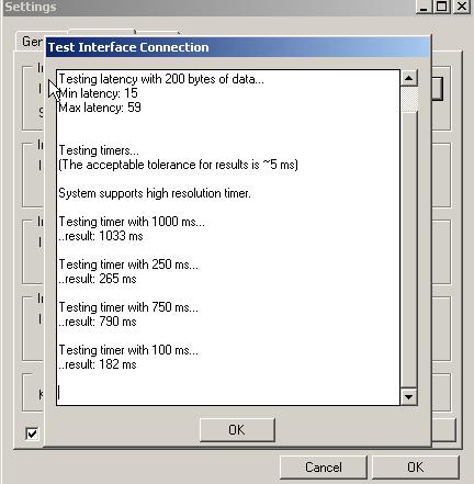

- tell me if this latency is ok ?
- tolerance for results is only +/- 5 msek.
- from time to time, the program FES breaks the connection.
