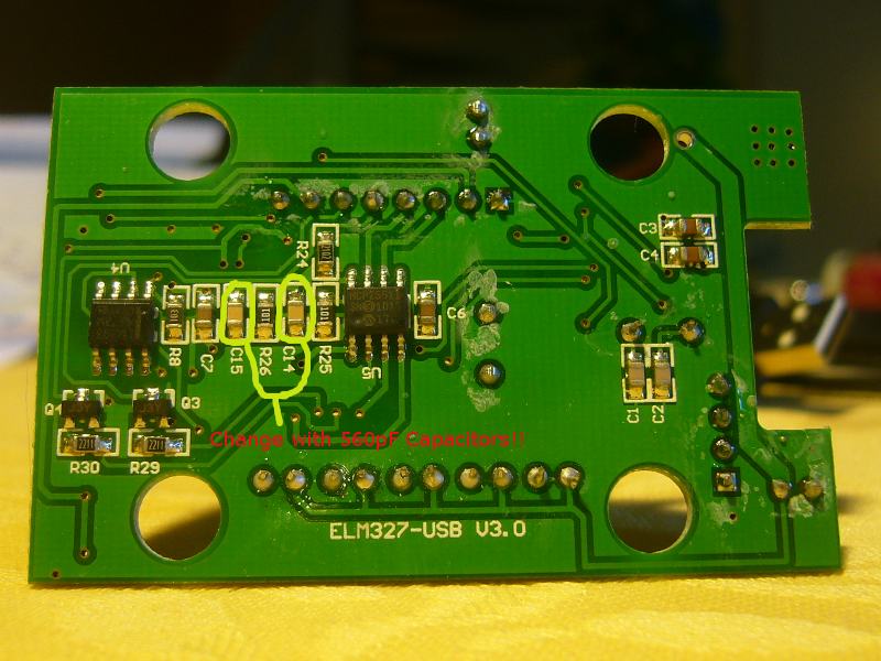

I have tested one sell from the italian distributor with the same label into the back, and have the 2 capacitor c15 and C14 of the wrong capacity... about 100 mf istead of 560 pf..
If you need these are the schema form the Yani post..
And this is the image with the 2 capacitor you need to change...
Elm327-usb V3.0  with the wrong capacitors
Bye Matteo
