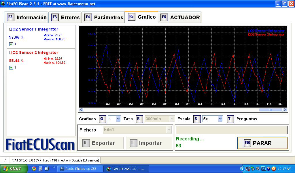

O2 sensor integrator
O2 SENSOR integrator 04-2011.jpg (444.49 KiB) Viewed 2291 times

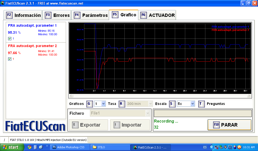

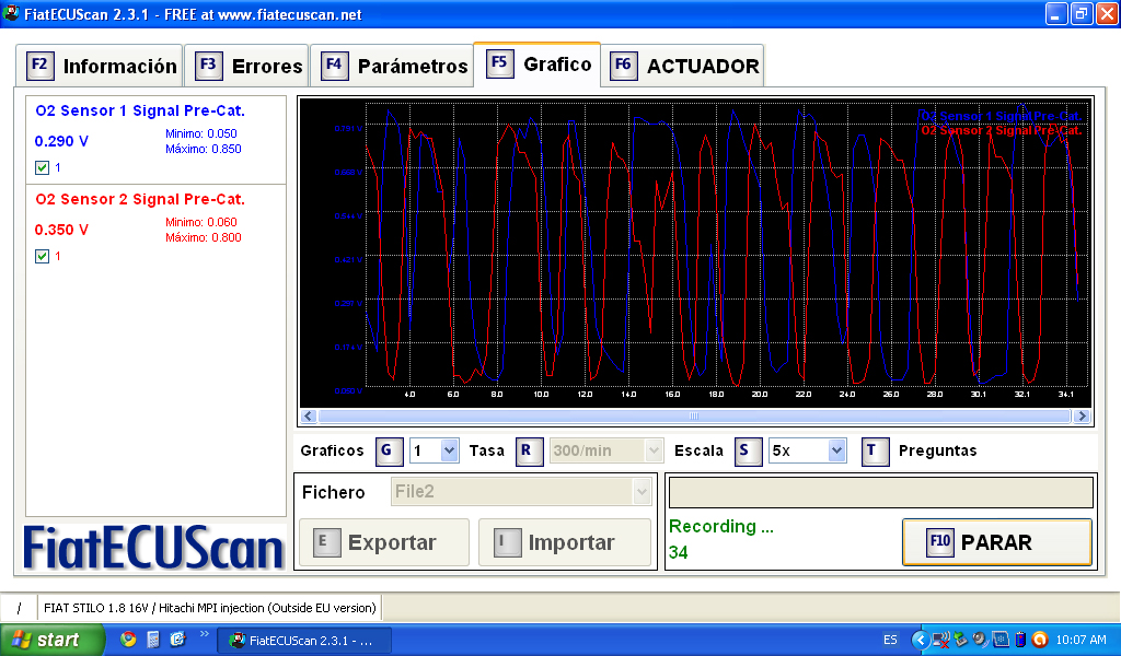

I have a 2006 stilo 1.8 16v 104000 km. Should I change
O2 sensors? I am attaching some plots
multiecuscan
O2 sensor signal
O2 sensor signal
O2 SENSOR 24-04-2011.jpg (469.61 KiB) Viewed 2291 times
FRA autoadapt
FRA autoadapt
FRA autoadapt parametr 2011.jpg (399.18 KiB) Viewed 2291 times

Seems like cat needs replacing to me.
What,s the error code, p0420 ?
