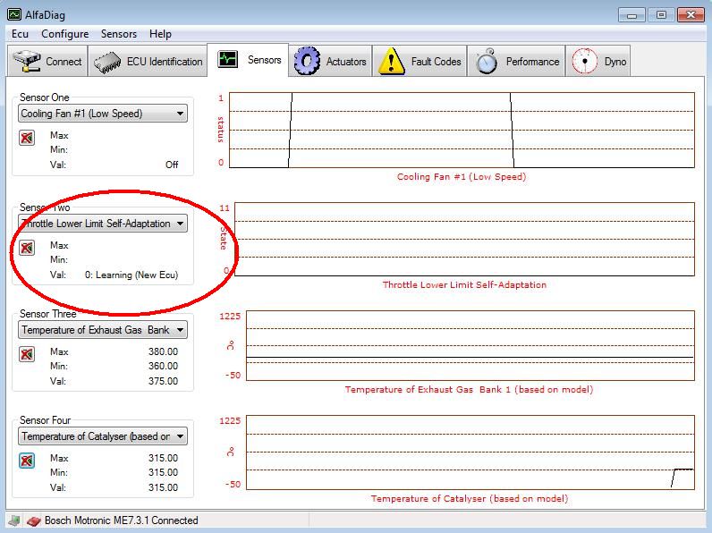

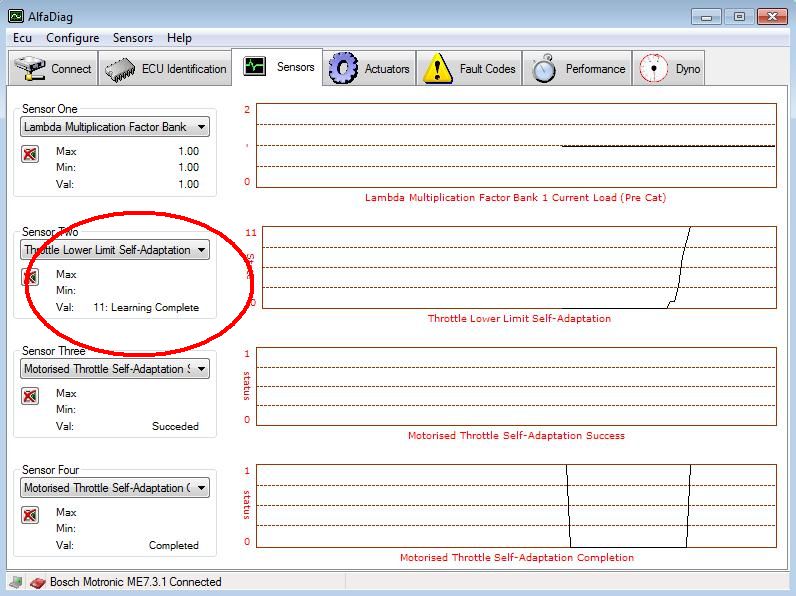

Re: Alfa Romeo 147 - reset Self Adaptation Parameters.
- check the status of parameters.
Throttle Lower Limit Self-Adaptation , VAL == 0: Learning
Throttle Lower Limit Self-Adaptation, Val == 11: Learning Complete.
