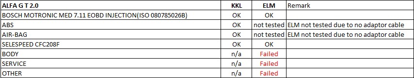

more testing result on v2.6.1. Tested Alfa Romeo GT and result as below. I can only test ELM327 without any modification of interface as I'm still waiting to modify pins.
- GT.jpg (35.88 KiB) Viewed 10807 times

Seems that your ELM interface cannot connect to CAN network. This is usually caused by electric problem in the interface.
There is a special thread about this issue:
viewtopic.php?f=5&t=1493

Hi Yani,
Thanks for the quick tips. That's very disappointing to me as I bought it from http://www.ecufix.com/shop/index.php?ma ... hhgfrfdv33 which is indicating genuine v1.4 and quite expensive. I'm expecting good interface for CAN but it let me down. Looks like i have to perform surgery on my cable and let you know what kind of PCB is inside.

Yes m8 your interface it is Chinese CAN issued genuine one.
All that kind of interface like yours have this problems. It is not hard to fix it, don't worry. And you don't need special skils for this.

Hi Yani,
I have confirmed my interface cable is the culprit by using another cheap ELM327 i bought which work like charm.
I will post my bad interface picture in other post. Thanks.
