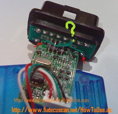

here's the problem, I can log on to abs, engine, but I can not log on "service" using "multiecuscan" with ELM327 1.5a on my fiat stilo jtd, 2002
So I scoured the forum and I found www multiecuscan.net howtouse. say it to weld the plug obd 1 7 9. I have to try, and now I can have access to the ABS. But when I look at the picture on the forum we can see that the welds are to "1" 7 "" 11 "??
Someone would have it the right connections or the pattern of obd fiat??

First of all the photo from above is showing the VAG interface!
This pin 11 that you think should be connected - IT IS NOT CONNECTED! It is just the angle of view! There is NO NEED to connect this pin 11 with other pins!!!
Second thing ELM 327 v1.5a is not in production yet! So your ELM v1.5a is probably fake ELM. It is probably version 1.2a! Please click on Settings>Interface Type> click ELM v.3+>click Test button! Compare your Test list info’s with one on this web site: viewtopic.php?f=5&t=1493 and this viewtopic.php?f=5&t=1540 and this viewtopic.php?f=5&t=1543!!!
In this subject you can find GOOD and BAD test info’s from different ELM 327 versions (v.1.2a, v.1.3a, v.1.4a & v.1.5a)!
