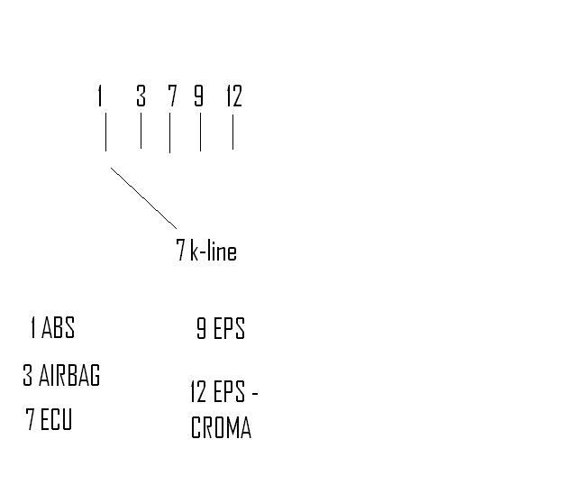

Hey guys, this is my first post and I want to solve a problem I have. First: I have a cable vagcom and want to make the modification of the pins 1,7,9 and 3. I understand the instructions that pins 1,7,9 have to make a bridge between them (in the photograph of the paguina see that the wires are bridged are the numbers 1,7,11), on the other side when I use the pin 3 with other pins must be connected, if the paguina on how to use it says do not connect to the pin 1,7,9. a greeting and have someone make me a sketch.

He said if someone ca do it a drawing with how to do the conection.Maybe he wants to say a schematic.
look in the attachament if this is what you need.

Hey guys, thanks for answering. I do not see the picture, I will ask the question otherwise have if the translator does it well. Pins 1,7,9 are connected together, which is what the manual says this site, but when you have to connect pin 3 disconnected pins 1,7,9 and connects at 3, but the pin 3 must be connected to another pin (1.2.3.4.5.6.7.8.9.10.11.12.13.14.15.16) which has that connects with?. greetings

Hey guys, thanks for answering. In in attachament of mattydr67 I think what I meant is that combinations of pins are as follows: (7.1). (7.3). (7.9) or (7.12). Please tell me if I understood correctly. Hos say this because I've ridden a contactor in 9 different remote control of a garage at the base of the cable, and I can make combinations of pins that I want. A greeting.

reparoyo wrote:Hey guys, thanks for answering. In in attachament of mattydr67 I think what I meant is that combinations of pins are as follows: (7.1). (7.3). (7.9) or (7.12). Please tell me if I understood correctly. Hos say this because I've ridden a contactor in 9 different remote control of a garage at the base of the cable, and I can make combinations of pins that I want. A greeting.
Correct.

On pin 7 comes the K-line
Cut of the connection between K-lin from PCB and the pin 7 from ODB II socket.
The conection must be between K-lin from PCB and pins 1,3,7,9,12
Like this;
K-line to 1 (ABS)
K-line to 3 (AirBag)
K-line to 7 ( Engine Ecu/Automatic gearbox)
k-line to 9 ( EPS - for Fiat)
K-line to 12 (EPS - Fiat Croma)
Well you can soldering together all that pins 1,7,9, 12 and 3 separate.
P.S. - I use a switch but i tried without switch with all pins soldering together. - Not problems at all - but take care I'm not recomanded that.
If you do like me with switch is ok but if soldering all together you are on your own.
