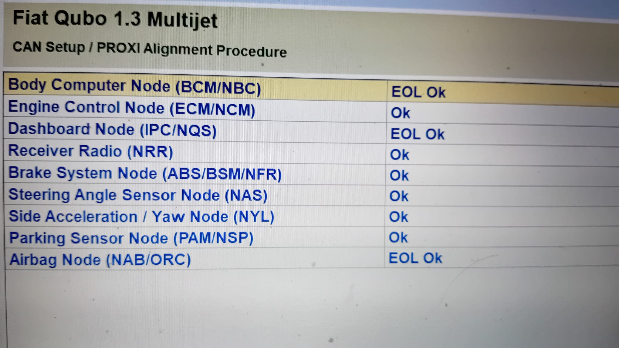

i had probleme with Blue&Me on fiat qubo 2012 1.3jtd
i have removed it
but now i have AIRBAG light on dash
when i diagnose the airbag i have not errores
i have changed airbag module
please help
proxy setup is finished ok
please any help....

scan whole car. maybe other module triggers airbag error.
