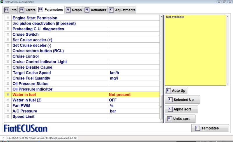

water in fuel sensor reduced.JPG (186.63 KiB) Viewed 820 times
When it says " Not present" for the" water in fuel" line on the parameter screen does this mean either
1. Water is not present in the fuel filter or
2. The sensor on the fuel [ diesel ] filter is not present or detected ?
Re: water in fuel filter sensor
It means:
However, if the sensor is disconnected or not present you will get the same message.
