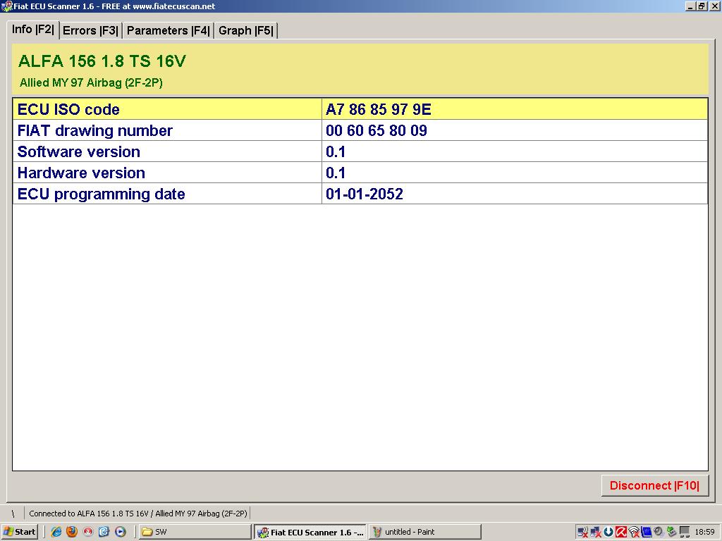

Hi ppl, I’m sorry for my bad English. I have an Alfa 156 1.8 TS 16V

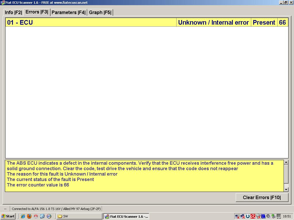

with airbag warning light on. This is the error
I need help to find the reason for the airbag fault. It connects fine, finds the culprit, but can't remove it

The ECU needs repair.
