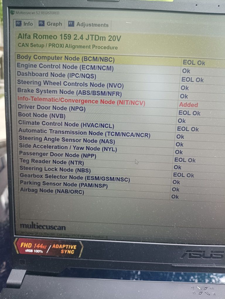

Does anybody know what is this. It appears from time to time and makes the milage meter to blink
INFO-TELEMATIC CONVERGENCE MODE NIT/NCV ADDED or missing (doesnot appear)
Can setup / Proxy alignment menu. In Ajustmunt this option i mising.

Maybe a loose connection for a gps antenna?

most likely dead Blue&Me module under the radio.

The car doesnot have Blue&Me.
GPS antena is OK.
I will check couplings

No fault codes? Or only the message at CAN Setup?

milage meter starts to blink. Nothing else.

then check main radio connector - maybe it's loose there.
thougth it was B&M module but looks like INFO-TELEMATIC CONVERGENCE MODE NIT/NCV is radio unit with screen.

No instaled B&M module
