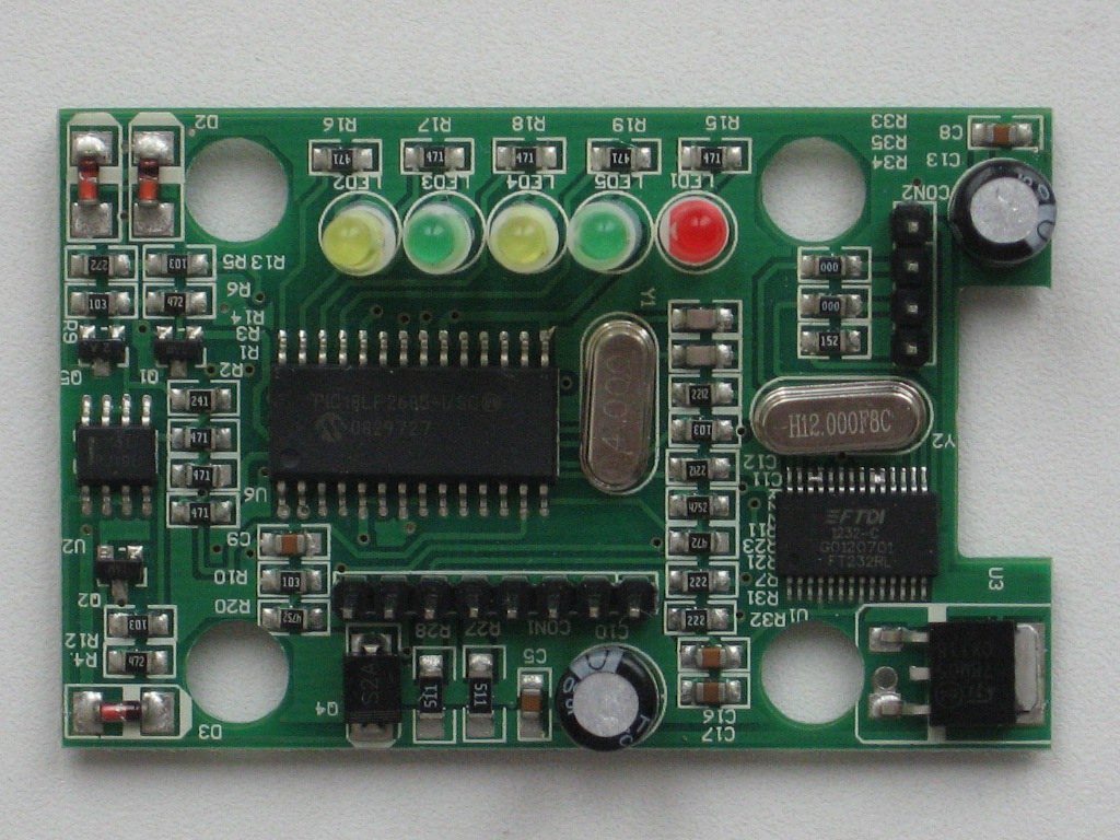

I read the oher topics, and my board is different of the others.
This is one image of the board of my interface:
download/file.php?id=970
I removed the resistor R4 with no results, now I put it back on the board..
After of it, I removed the resistor R2 (with value printed 121, marked red in this picture download/file.php?id=971), with no other result, only the Injection Module Detected..
Have a suggestion with this board? Because I'm losing hope this interface work.
If you not have further suggestion for this board, suggests some other model of ELM327 (with low price) to use the 2008 Fiat Punto 1.8 8v?
I will use with MultiEcuScan, so I prefer a USB interface ..
Thanks ..
Thanks ..
As you have correctly identified, which was removed from R4 wrong
Resistor R2 is to be removed
Do something, even a test of the signals under
MES / Settings / Interfaces / Test
And put the result here
Otherwise, I would also tap a setting error
or your interface was while desoldering and soldering of R4 destroyed!
These ELM no bridge resistor is installed!

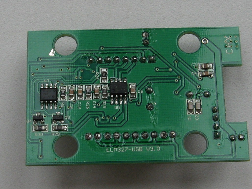

Hello!
I have PCB and problem as Scarab on page 82. However, I have one else thing. at the first time. When I connected a ELM and started MES the arrows
on dashboard falled down. Now, when I connect ELM the arrows falling down and I can check only engine. Can you help me?
P.S. I have Fiat Doblo Cargo type 223 1,9 Mjet.
A lot of thanks
A lot of thanks

Hello vmaci
Just as with the response from Scarab is your connection error also
not at the bridge resistor (120 ohms)
I suspect that your driver is not the correct driver.
Otherwise, it can only be connected to setting errors.
Your problem is not the resistor
