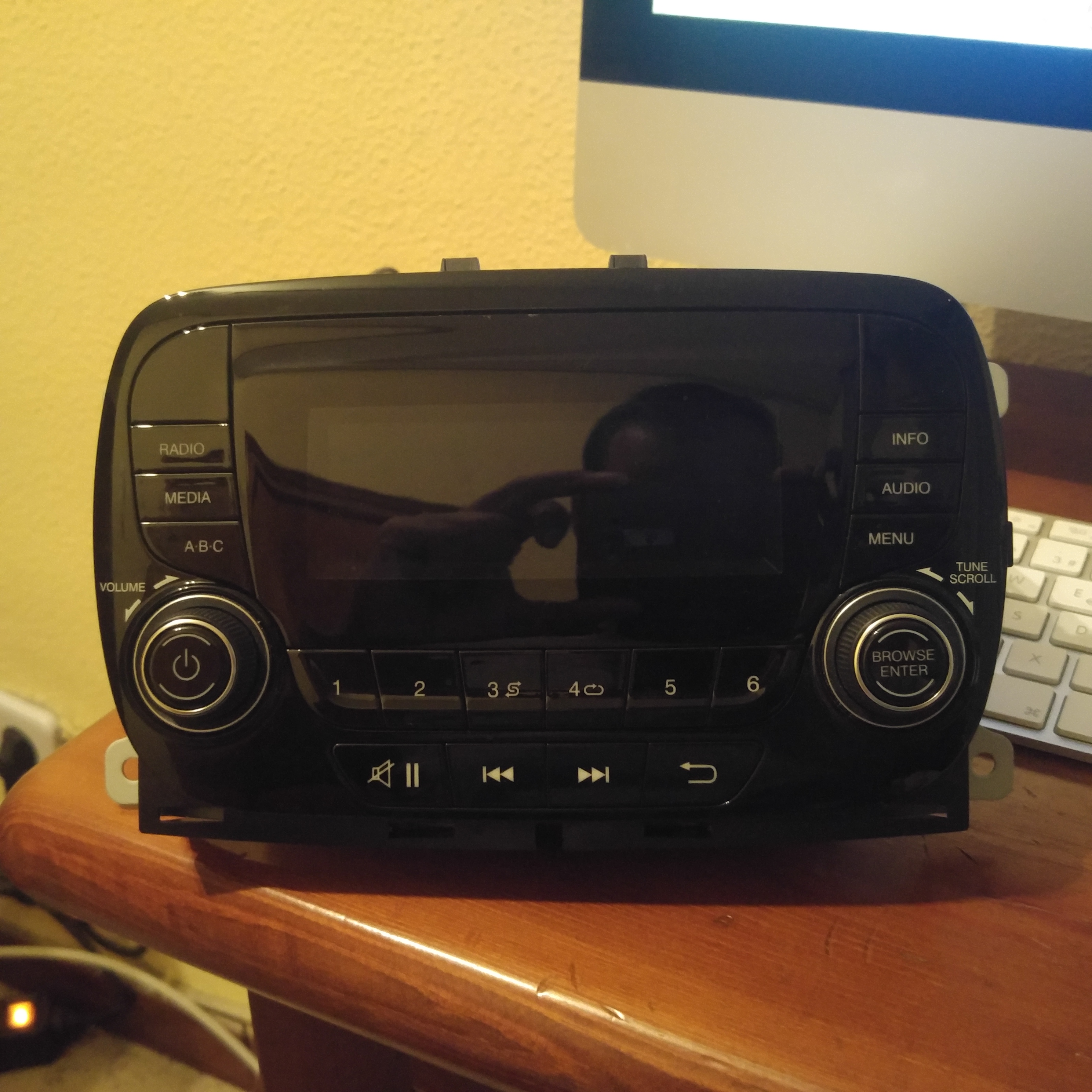

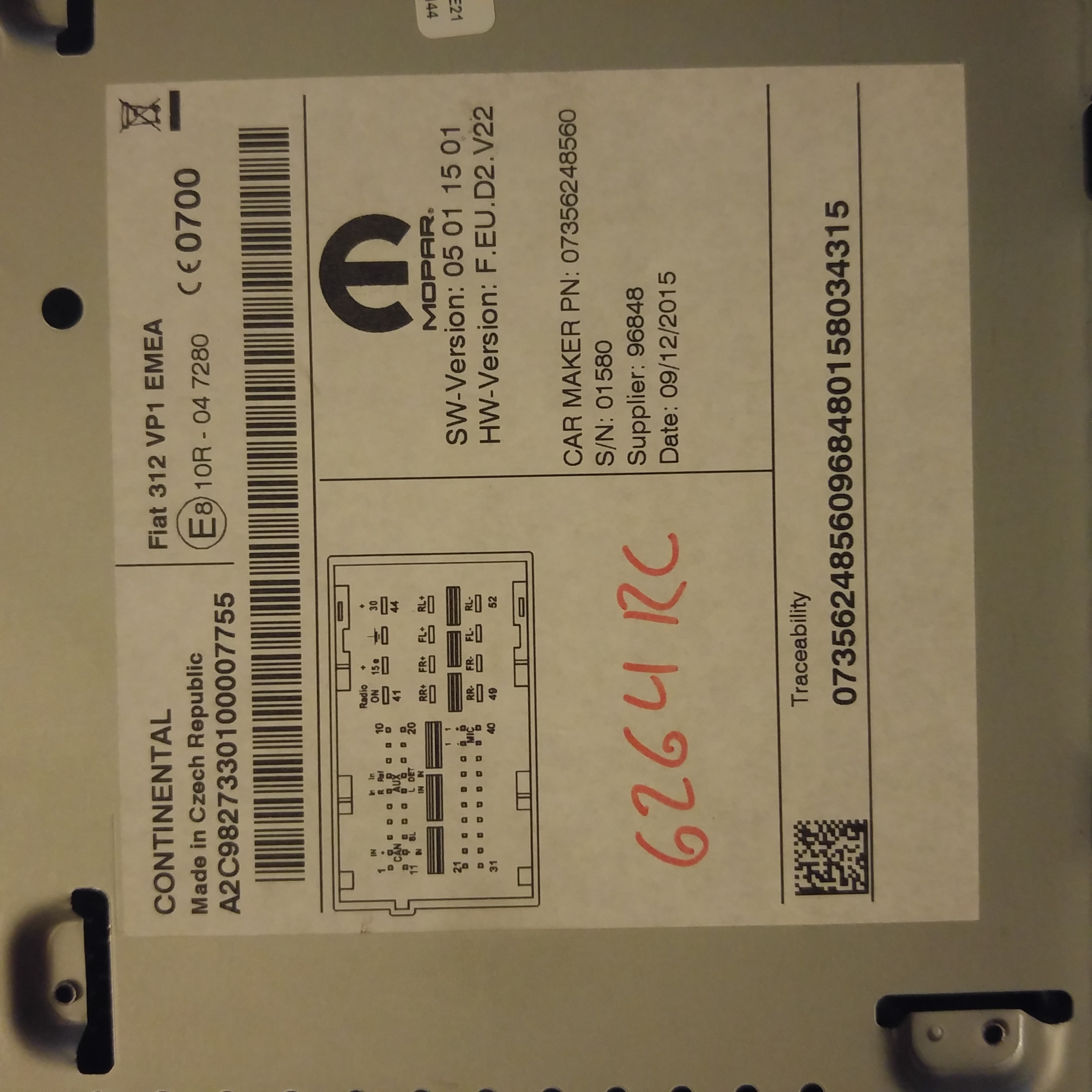

hi to all,
i will like to know if its posible to activate the missing functions with this model of radio?
alex-et3
Posts: 199
Joined: 19 Apr 2017, 22:42
Location: ROVIGO - Italy
Re: Missing menus from TFT display - Abarth 500
Post by alex-et3 »
Hi!no,only with uconnect 5 or 7hd
