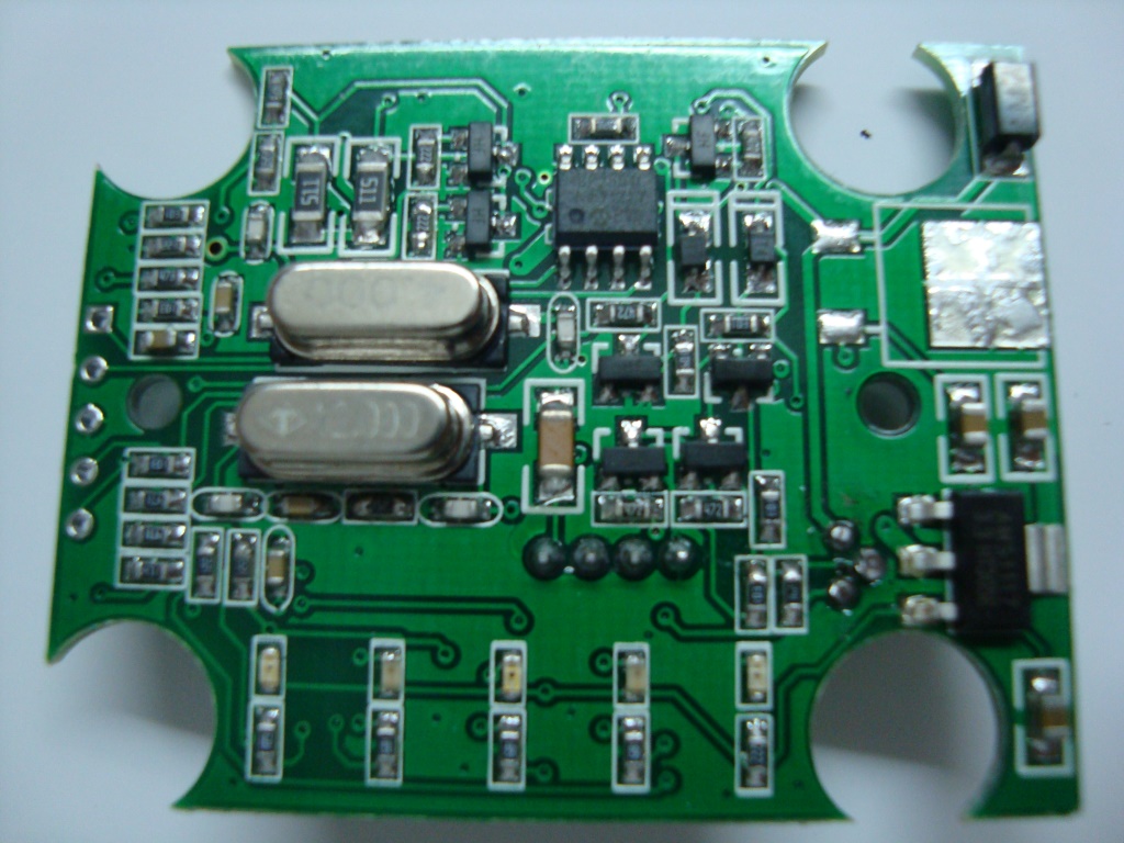

Hi guys, can someone take a look at this ELM327 circuit?
All the tests say OK but i cannot connect to my FIAT.
The two resistors on the right look like the ones. can you please confirm?
knightrider
Joined: 27 Jul 2013, 13:33
Post by knightrider »
Ok i found a circuit similar to mine here: [link]viewtopic.php?f=5&t=1493&start=750#p12434[/link] and figured the resistor that need to be removed.
Thanks,
KR

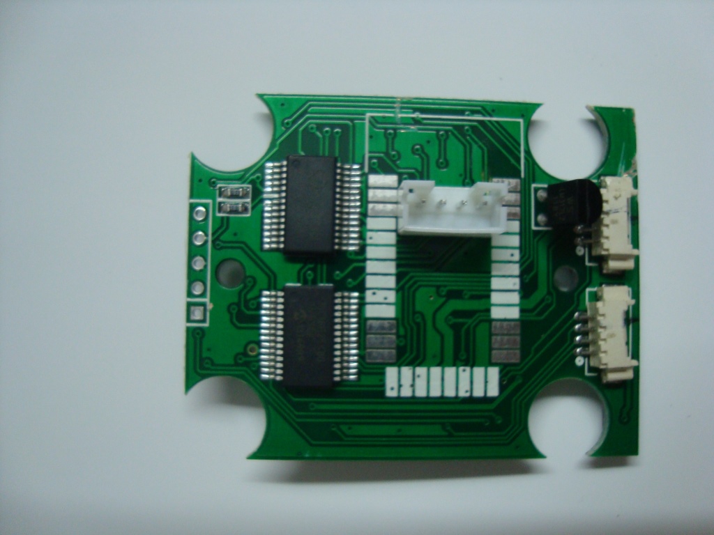

Hello aaa456
I understood your post so that you without the adapter A3
can connect to the controllers??
Only with A3 adapter you have no connection?
Have I Got it wrong? :oops:
Then it will probably be the problem with the Resistor Bridges
So the ELM open and here to See which component it is.
Otherwise, just give me the pictures and I'll select this resistor
