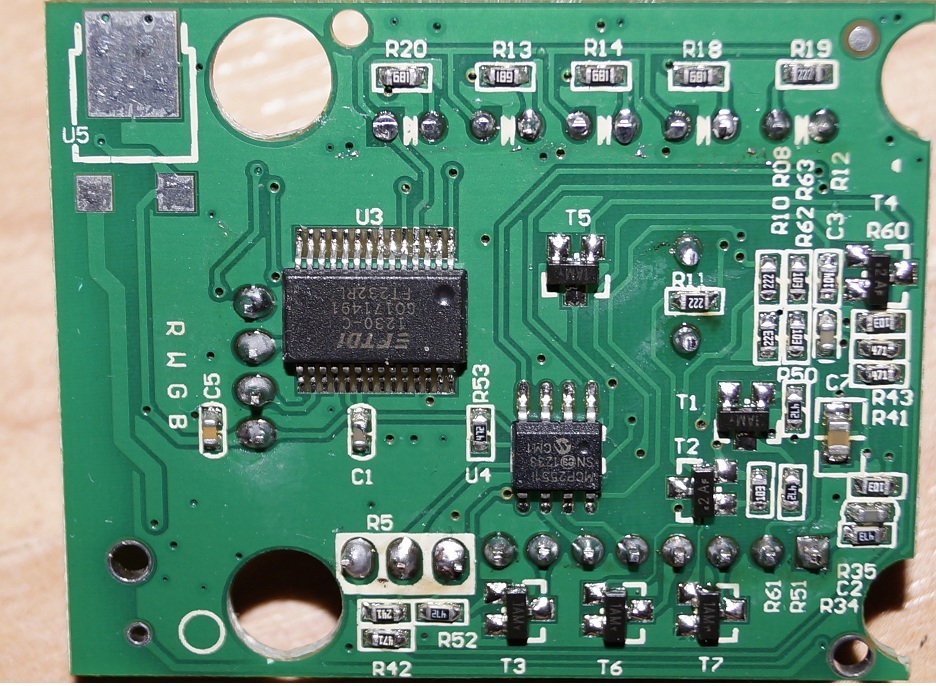

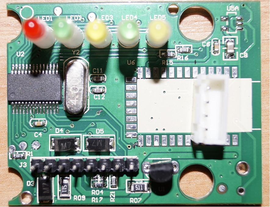

Hi. I just bought this pice of crap. I have a Fiat Stilo 1.9 JTD from 2002. When i connect the elm 327 (at least so it wrights on the case) i get LOOSE CONNECTION on the computer board..and the lights are going on..i can connect to the ENGINE and there on the errors tab i can see that it says the interface don't comunicate on the CAN -bus..i opend then the interface to remove the R04 resistor and surprise..the resistor is alreadey removed...
...so what can i do to connect to service..somethings is wrong but what?..it shouldn't say LOOSE CONNECTION when i plug the interface...pffff...i'm so upset..

Can it be that when removing the resistance to soldering there is a direct connection?
So the contacts are not isolated?
Otherwise, your interface will be broken. Sorry
