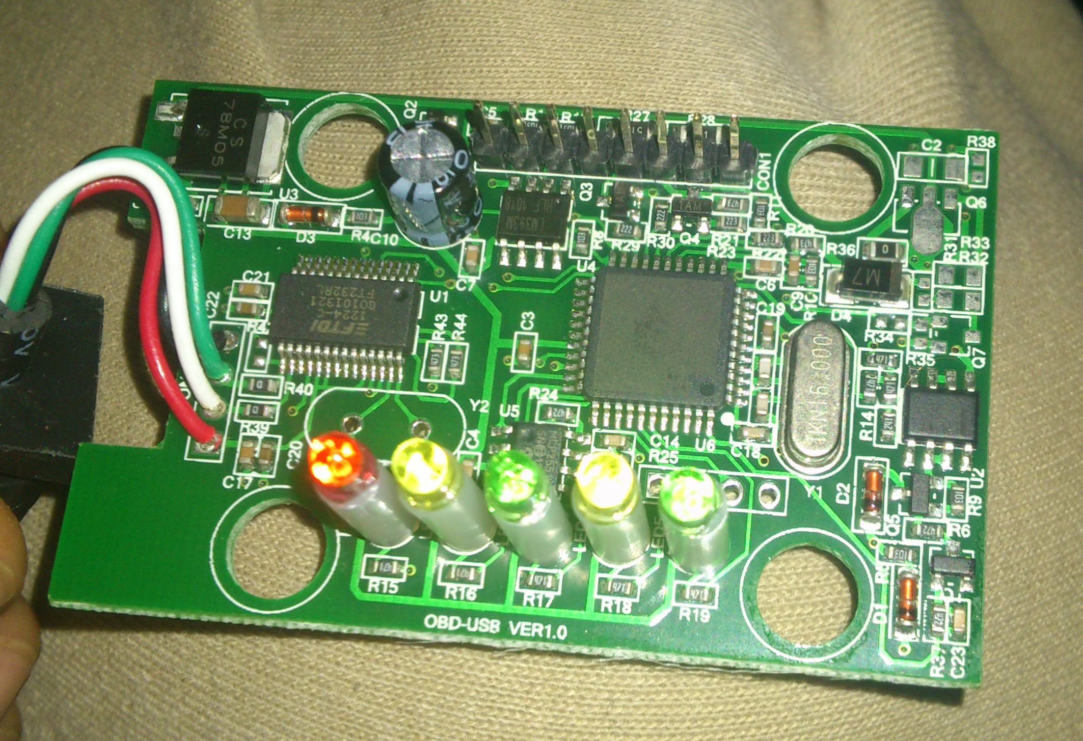

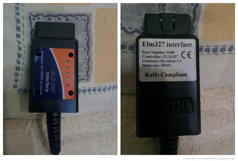

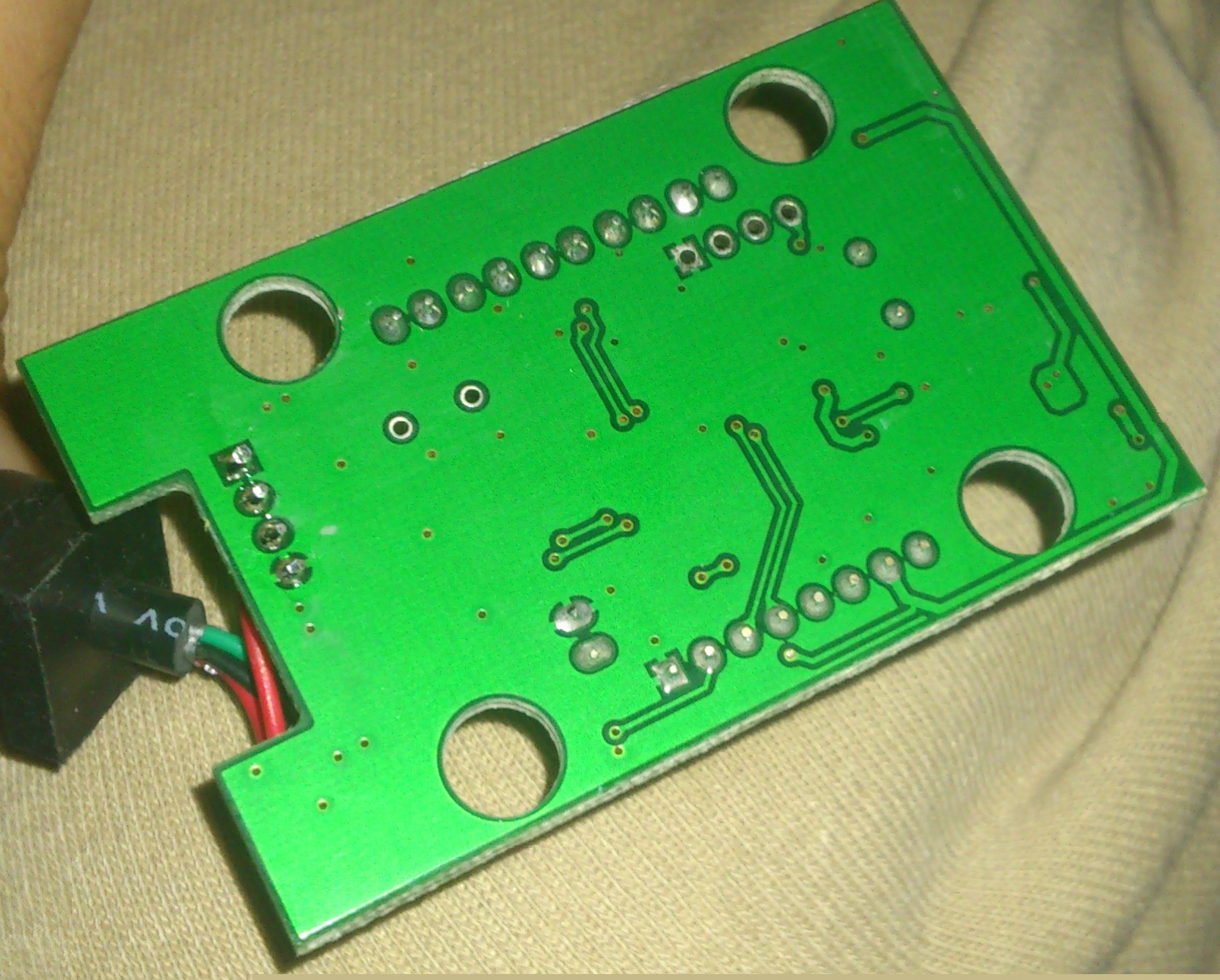

I have an ELM327 adapter with USB cable taken 2 weeks ago from www.amazon.de as shown layouts in 5 pictures provided as attachments.
As owner of: "Fiat Croma 2.4JTD with DPF, year:2005" wanted to use/test free edition of EcuScan but unfortunately is not working saying that:
"CONNECTION FAILED, ELM327 -> ECU Connection Failed ! Check your cable and serial port settings"
I searched this forum posts for this topic and I believe that from your experience I will get solution.
I have been installed software for Virtual COM port (VCP) drivers on Windows XP with following settings:
Bits per second: 38.400 with latency = 1, also set 38.400 bauds with latency 16, the results is same.
When I use "TEST" button with reply for all commands=OK ELM327 v1.5 and at the end the output log says:
"This interface is compatible with ELM 327 1.4! Should connect properly with all CAN modules"
When I use "SCAN" button I found error such that:
Errors found: U1602 - CAN Data Bus
As a feedback, what I realized from previous posts, my PCB circuit layout label is quite different with label: "OBD-USB vers1.0" but not as yours: "ELM327-USB". Is this a problem or is a standard problem solution with circuit resistors, capacity etc ? Or any other correct settings on EcuScan or USB-Serial driver ? What should I modify correct on PCB layout or SW settings ?
I will be very appreciate for any help from you to get a solution.
Regards.

Hello Stefan
Can connect to the ECU your Croma you should without any modifications.
The problem is that with some Multiecuscan ELM interface affects only the CAN Bus Protocol
and the ECU with your Croma is read with KWP2000 not CAN Bus
I do not think your settings are correct! ?
Which driver do you have installed?
Your picture is bad, you would have to do from the other side, so you can hardly see anything. Or directly from above
So you can hardly see anything, the importance of the bus bar and the chip MCP2551 has seen
