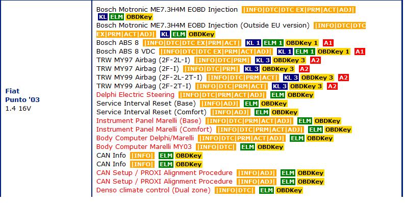

my can is fiat punto 2004 16V
Hello Stapy
This example here ?
Then you should see that you need a bag for the KKL interface and the corresponding Adapter2
We needed for steering the ELM without an adapter but I can not say whether this mini ELM 327, CAN can read with MES.
I have to check yet
To come to your ABS you need a KKL or ELM and adapter 1

first i thank you for your replay, i bought those 2 and all i got from scan DTC is Bosch engine, i have read that there is a modification should be made, so if any pls advise
like removing R4
Hello Stapy
The ELM has no resistor R4, whether it can read CAN bus must
I still test
I was sorry not to :-)

hi Eddy
so why it can not detect the power steering or ABS, it only detect the engine
what about VAG-KKL? should i remove R4 from this 1 ?
Hello Stapy
Have you used the ABS connection, an adapter cable?
Without modified interface or an adapter cable 1 you can not establish a connection ABS.
The steering is read via CAN! This does not require adapter cable is required.
You can not connect to it for CAN info or CAN setup ?

hey Eddy
no i can not connect to it for CAN ... i receive and error U1602

Eddy,
i bought those 2 interfaces without any adapters, so what i can do to access to power steering and air bag ?
