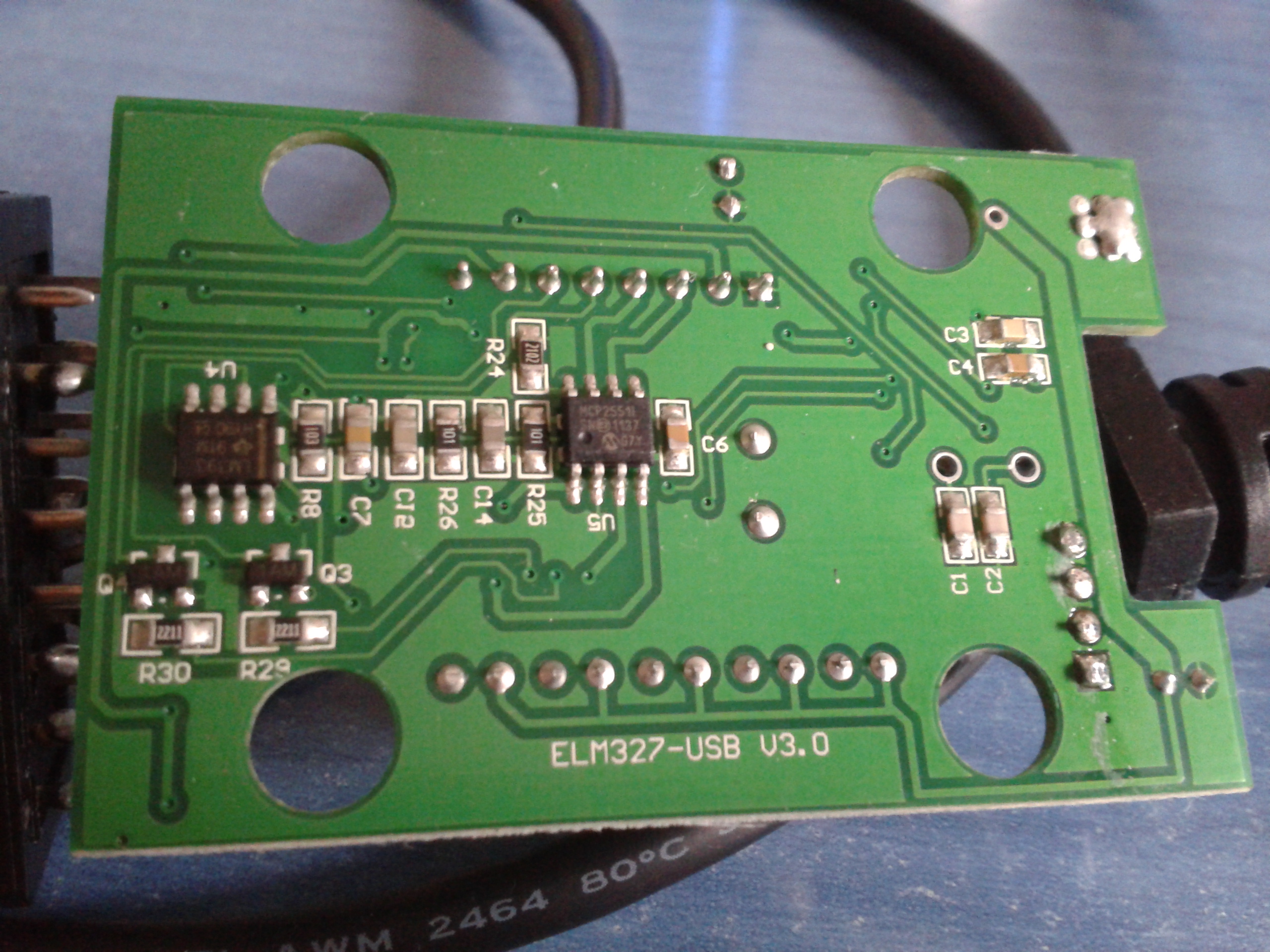

lutxana1964 wrote:Hi, This is my ELM327, do you think that i hate to removed the R04 ?.
Best regards.
hello mr alfa i have this bleutoot dongel can u tel me were to find r04??? tnx bace1978
bace1978
Joined: 27 Nov 2012, 01:05
Post by bace1978 »
hello mr alfa i have the same bleutoot dongel as lutxana1964 witch risistor do i need to remove o only can find r4 or r14 r04 is not dare any suggestions?
tnxs best regards bace1978
Hello bace1978
This ELM interface has no problem resistor R04!
Which ECU you want to connect?
Because the resistor R04 may only affects a CAN bus connection
no other

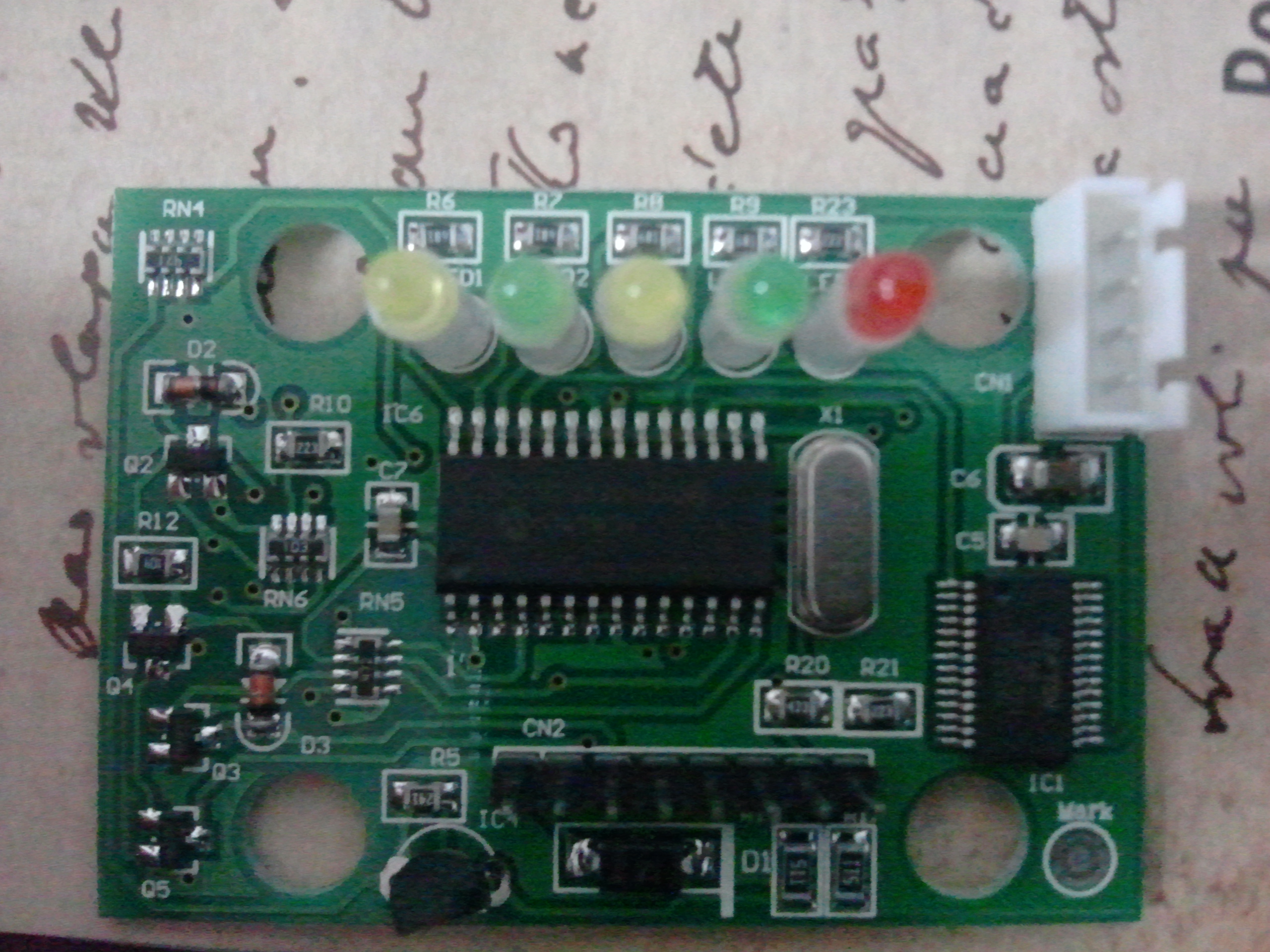

Greetings to all members can somebody please give a solution to this elm My ELM327 works great with engine but i can't connect to the CAN bus used on alfa 147 1.6 ts
2012-12-03 14.52.24.jpg (1.44 MiB) Viewed 8193 times
2012-12-03 14.51.34.jpg (1.23 MiB) Viewed 8193 times
stefic
Joined: 03 Dec 2012, 23:42
Post by stefic »
any help would be welcome !!!! which resistor should remove i cant find r04 or r14
Hi Stefic
The way I see it is your interface not this resistor R04 or R14
Normal should be able to read your interface CAN bus.
Please turn again a more accurate picture of the black Header
I can not really see if there is not yet a resistor.

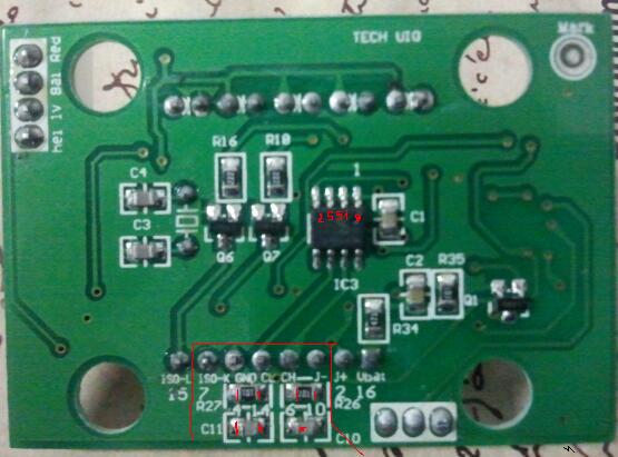

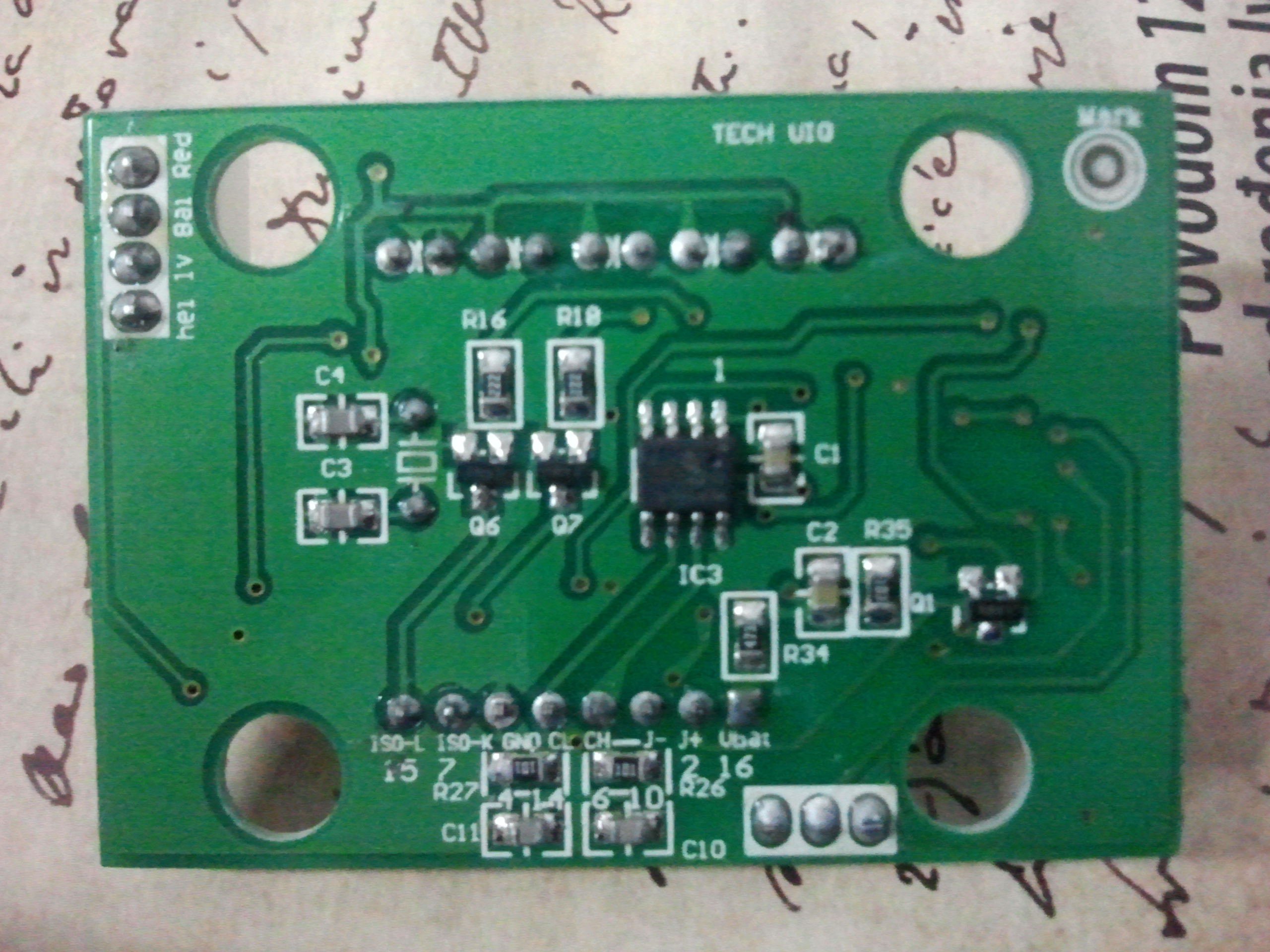

thanks for the reply alfaeddy !!!! Front side of my elm is the same as yincar on page 5 but rear is different you see on pics i have 4 resistor c10 c11 r26 r27
Hello Stefic
Normally, your interface to work in this type also in the CAN bus. In your red frame 2 resistors and 2 capacitors, these are also on the original schematic of ELM Elektronics, so I do not think of an error of these components.
If you find any other solution, you can still try and remove R26 and R27 for the 4 components are not actually required.
It would be an attempt

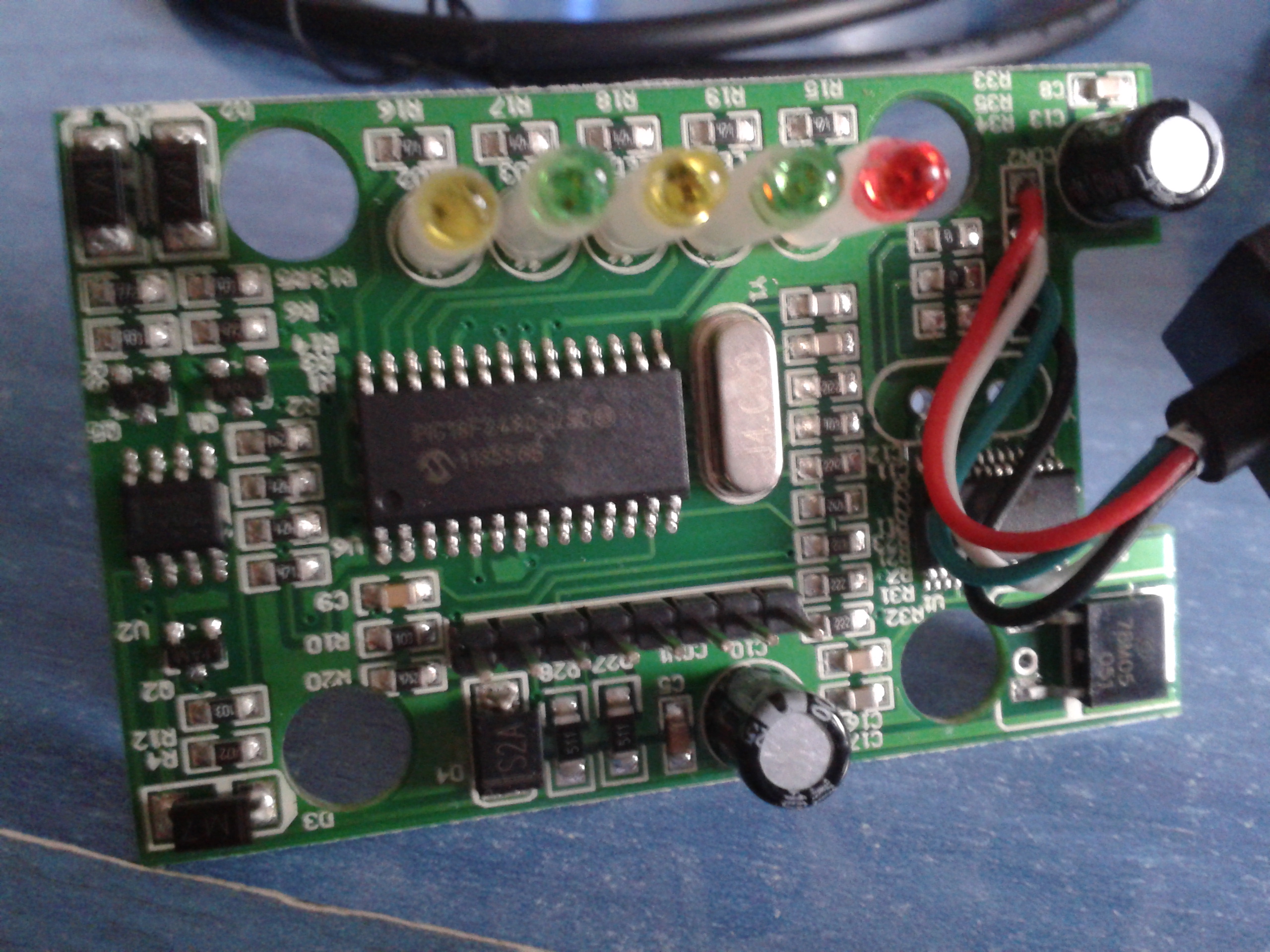

I recently bought a ELM327, but I can not connect to the engine ecu fiat brava 1.9JTD 105hp. FES with all correct test. but still will not let me. I do not know if it configuration problem or the cable.
the cable is this.
greetings and thanks for everything
