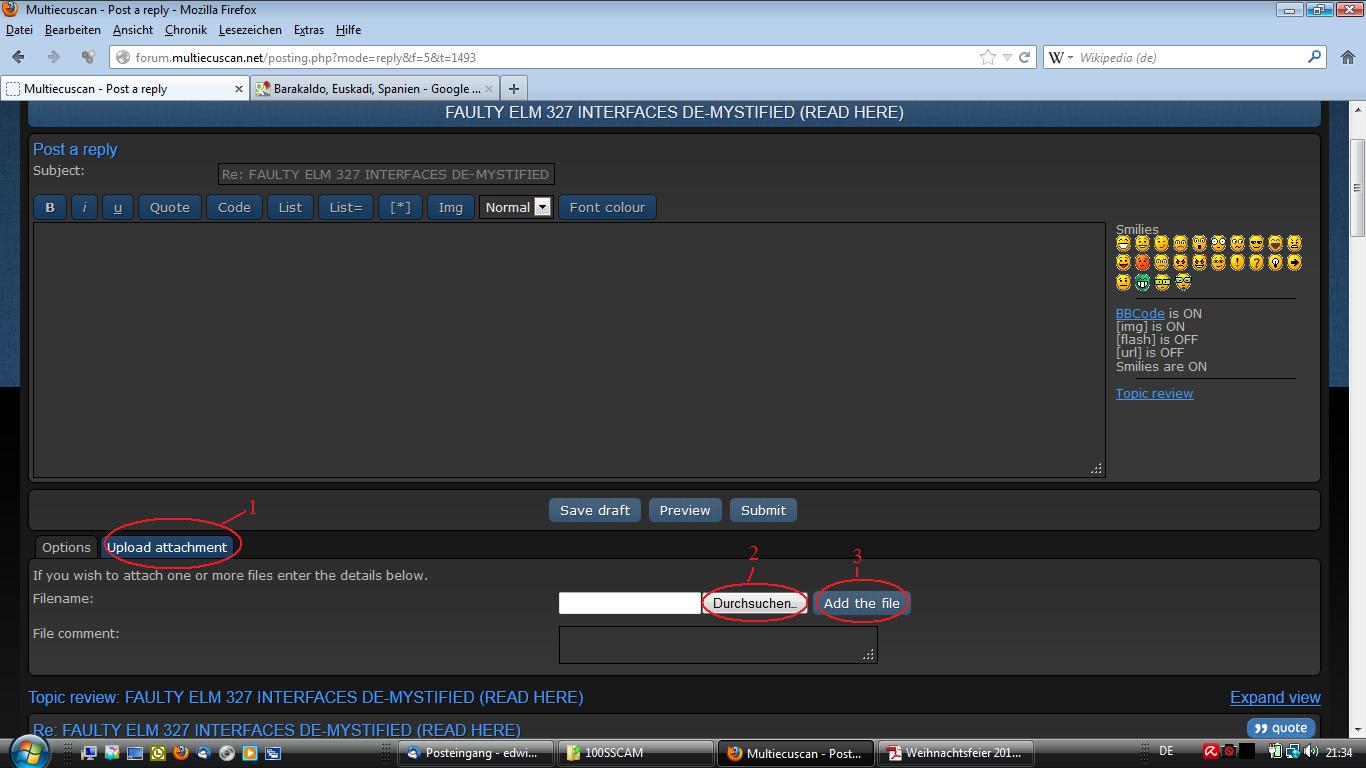

can you say like upload an image.
I liked the order to insert a picture
Have you installed an app for your ELM interface FTDI drivers?
Upload attachmend.jpg (114.29 KiB) Viewed 8212 times

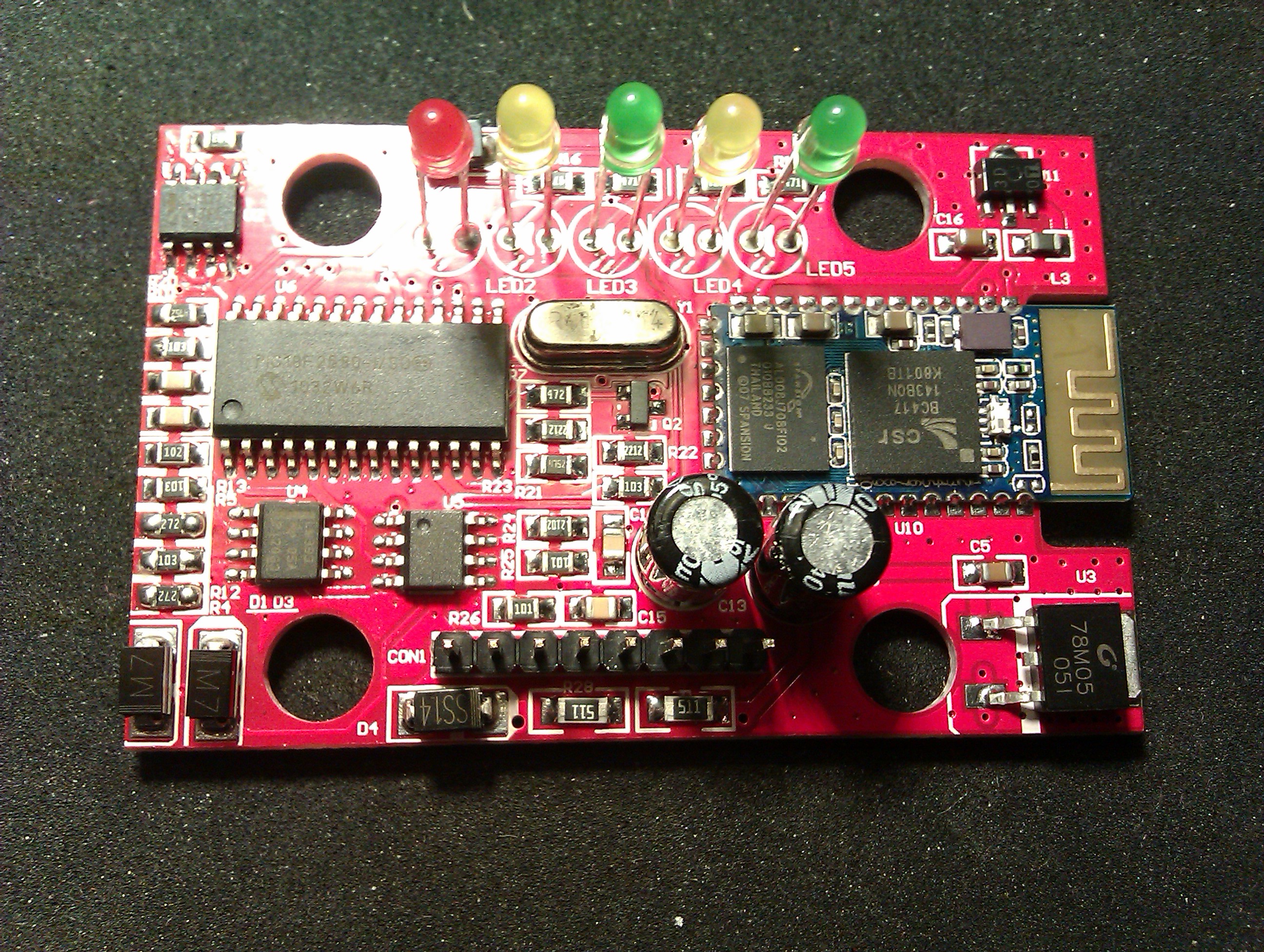

Hi, This is my ELM327, do you think that i hate to removed the R04 ?.
Best regards.
Hello Lutxana1964
The problem of resistor is often described here is relevant only Multiecuscan, I have not heard of the other diagnostic software have problems with.
Otherwise, it is a different problem
Furthermore, this problem is not to find resistor to your ELM interface.
And the red LED will only show that the interface is receiving power.
the other LEDs flash only when transferring data
Sorry I can not help you.
