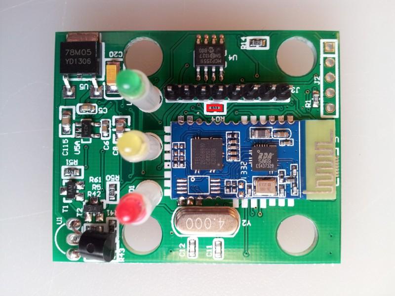

Hello Soul Reaver
The resistor in the red Frame must you removed
d272b0cab2a2902c0621a25ee1de6934 markiert.jpg (68.55 KiB) Viewed 10596 times

Re: Elm 327 v.1.5 (V Gate Bluetooth) Connect problem
Post by Soul Reaver »
Thank you very much. I will try and report.
Hi.
I removed the resistor and tried again, but I can't connect.
I think that there's another problem... when i click "connect" in mes, after few seconds it tells me that it cannot reach target network destination.
Setups looks ok to me, I selected ELM 1-3+ bluetooth, port 20, speed 33xxx.
In windows in bluetooth devices I see OBD II device, and in properties it's set on com 20.
I also tried to instal "CDM 2.08.30 WHQL Certified" drivers.
What am I missing?
Thanks.
