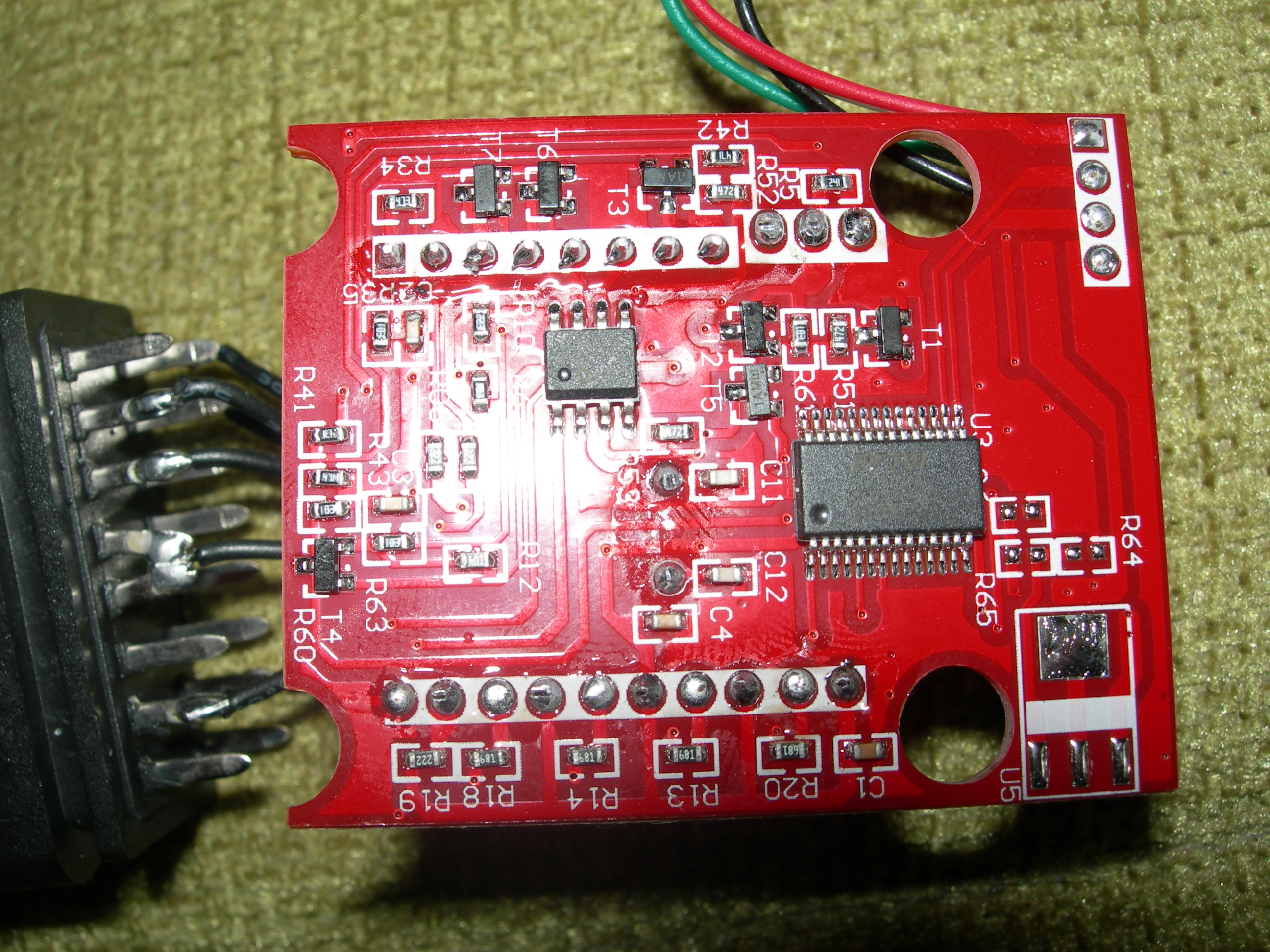

The reading of the data is very time critical, and the resistance between the two
CAN Cables changes time
Why this interface with other software but do not function with Multiecuscan (multiecuscan), I can not say exactly.
Anyway, the poor resistance R04 still present on your board.
The yellow circle sits the R04
DSCN6958 markiert.jpg (464.61 KiB) Viewed 9457 times

Alfaeddy wrote:Hello
grazie Alfaeddy la reistenza è eliminata ma il problema non credo sia quello.
si può provare a fare la modifica di Yani cambiando le altre resistenze o forse è un problema del chip?

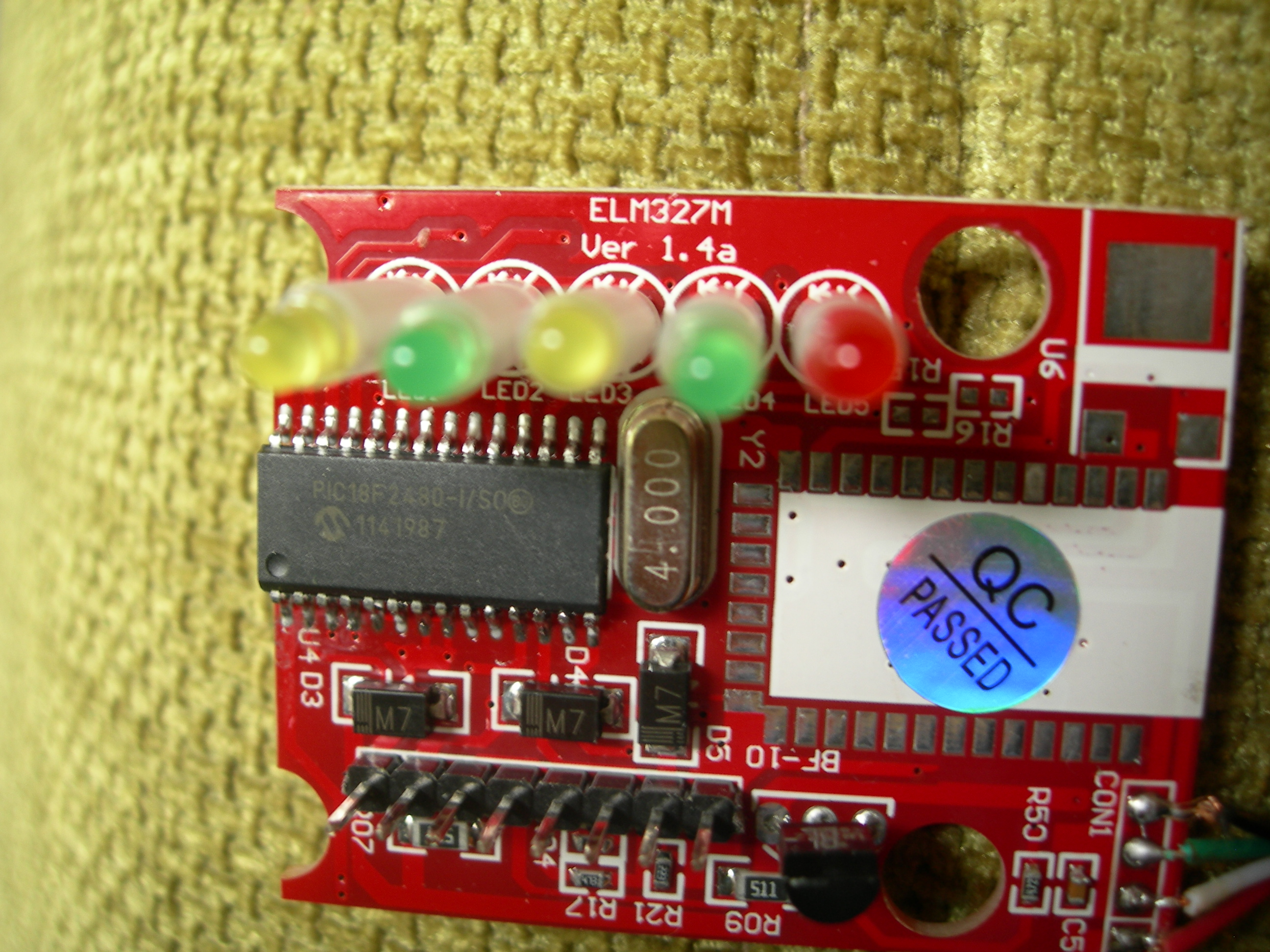

Hi I have the red version is
R04 removed
removed r14
CANbus network can not see does not work.
What is the solution can anyone answer?
Krg
Joined: 10 Aug 2012, 15:56
Post by Krg »
I think if you remove R04, you must add the sets R32/R33 C8/C9
stilo1.6
Posts: 12
Joined: 16 Aug 2012, 12:02
Post by stilo1.6 »
Krg wrote:I think if you remove R04, you must add the sets R32/R33 C8/C9
Thank you very much KRG but unfortunately I can not be connected from the image. Can you help me because they are not in the same box. Mine v1.4
