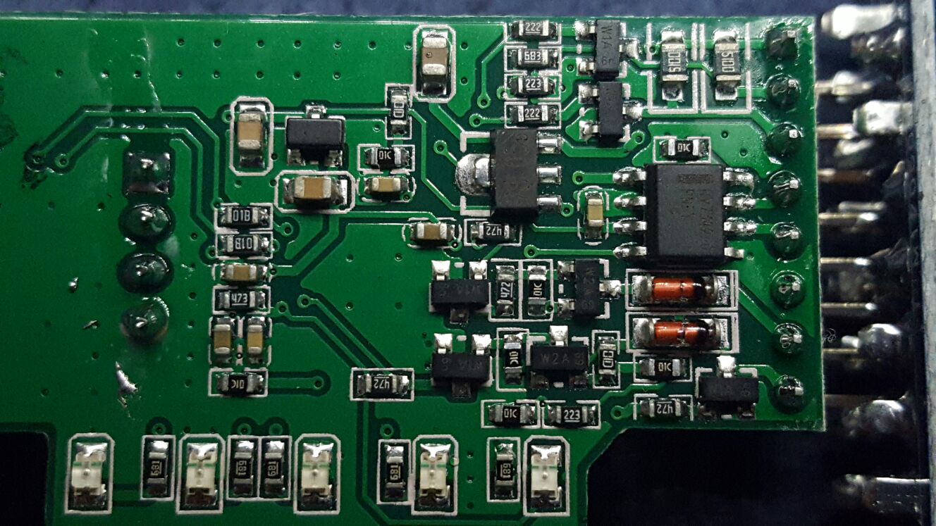

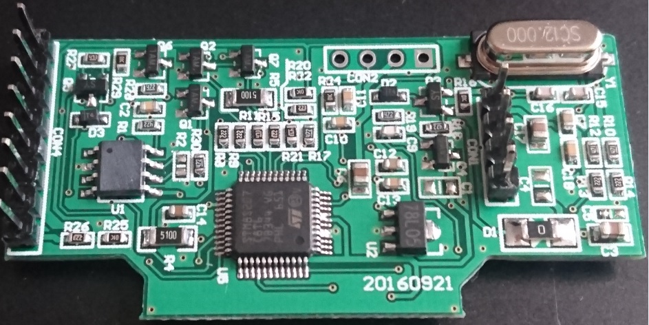

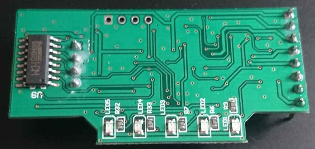

Hi guys, i my elm is wifi from the type that i attached. Everything worked great...kline, CAN, but now, something wrong and CAN communication not work. If you have some tips to make it work again, i will be very grateful?
Best regards

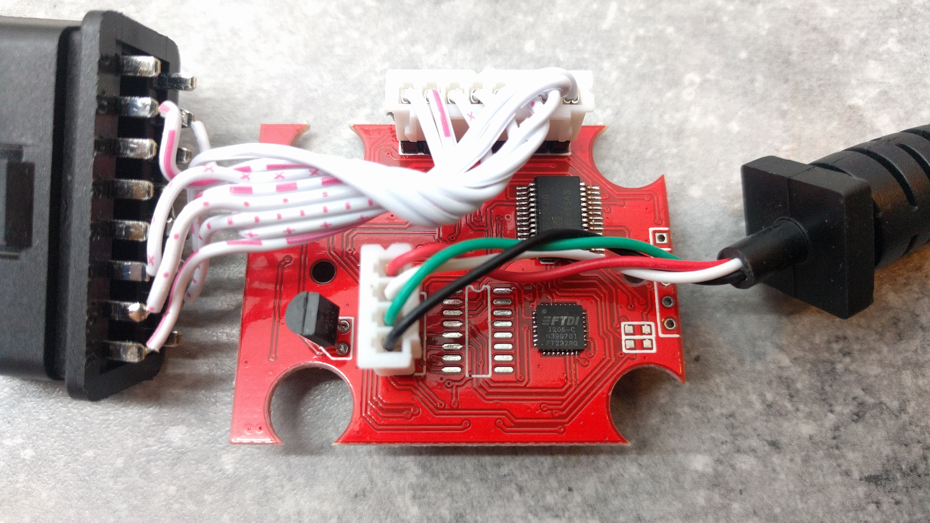

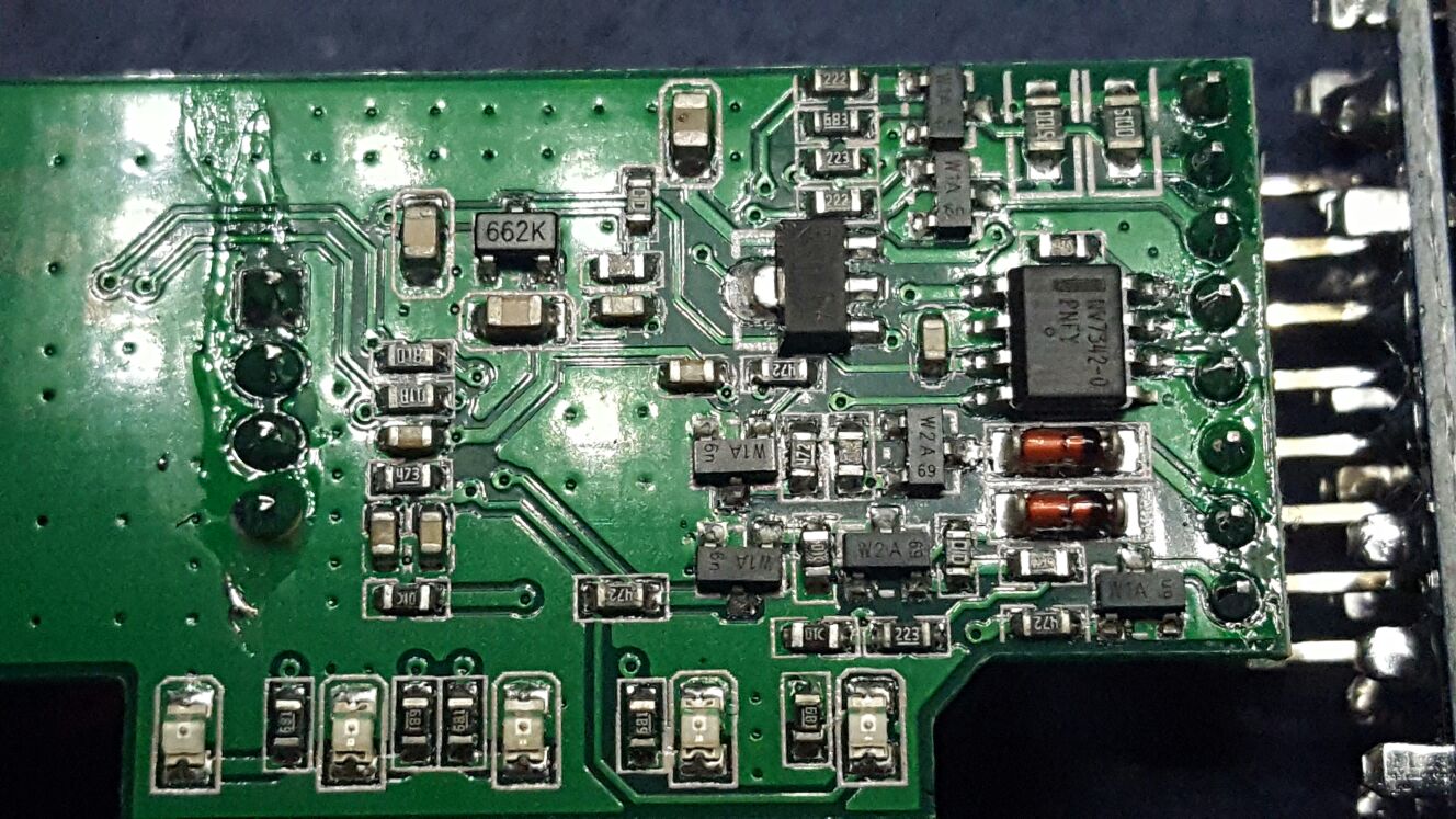

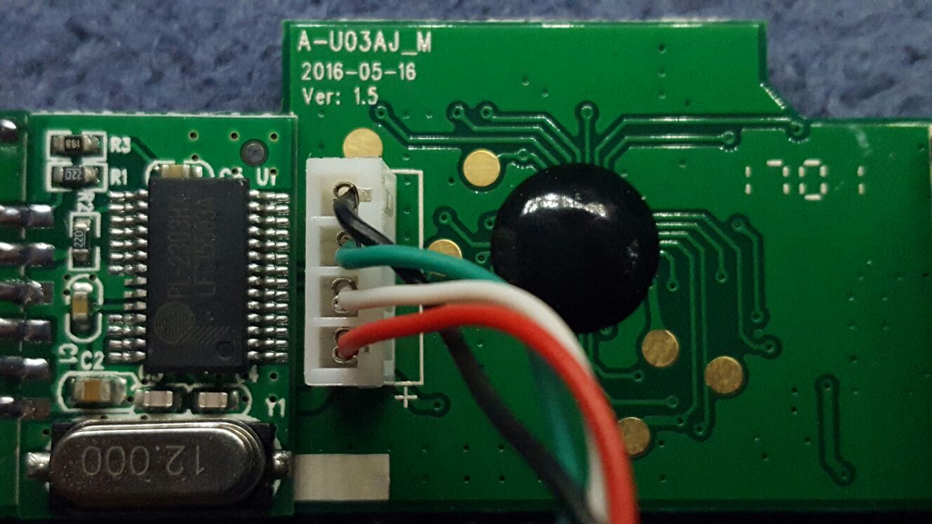

I have an elm327 usb 1.5 which i got from fleabay.
I have searched throught this post to see if anyone has the same and there is one but it differs from mine in that my board comes away completely from the unit.
Board - Back, LEDs
Board - Back, LEDs
Board - Main R2 (121) removed
1.5 Elm327
1.5 Elm327
I have full version of FES 3.6.2 and i would like to reset the service indicator on my 2007 159 1.9JTDM as i now service it myself. Is it possible with the unit i have? I have already removed the R2 (121) resistor? I am having connection problems i.e. ATZ timeout etc which i will resolve, but just wanted to know if the unit i have will do the job i need.
I have attached images of the unit i have

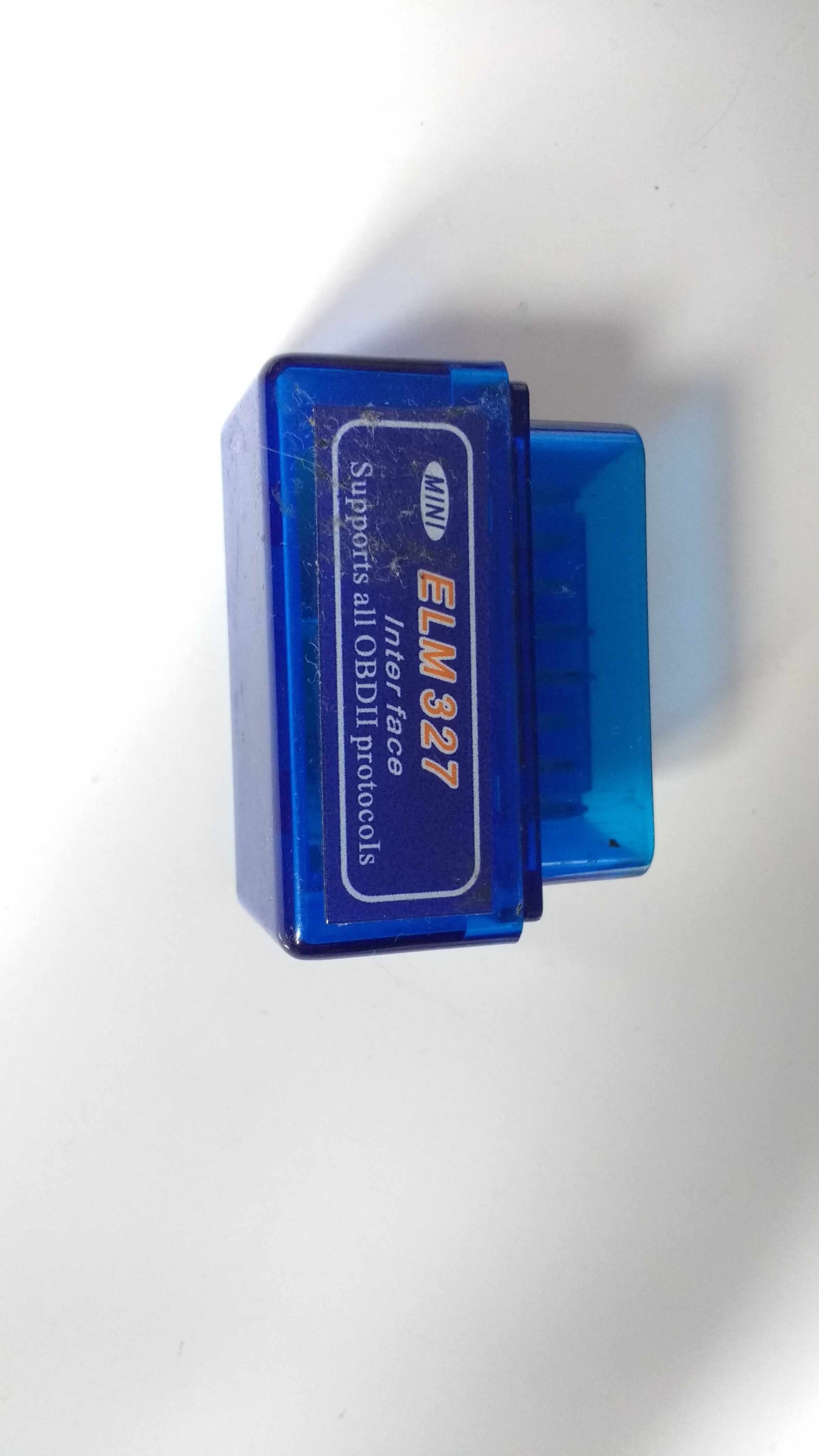

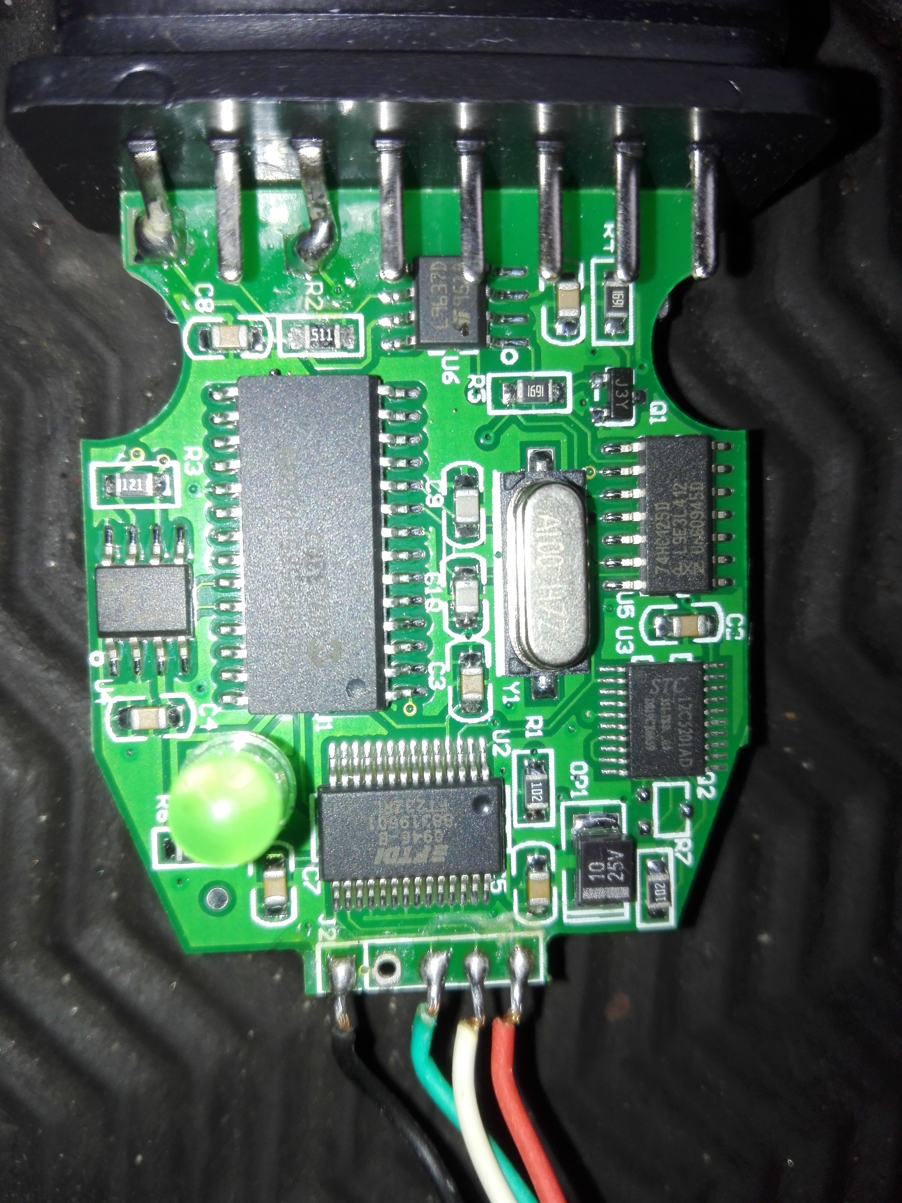

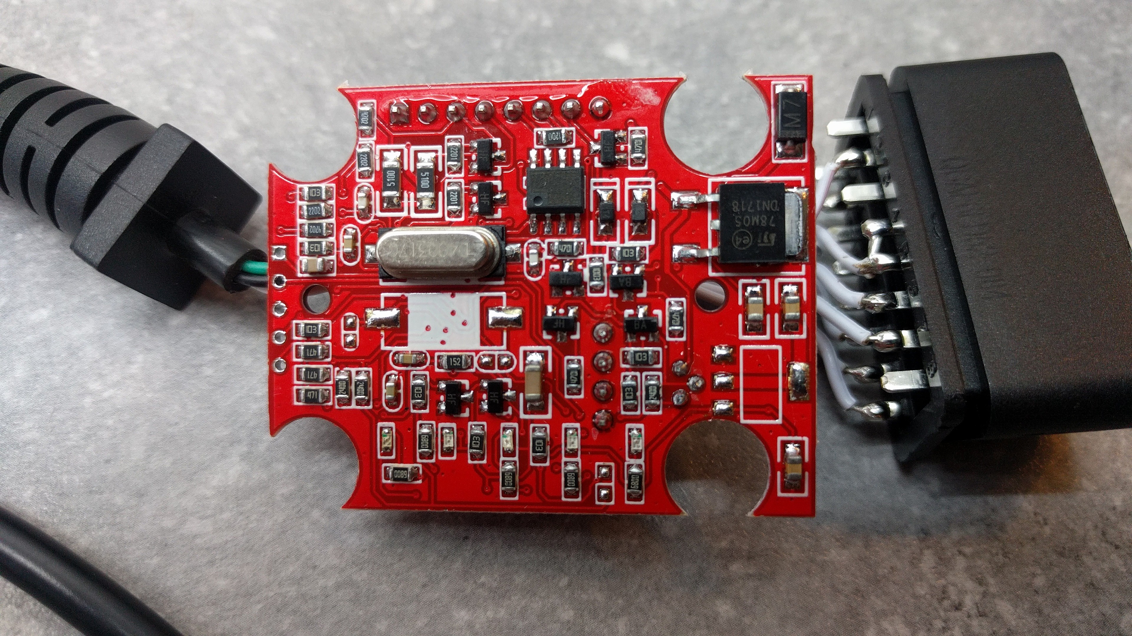

Hi all. I bought this interface and i want to know which resistor and capacitor should be removed to work properly with FiatMultiecuscan. I think the R3 121 ohm must be replaced, but I'm not sure. Thanks for help.

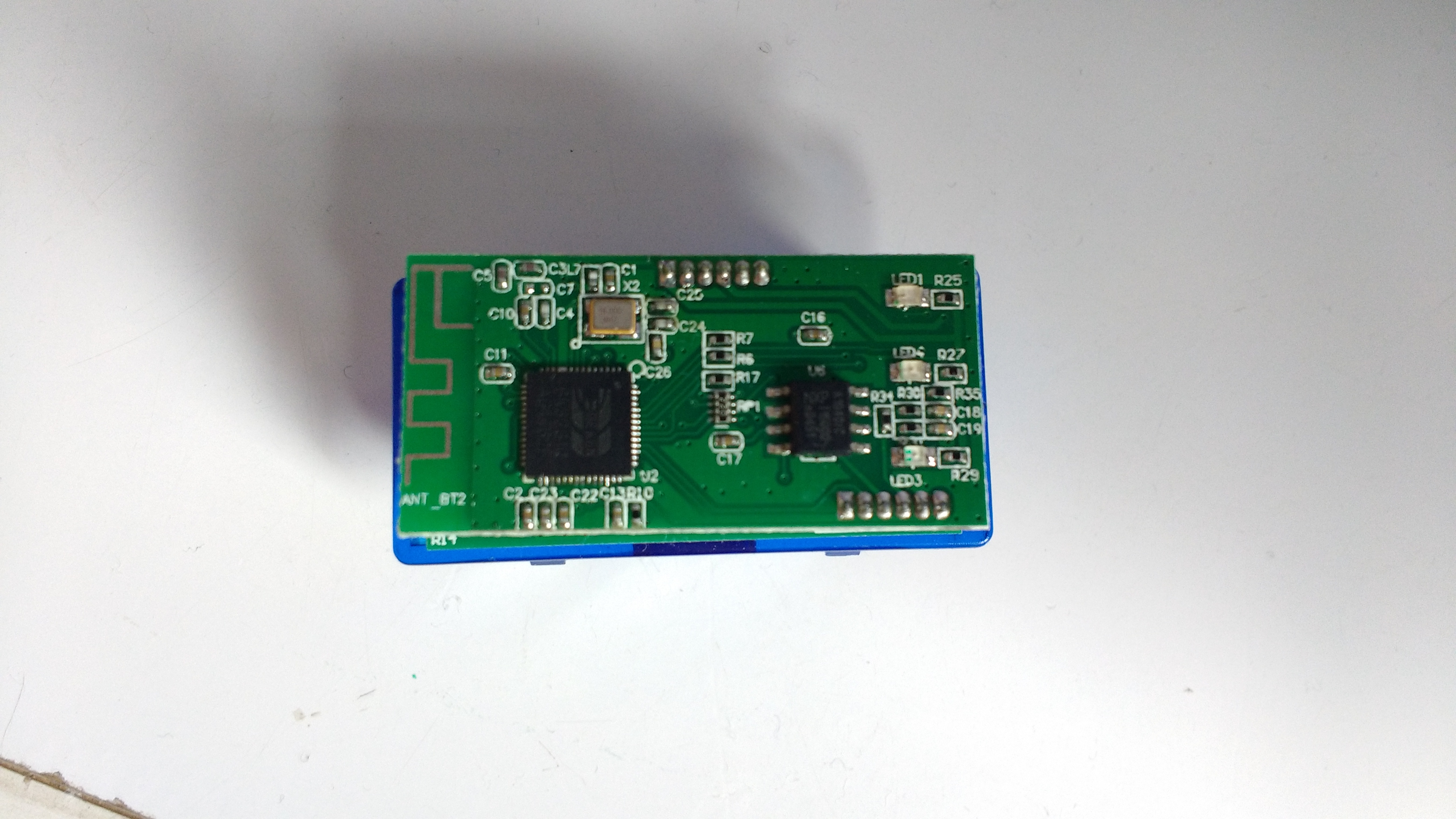

Hi friends.
Need help.
I have ELM327 mini and I have no network access to can.
Look at the photos.
Do I need to remove a resistor?
What?
Can you post the photos, please?

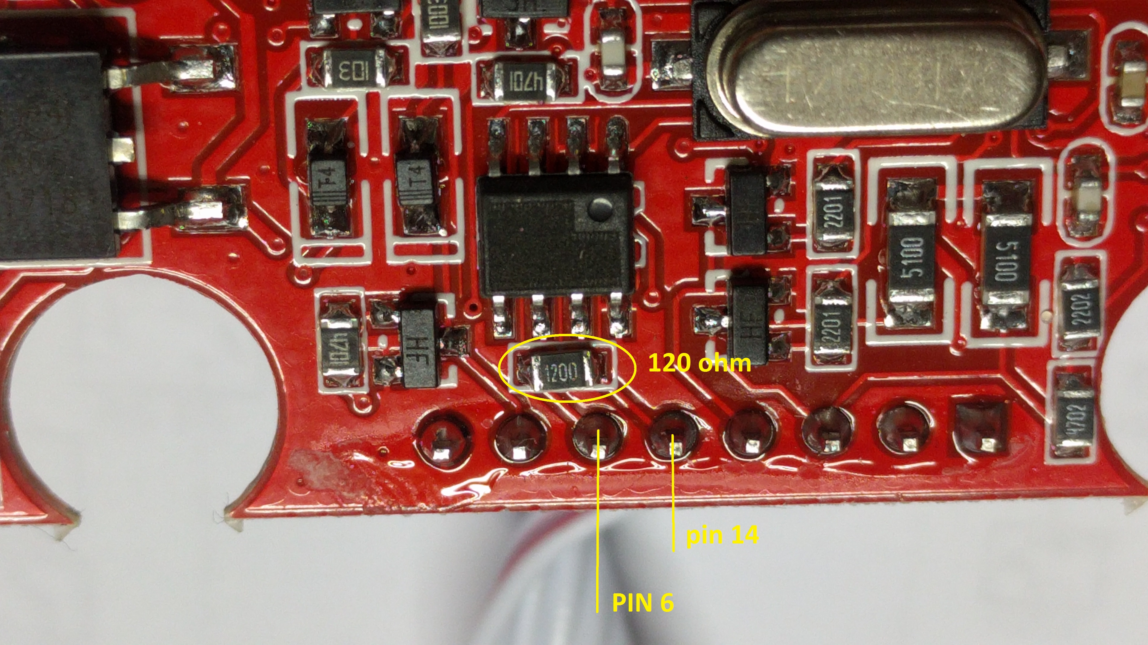

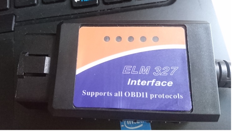

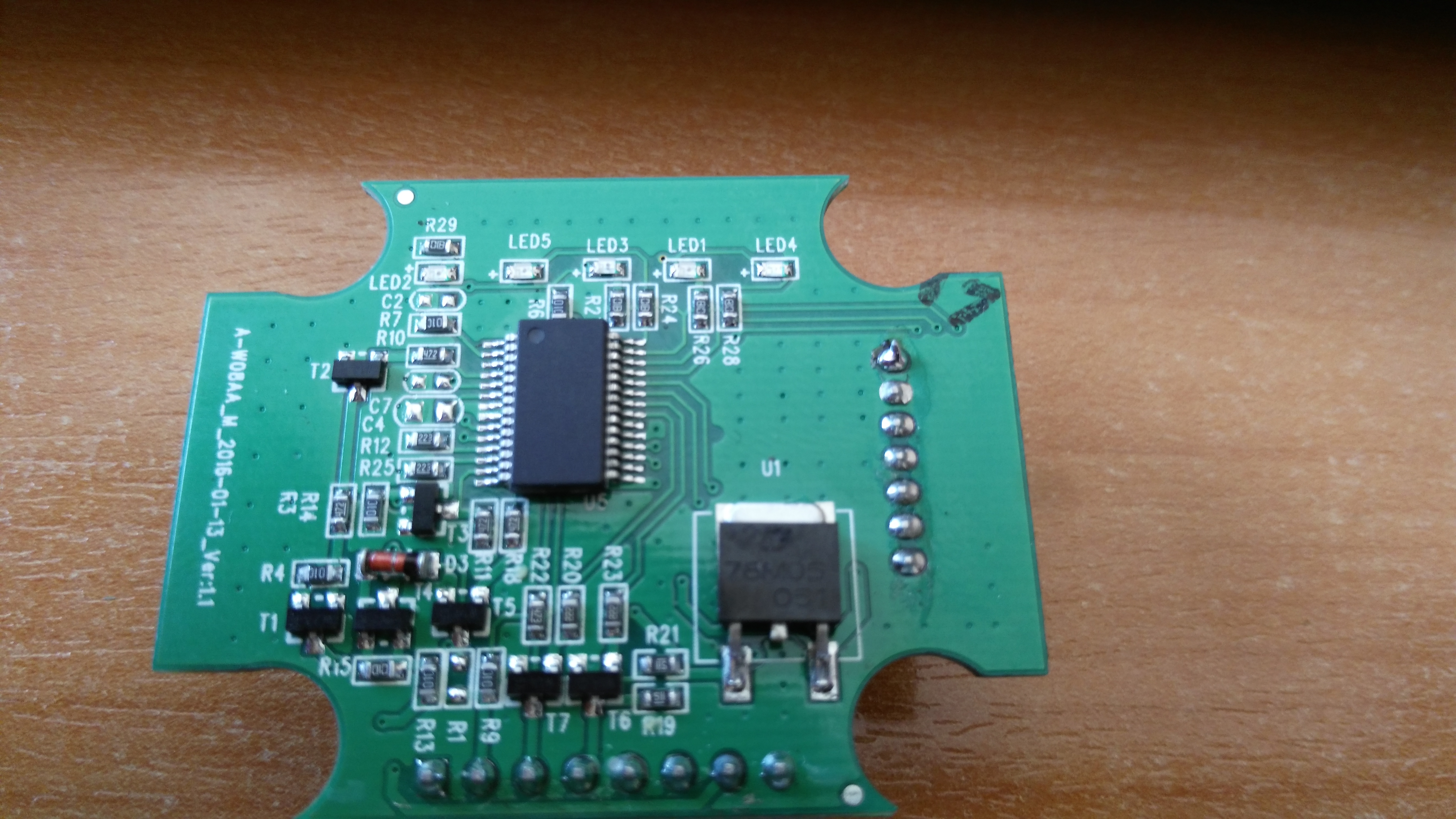

Hi Guys,
iam buy ELM327 V2.1 OBD2 - i have MESU 3.7 Registred.
in PC is all installed and works fine, but iam able connetct only to engine.
my qestion is, are some resistor for remove in this version ?
oskar69
Joined: 06 Aug 2017, 15:45
Post by oskar69 »
I found this ...
check by Multimeter
and tested on my Stilo MW 2003 JTD - all works fine
solution was remove this resistor
