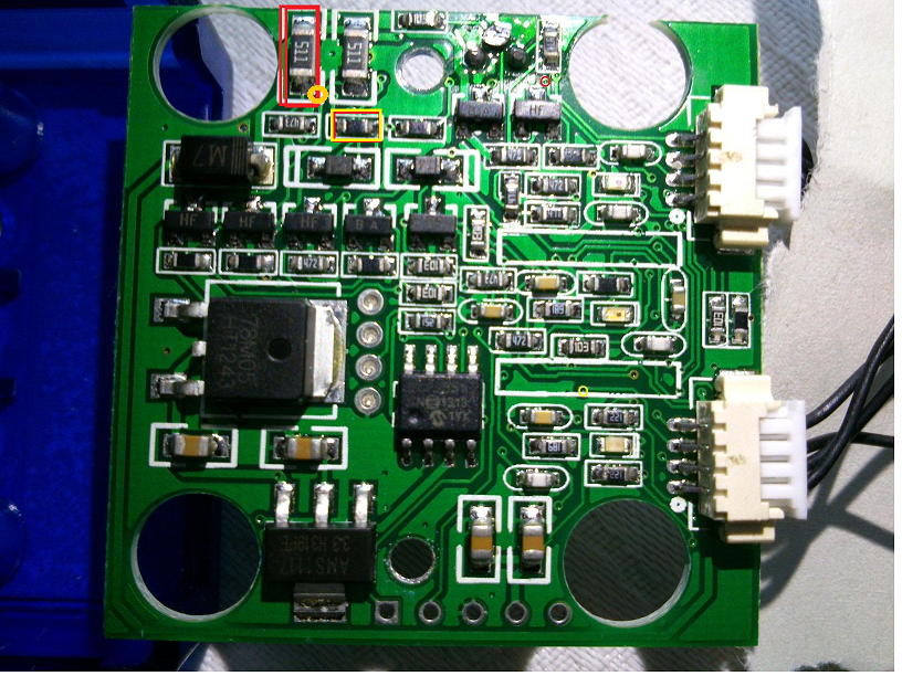

Hello Jordandc
You are very obstinate :-)
The easiest way is if you were to buy another ELM interface you :-)
But it's worth an attempt
I have a red dot and a yellow marked follow these two points on the back and select this please
DSC_0050 markiert.jpg (300.02 KiB) Viewed 12841 times

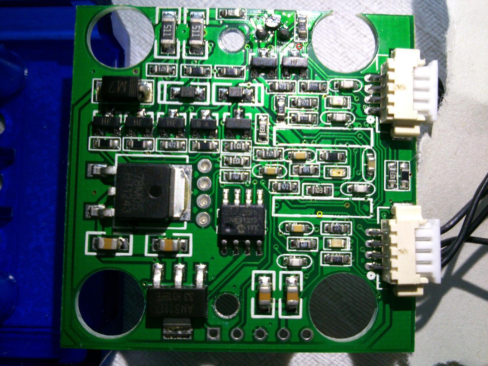

I dont want to buy another because it could be another faulty.
Bez tytułu1.png (1.14 MiB) Viewed 12840 times
Hmm maybe one of them is to remove
Bez tytułu11.png (1.11 MiB) Viewed 12840 times

What do you think about that 2 resistors?
Re: Elm 327 v.1.5 (V Gate Bluetooth) Connect problem
Posted: 13 Aug 2013, 21:40
Hello Jordandc
This Resitoren have nothing to do with the bridge resistor .
Has 120 ohms and connects the CAN high and CAN low wire together
I can find no bridge resistor on your board.
