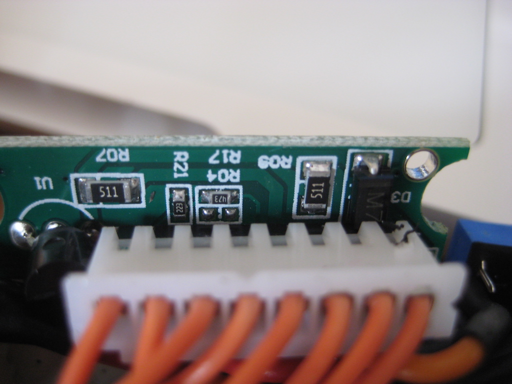

I don't understand what you mean for "correct circuit change"... Anyway, on my elm327 the resistor between can lines is already removed, directly from the seller, as you can see in my picture

Racing Man wrote:I don't understand what you mean for "correct circuit change"... Anyway, on my elm327 the resistor between can lines is already removed, directly from the seller, as you can see in my picture
Dear Racing, what I meant was exactly right (remove the resistor if necessary) since you did not pass this information before. I just did not look at his picture because I had not known this component visually ...

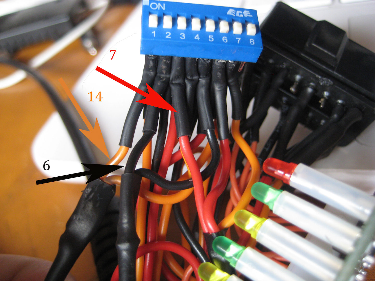

Frankly I believe that adaptation may be wrong, see that to simulate Adapter Cable 3 you need 3 switches (6-1, 14-9, 7-12). If you show a picture of your connection we can check.

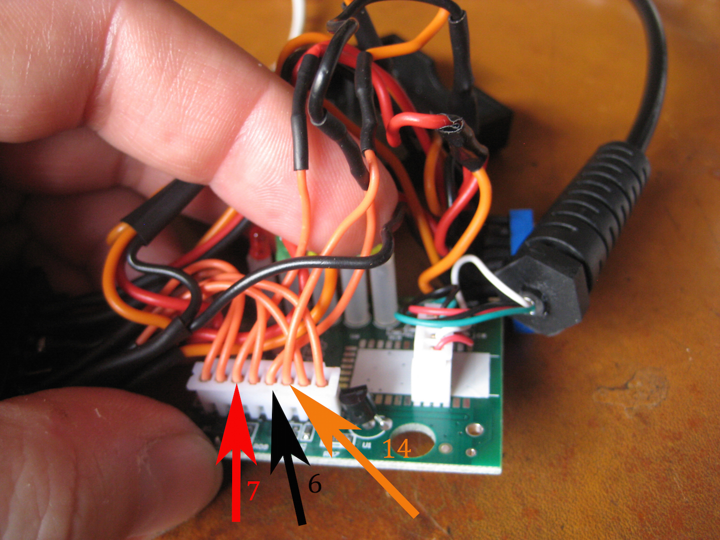

Waltomatic wrote:Frankly I believe that adaptation may be wrong, see that to simulate Adapter Cable 3 you need 3 switches (6-1, 14-9, 7-12). If you show a picture of your connection we can check.
No, the connections are correct, I've checked many times... I could even show a picture, but it's a little messy inside, and in my interface the cables are all in the same color... :cry:
I'll try anyway... I'm marking the pictures with some arrows...

In the picture don't mind switch #7, is orange but it's the pin7, and I need it to connect on my Alfa.
For my problem with the 500, just consider switches 1 to 6.
