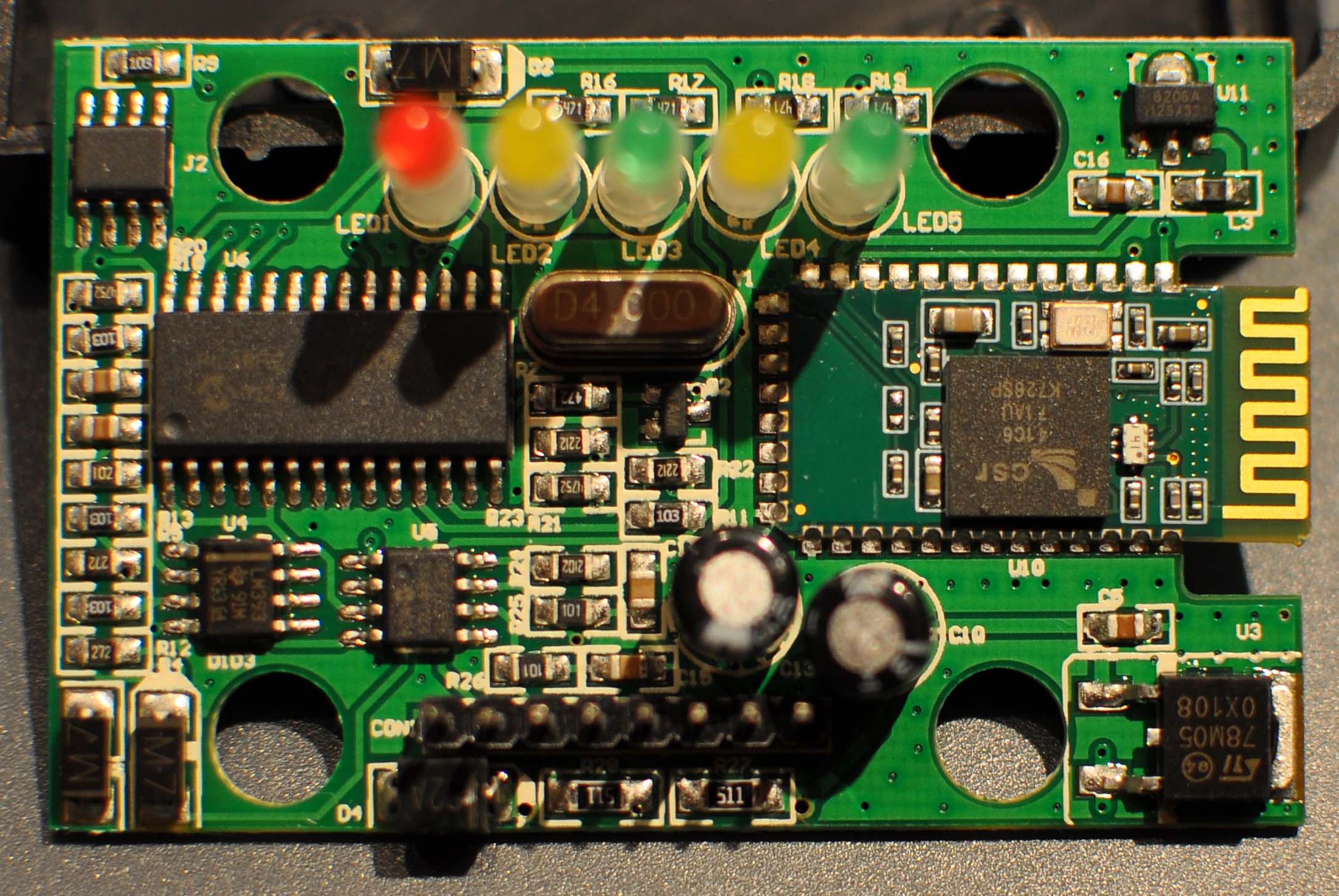

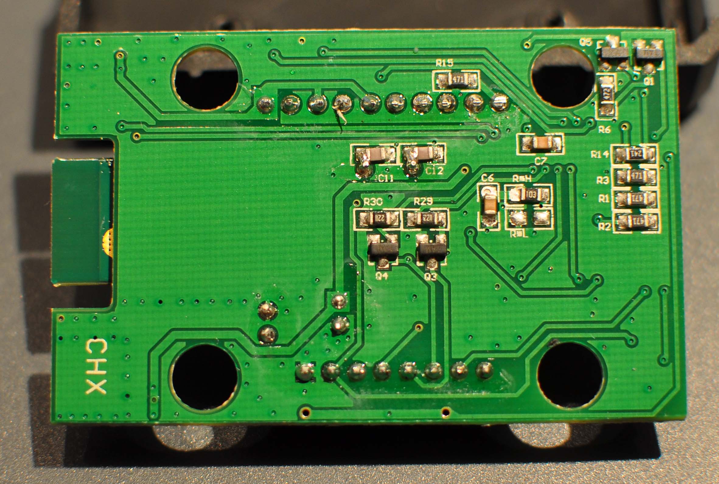

Now to the point: I have the following adapter with an "CHX" board as depicted.
Which resistor needs to be desoldered in order to access the CAN functions? And which functions are accessible over this network?
Thanks in advance!
Are you sure that this interface does not read CAN compliant?
I also have a BT interface have the CHX identifier
The work, however, without error in its original condition.
I suspect rather a hiring mistake

Which car?
Do not hesitate even a screen test the settings button in the FES
perhaps you can see why there can not you access the CAN.
