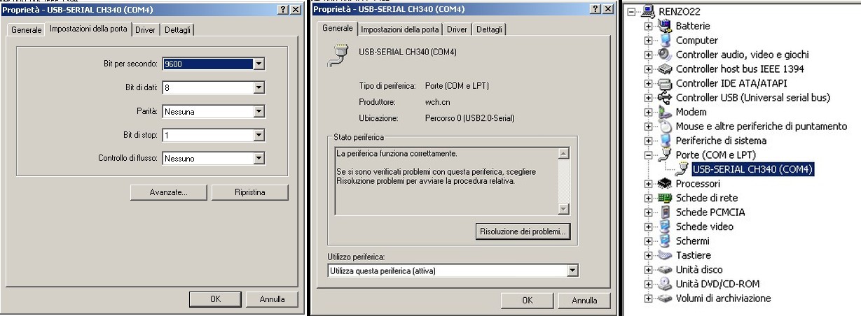

Well, Bigio, this interface is not dead. Very ill, perhaps ...
I do not know if I can help but I'd like to see two screen prints:
1) "COM ports" in the device manager
2) list of existing ports on MES

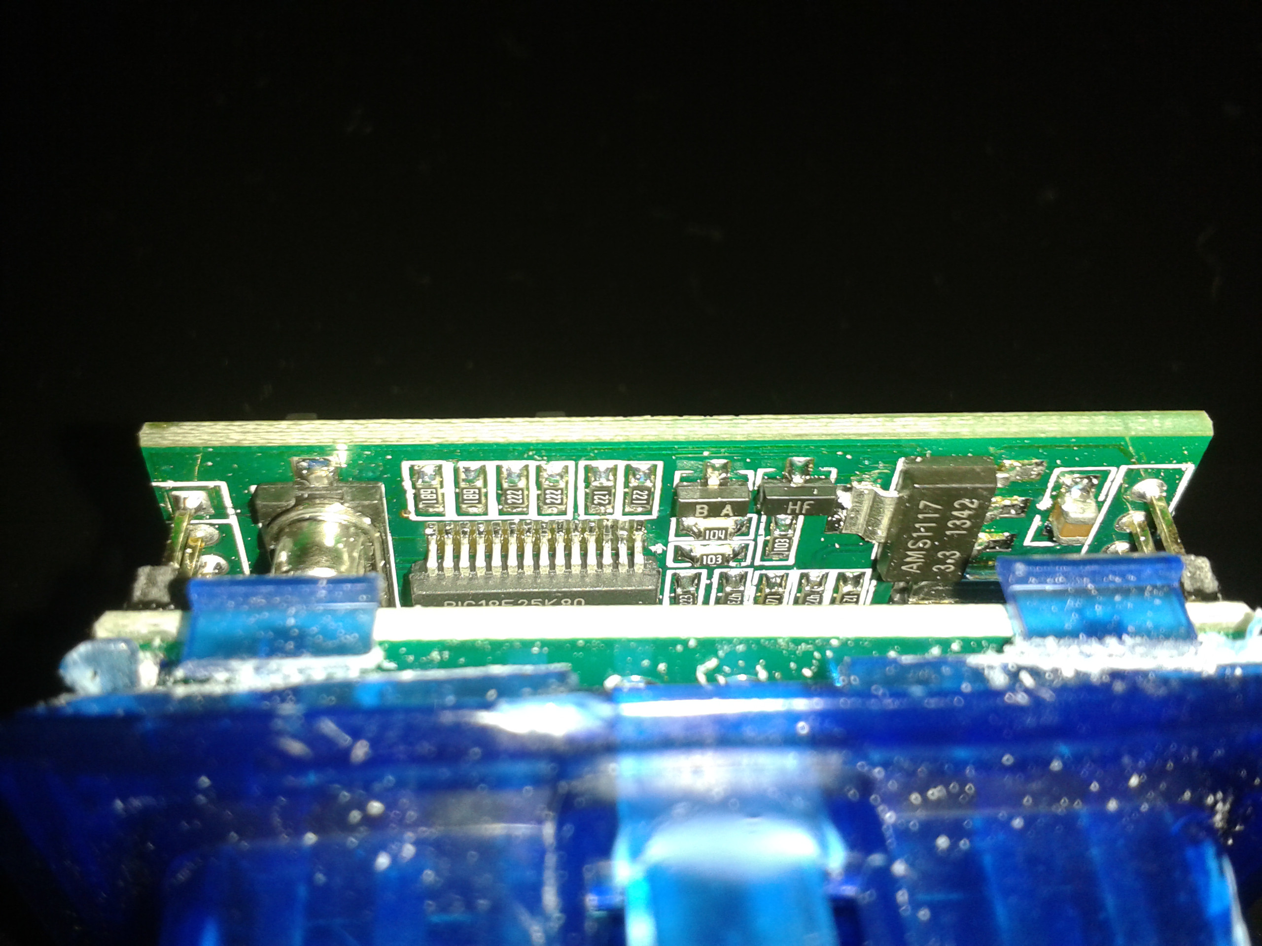

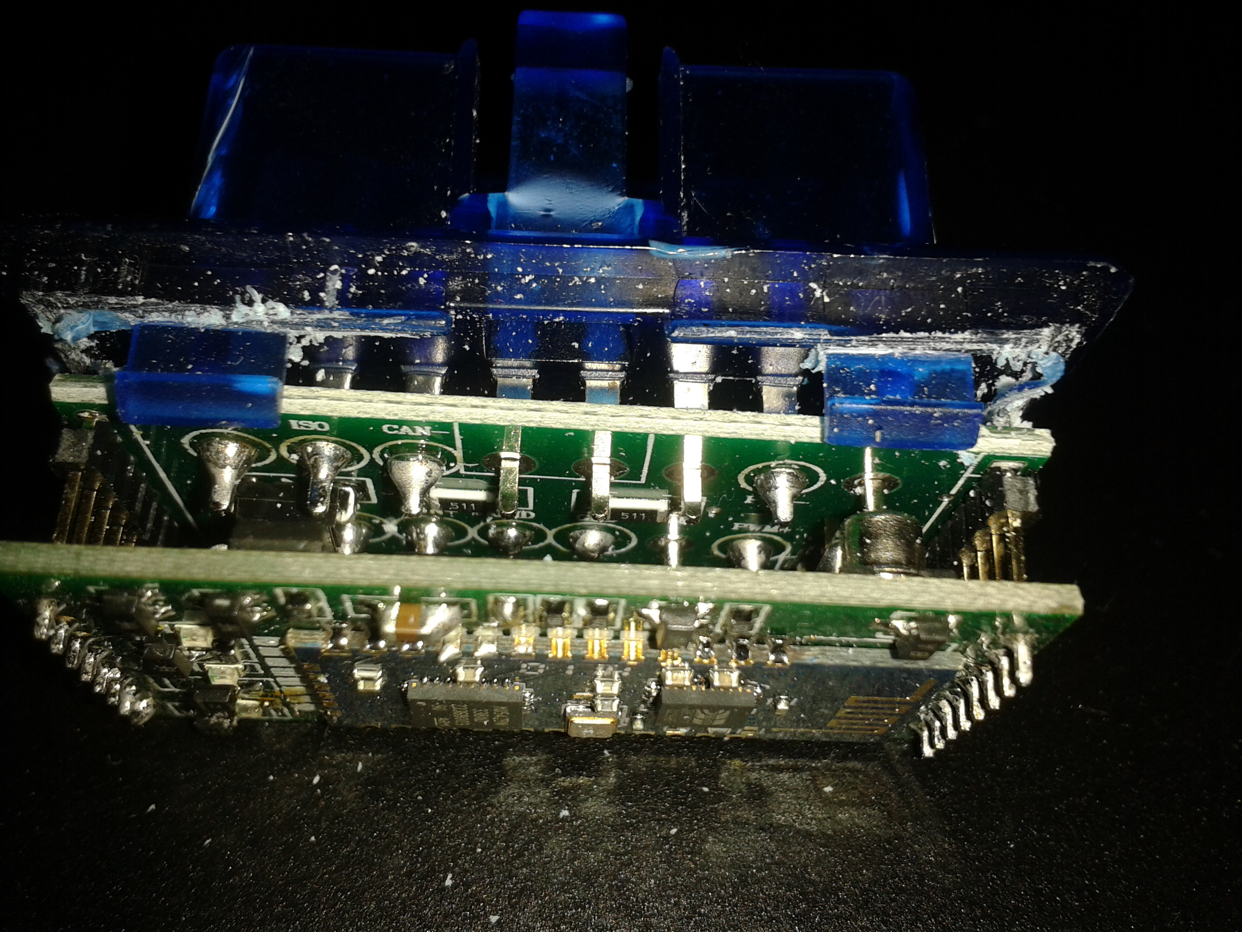

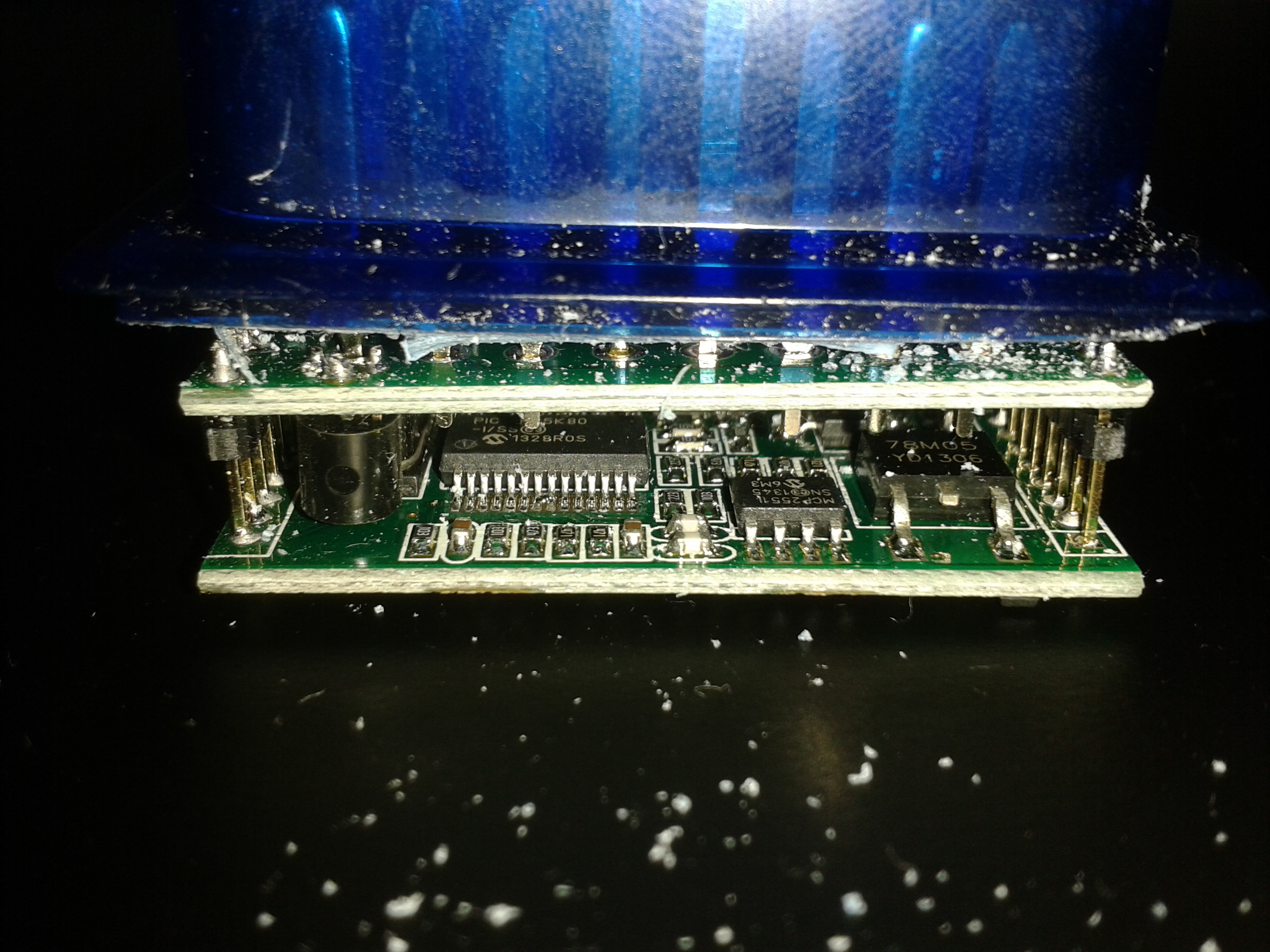

my Interface is not working properly as well and I could not find any pictures of this unit. Do you have any clue which resistor I should remove? Thank you
- 20141103_121231.jpg (807.56 KiB) Viewed 9437 times
- 20141103_113425.jpg (1.09 MiB) Viewed 9437 times
- 20141103_113455.jpg (946.79 KiB) Viewed 9437 times

If it is a CAN bus problem remove the marked resistance
and try again.

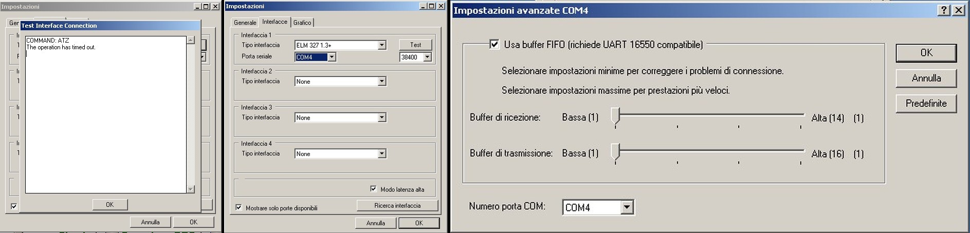

Here what you ask me. I'm nearly sure that ELM 327 USB Cable based on CH340 chip haven't never work with MES.Waltomatic wrote:Well, Bigio, this interface is not dead. Very ill, perhaps ...
Someone have this cable (and see in device manager) and can work with MES?
