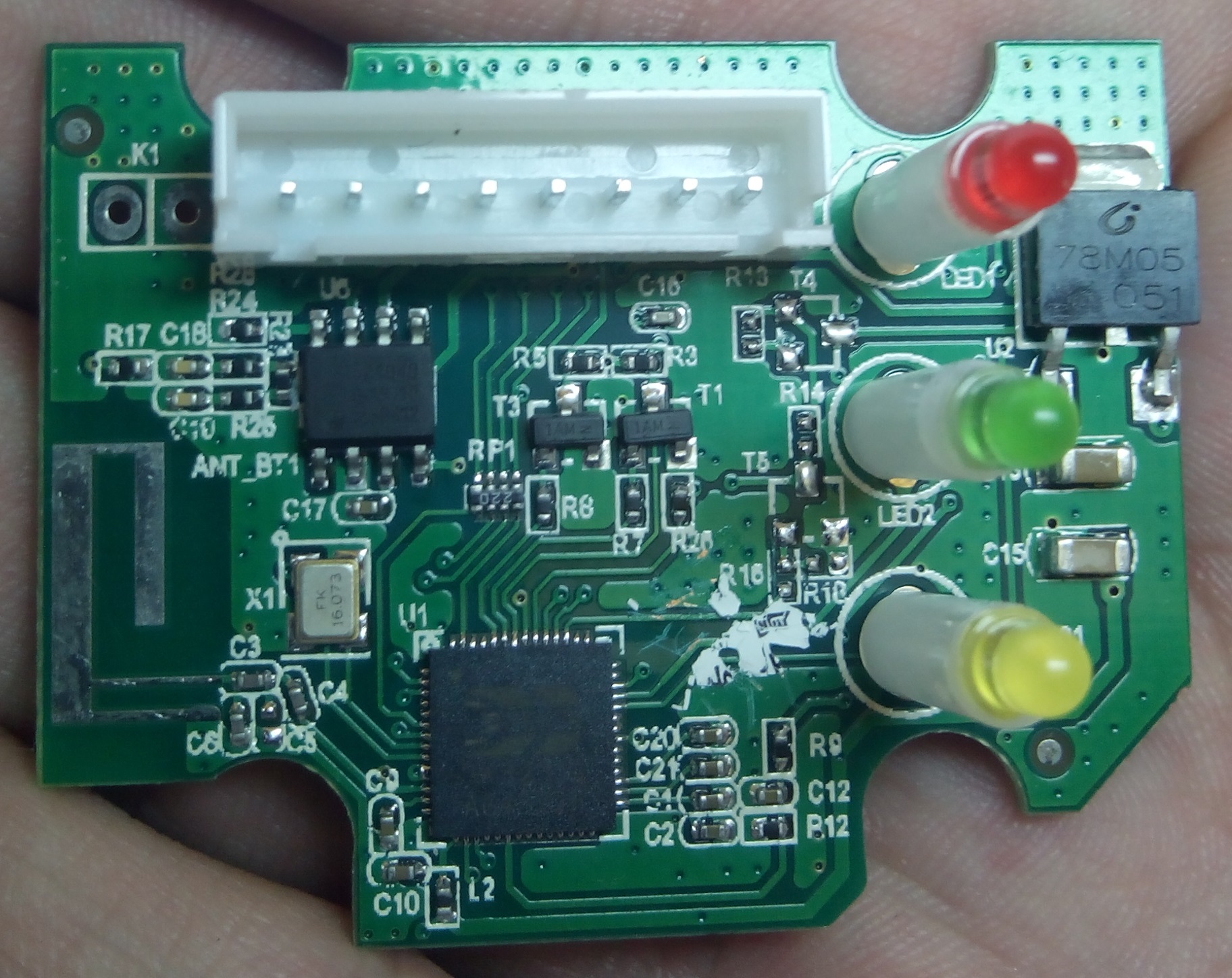

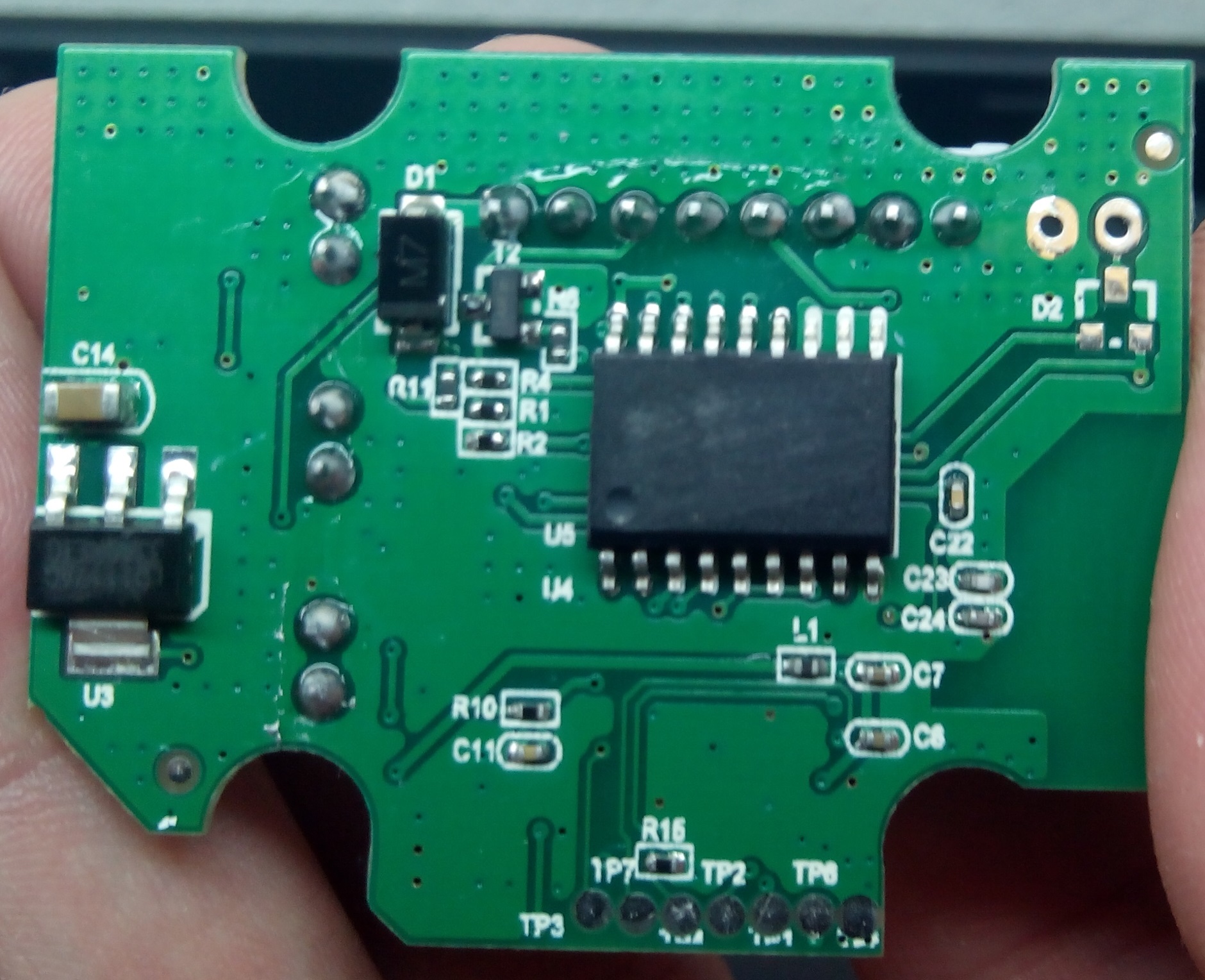

Hi Eddy,
unfortunately I can not unsolder the board, but the photos I sent you do see it in all angles.
The only resistors under the board are: R5 (473 ohms), R6 (103), R7 (103), R16 (102), R17 (102).
It could be r5?
It could be r5?

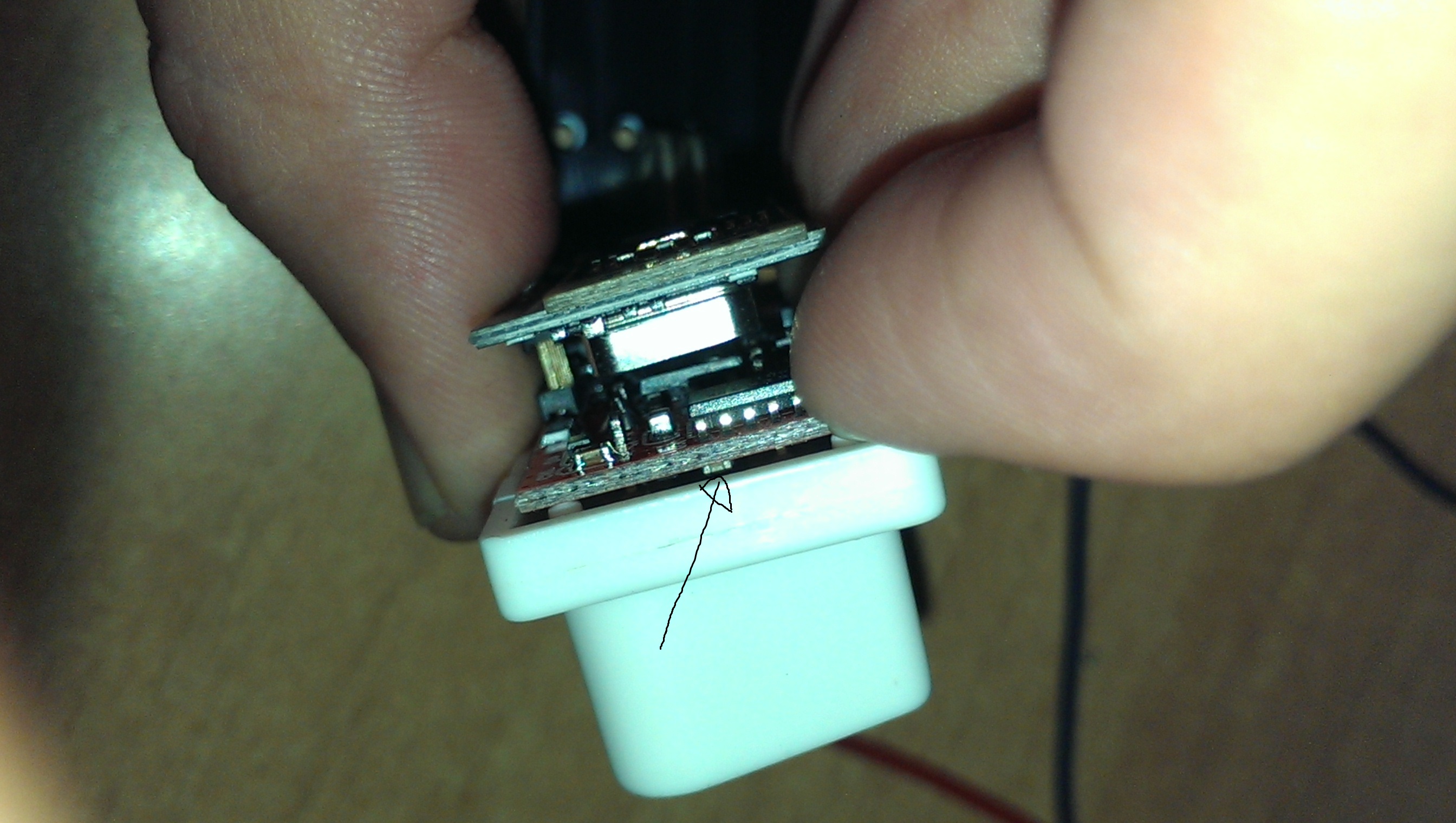

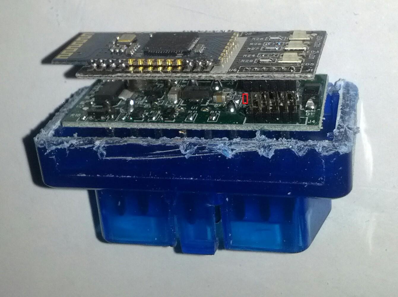

Hello Eddy,
unfortunately there is not that resistor in my interface
I have found that there are resistors under the tab at the bottom ( as I indicated in the figure) , where they attack the 16-pin ! how can I get them ? come off the 16 pin from the plastic ?
Greetings
Greetings
I solved it! The resistor was under, and not to unsolder everything I removed the plastic under the pin to access it and I removed the resistor. Now everything works perfectly! Eddy Thanks for the advice.

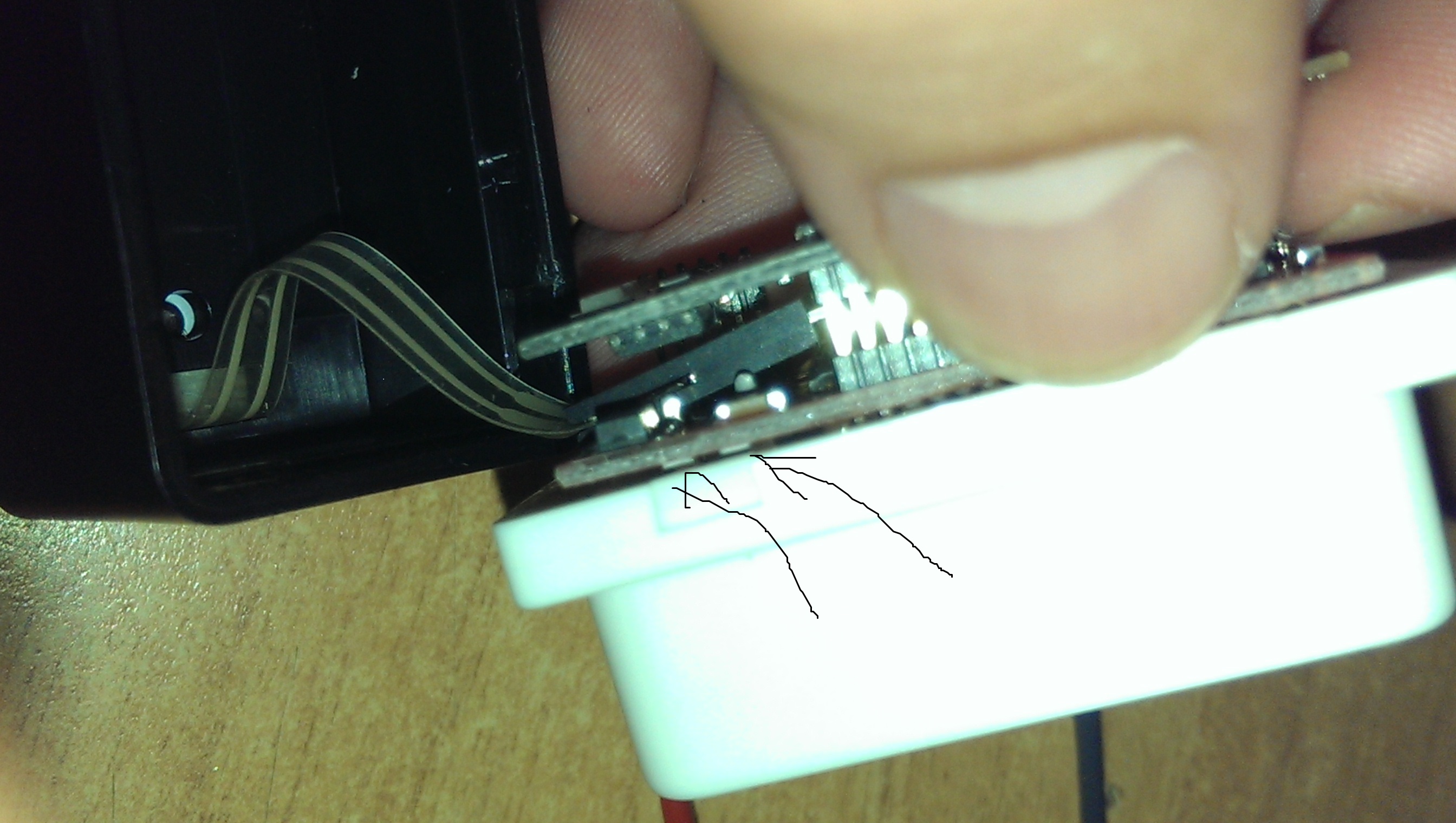

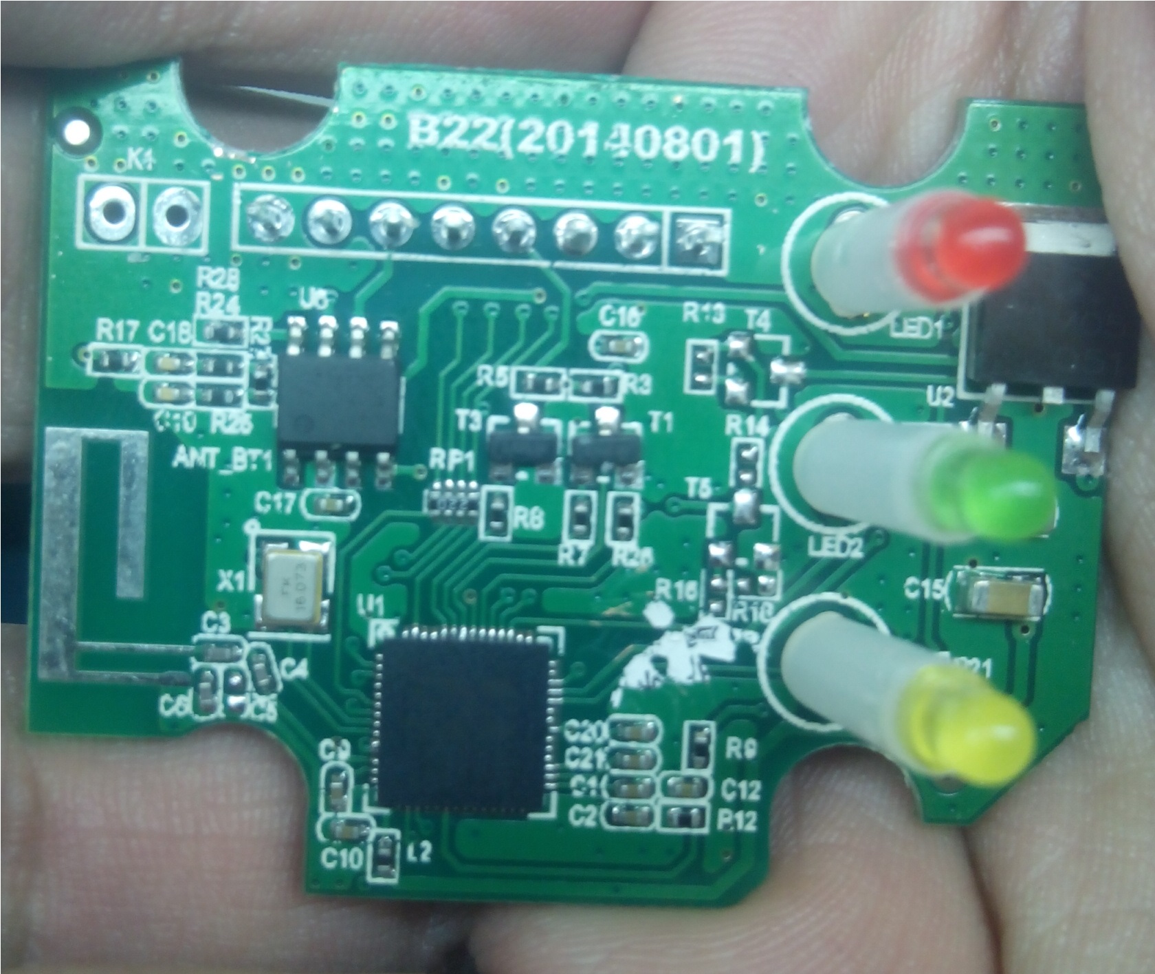

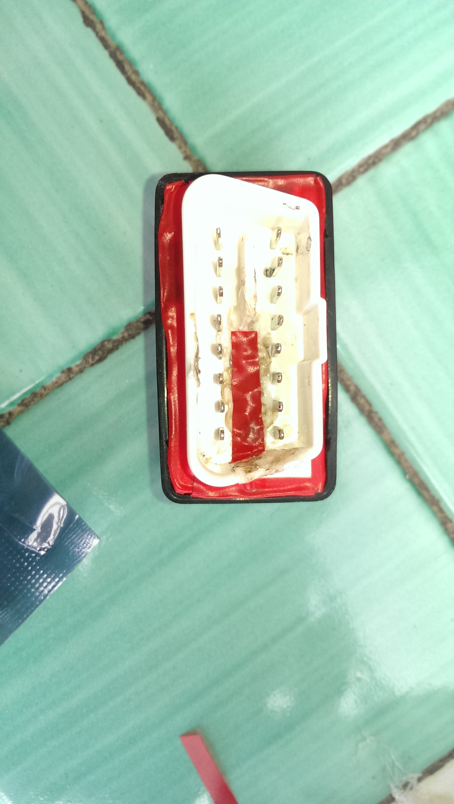

Hello Alfaeddy
Can you help me with this interface, please? Which resistor should I remove? Thank you.
- 20141025024700218.jpg (654.13 KiB) Viewed 8023 times
- 20141025024908630.jpg (716.96 KiB) Viewed 8023 times
hello
Remove the white (8 times) plug housing
And make a picture of it
Which vehicle ???
Which vehicle ???
My car is Fiat Punto mk2 1.2 16v 2000.
- IMG_20141026_225613.jpg (562.96 KiB) Viewed 7993 times
