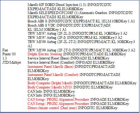

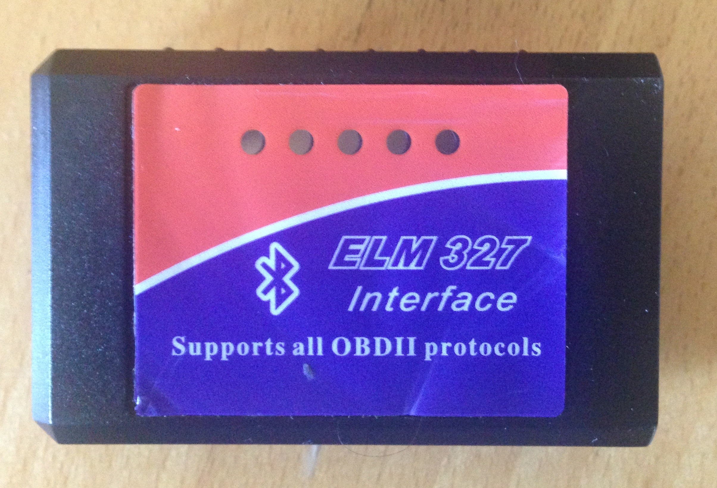

Same with this drivers. I've installed them, re-paired device few times, but no luck.
About airbeg, according to supported vehicles list it should be on CAN also (ELM C19). Or i didn't get this list right?
CONTINENTAL Airbag (Ep - PROXI)
- |INFO|DTC|DTC EX|PRM|ACT|
- ELM C19
- OBDKey C19
- A3
CONTINENTAL Airbag 2 (Ep - PROXI)
-|INFO|DTC|DTC EX|PRM|ACT|
- ELM C19
-OBDKey C19
- A3
TRW MY05 Airbag (Ep - PROXI)
- ELM C19
- OBDKey C19
- A3- Attachments
- Photo 22.6.14 16 10 22.jpg (1.2 MiB) Viewed 8807 times
Your Punto is from 2006 so this list should be true for you.
In 2006, the Punto did not have a C19 CAN bus
In your ELM even the chip (MCP2551) has been copied.
Although this is not protected.

Probably not damaged but it's not compatible i guess. Using other software i've successfully removed check engine error from one Alfa GT today, but i was not able to connect with MultiEcuScan on the Alfa also as on my Grande Punto.
