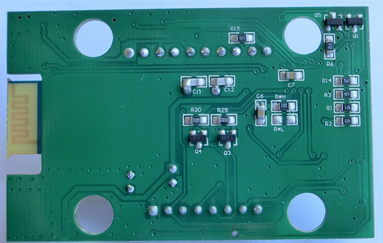

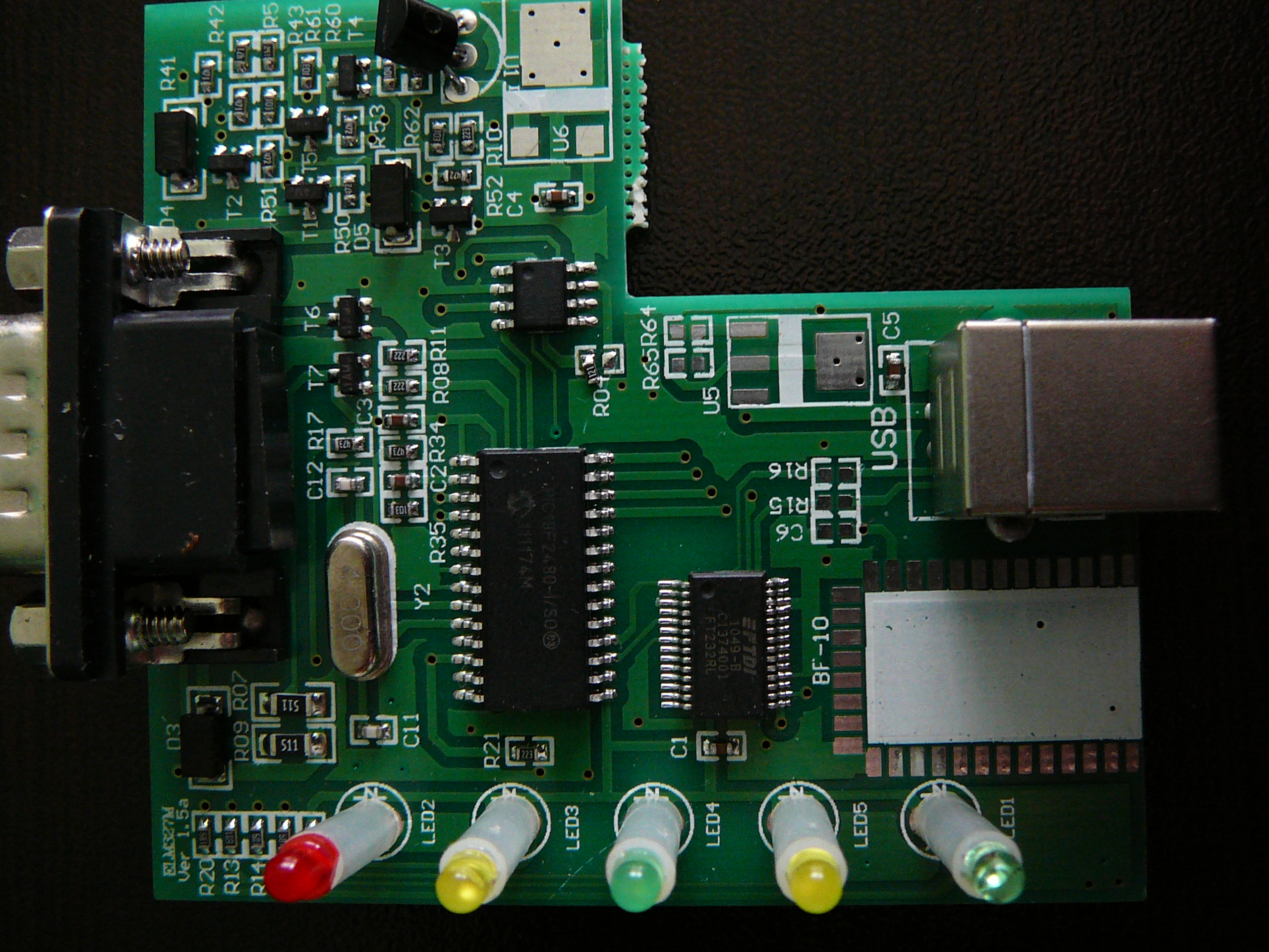

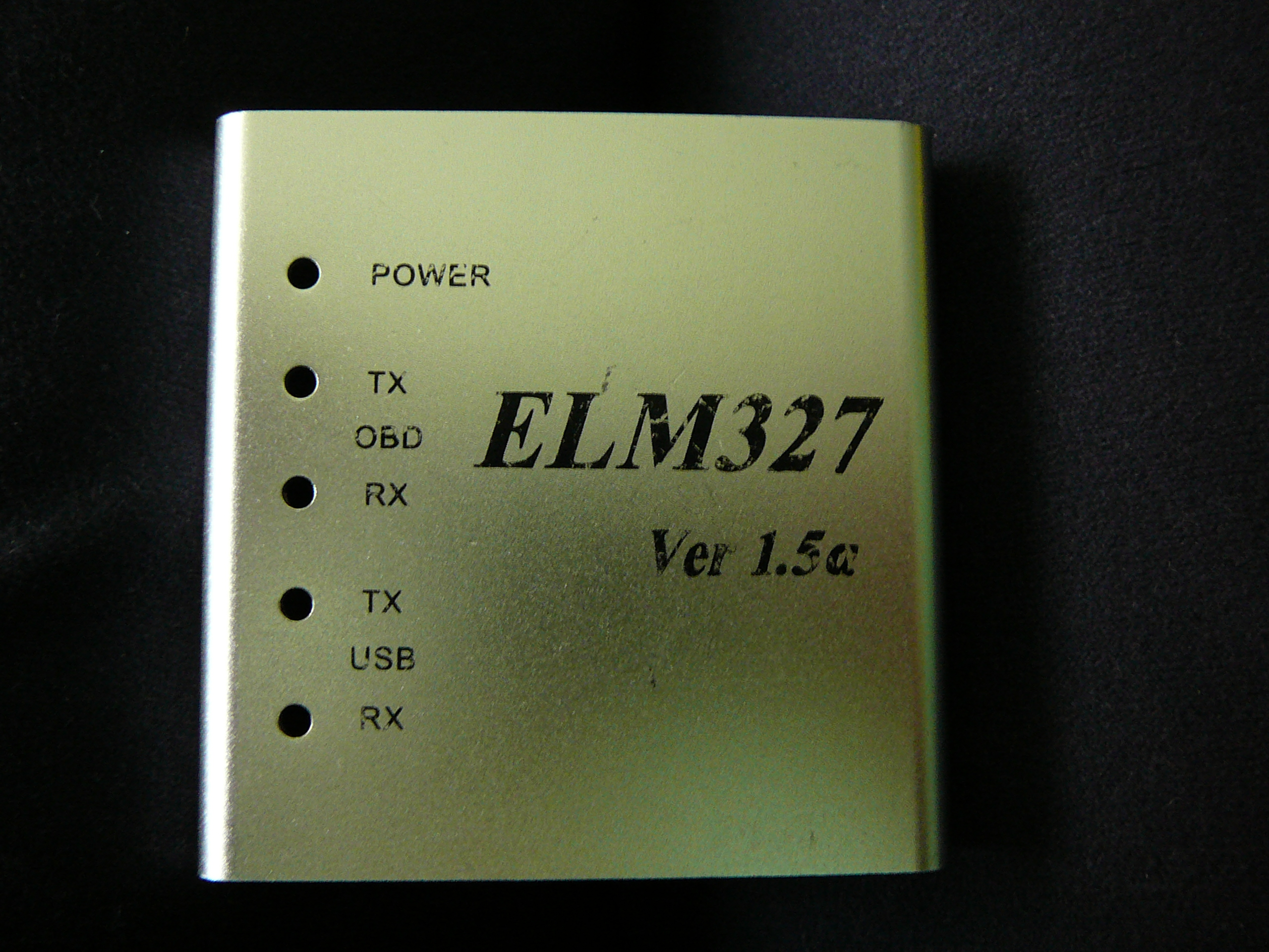

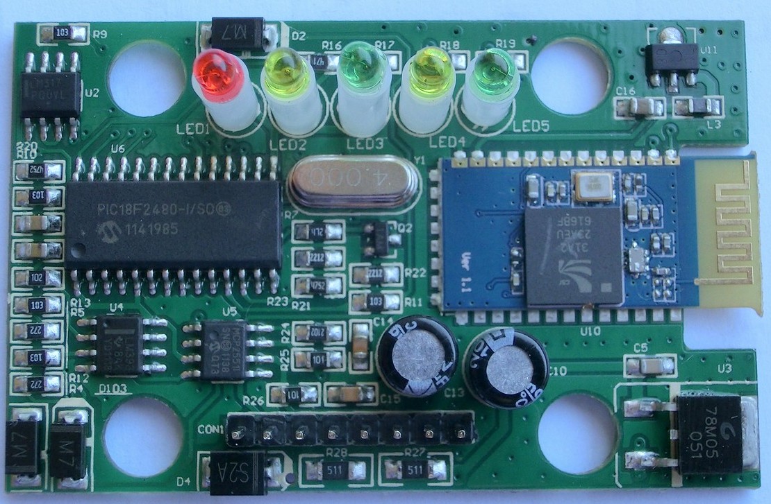

Colleagues have 327 Elm ver.1, 5 please help me what should I remove the resistor and if I should put capacitors. I freaked P04 but I do not know whether it is right.
- Box
- P1140729.JPG (1.62 MiB) Viewed 9194 times
- board face
- P1140727.JPG (1.75 MiB) Viewed 9194 times

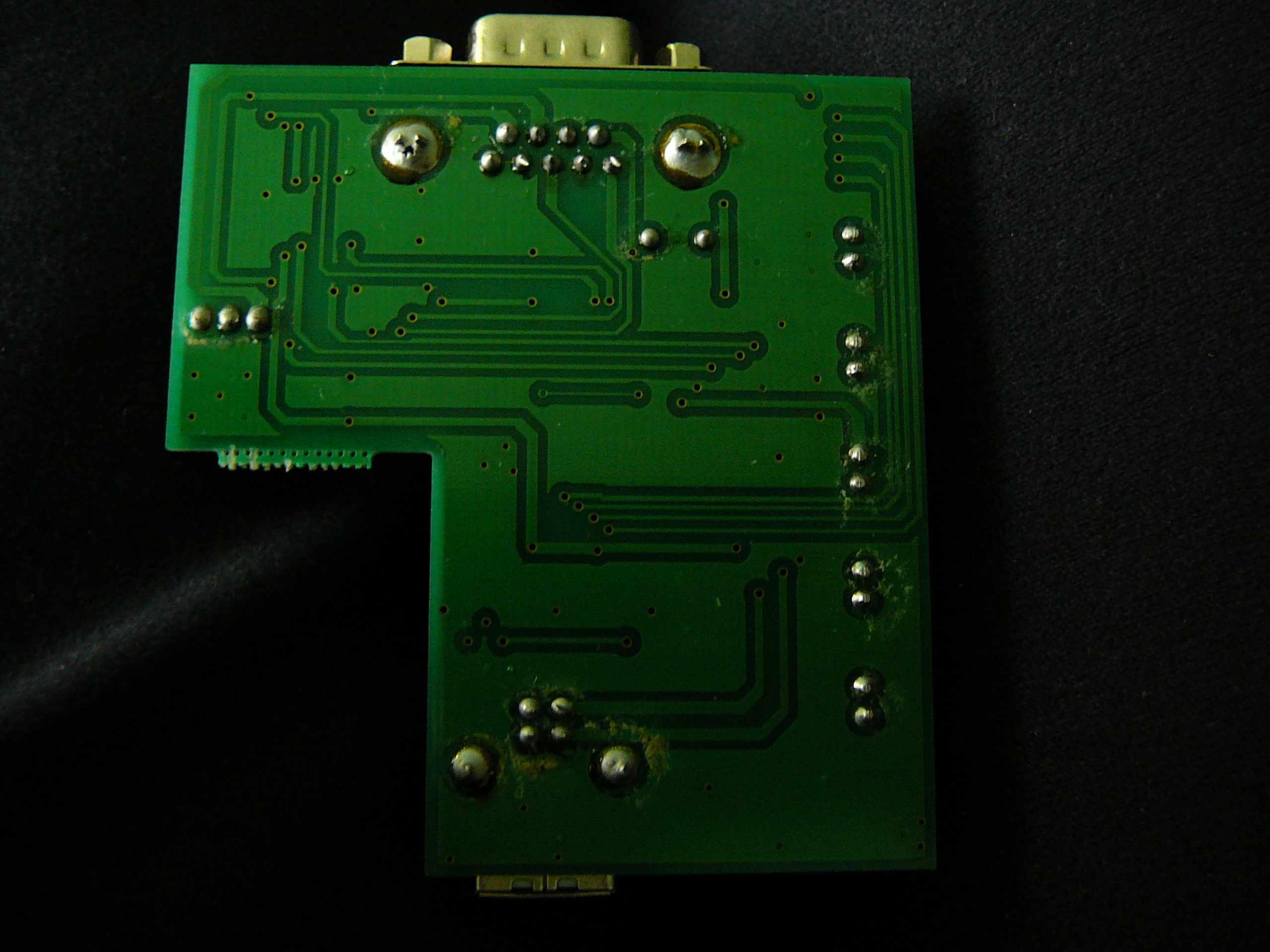

- back board
- P1140728.JPG (1.81 MiB) Viewed 9194 times
Hello Rosenmvr
What control you want to read?
on which vehicle?
Your partially dissolved Resistor is the right one.
And a capacitor you do not need to solder a.
on which vehicle?

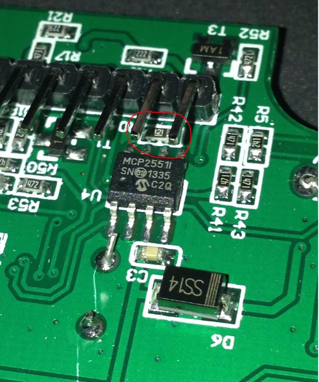

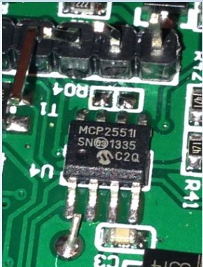

ELM 327 WiFi
Is this the resistor I have to remove ?
- elm front 2.JPG (101.93 KiB) Viewed 9189 times
cmosfxx wrote:ELM 327 WiFi
Yes it is the right Resistor

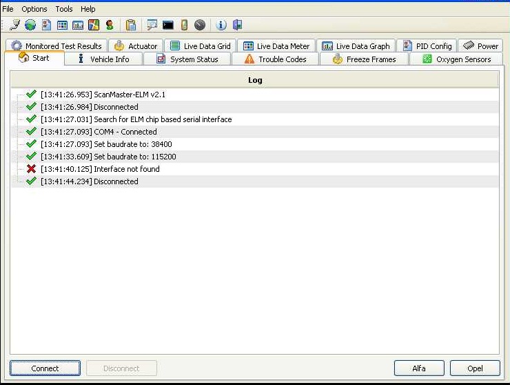

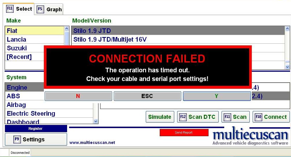

Hello, everybody.
I have same device as posted here: viewtopic.php?f=5&t=1493&start=1090#p13873
When connected to car OBDII connector (Fiat Stilo 1,9 MultiJet from year 2007), only red light is on, but MES can''t find my device (ELM327)!
Installed FTDI driver on XP SP3, port COM4, latency 1, MES 1.7 registered.
I'm not sure if wiring is ok?
OBD - 8 pin connector on PCB (pin 1 under C10, pin 8 beside R20)

Alfaeddy wrote:cmosfxx wrote:ELM 327 WiFi
Thanks! Works.
