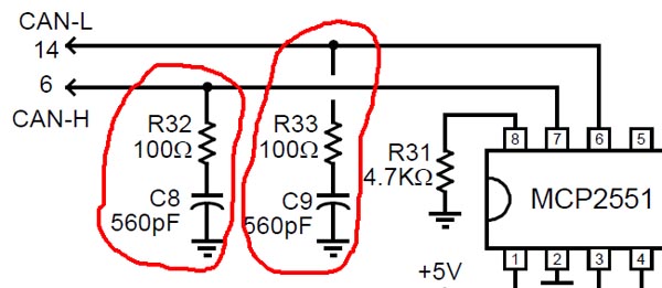

1- The 121 Ohm resistor formed a bridge between pin 6&7 of MCP2551 (Pin 6-14 of OBD), and I removed this.
2- I want to use this interface on Grande Punto. (Engine ECU and Selespeed ECU)
When I look at the board I do not see the 100Ohm Resistor+ 560pF cap. ?
Is it true to add these missing parts to use on Grande Punto?

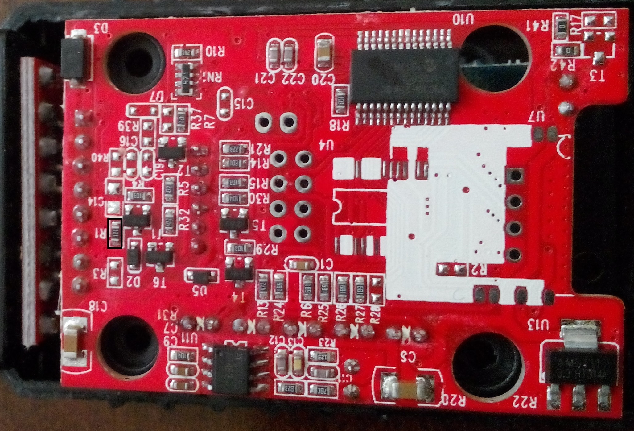

reeper72
Joined: 03 Apr 2014, 18:33
Post by reeper72 »
cant find my board on hear cant see ro4 :( the board is red no writing on it tryed to up load picture need help please
