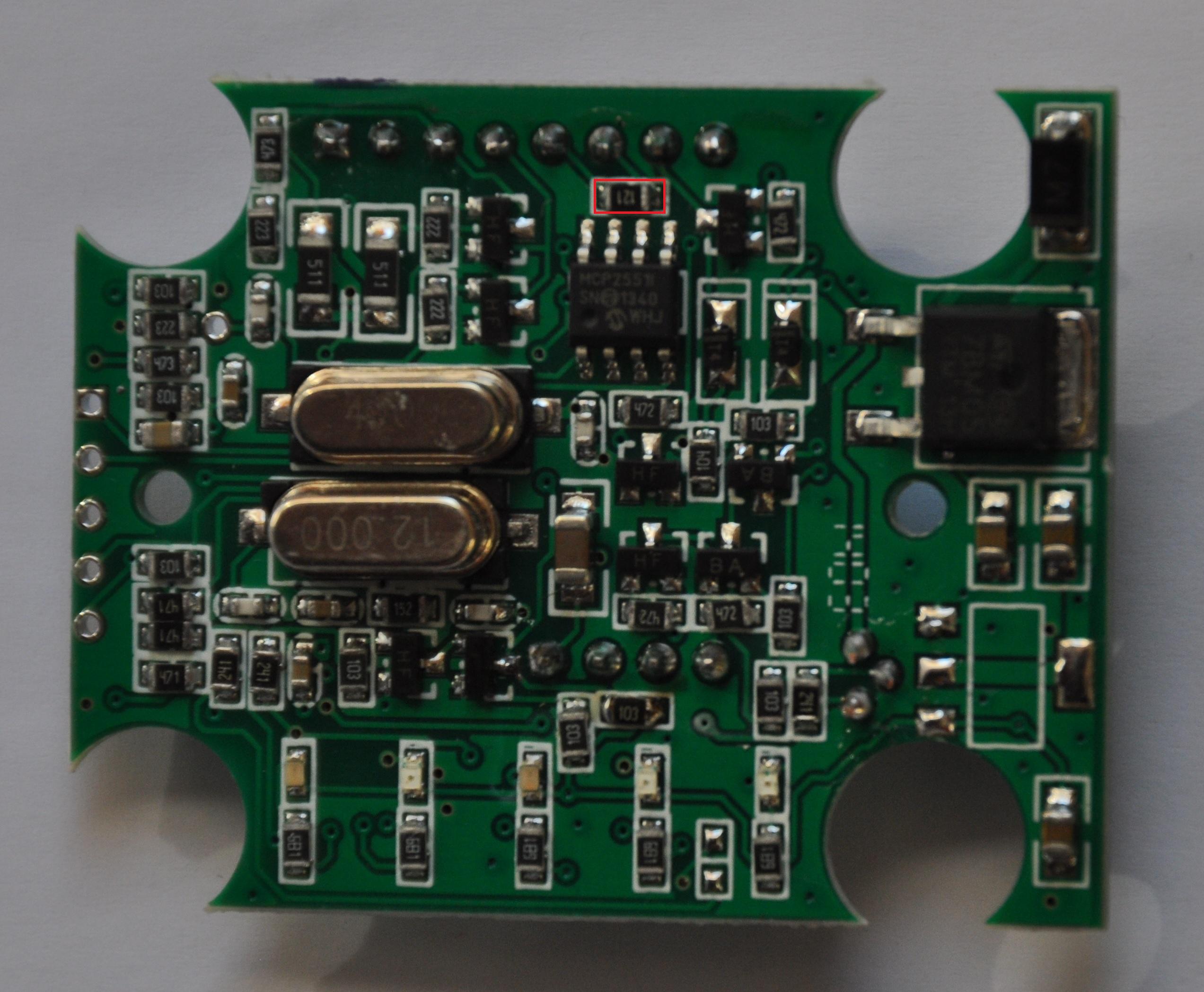

But we have a Fiat Idea 1.3jtd and a Brava 1.2 petrol in the family too. I checked on the Brava and that one has the 16 pin connector like on the ELM327. Should I remove the mentioned 121 ohm resistor in order to connect to those more recent Fiats ? As you can see on the picture (see my previous mail) this ELM seems quite updated, with two different circuit"clocks" (I think that is what the silver boxes 4000 and 12000 are?), also the LEDs are SMD, and no more the "big" ones. But the 121 ohm resistor is still present.

I bougth a ELM 327 1.5 ( USB version )
Can you show me wich resistor i have to release?

Hello Svene
The red marked resistor is responsible for the CAN Bus Problem
remove this and your ELM can read logs with MES also CAN bus.

Hello Panda500
On your ELM Interface it is the same Resitor

Thank you. I gues it could be the marked 121 resistor,but I was'n sure so thanks for your fast answer
