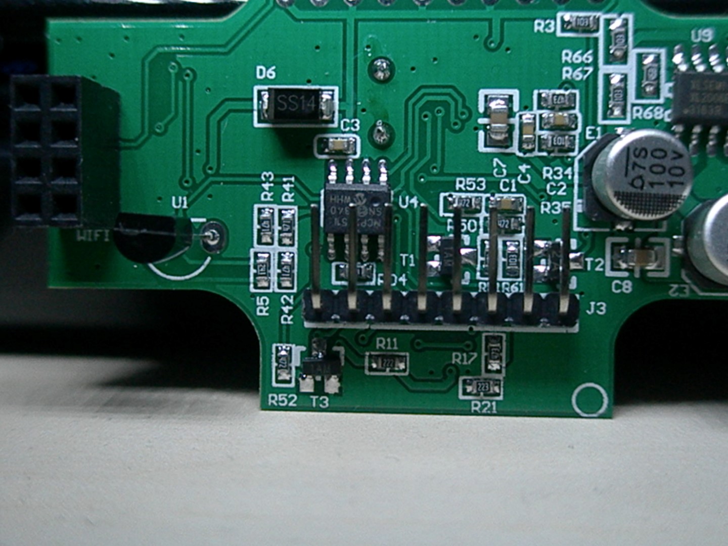

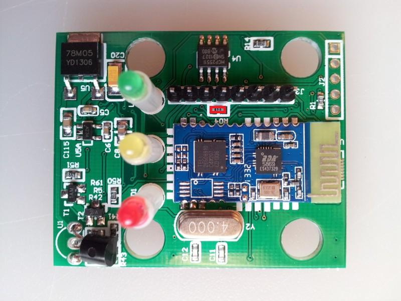

hi Alfaeddy in the red circle there is an R04 resistor.
P1010006 (Large).JPG (281.99 KiB) Viewed 7091 times
P1010002 (Large).JPG (285.93 KiB) Viewed 7091 times

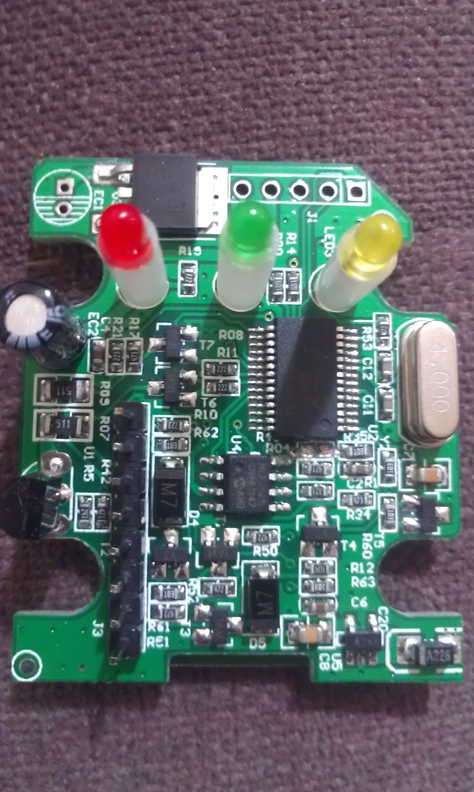

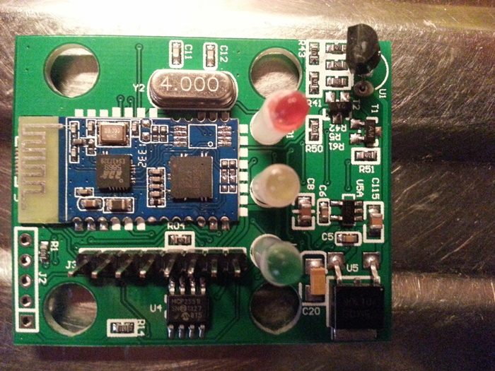

Hi, samebody can help me ? I bought the elm 327 bluetooth and it's work fine with motor module but when I try to connect to the body module the error connection appear. I use fiat multiecuscan 1.7
THANKS A LOT !!!!!!!!
Andrea
20140221_154350 ridotta.jpg (379.9 KiB) Viewed 7089 times
20140221_154412 ridotta.jpg (361.9 KiB) Viewed 7089 times

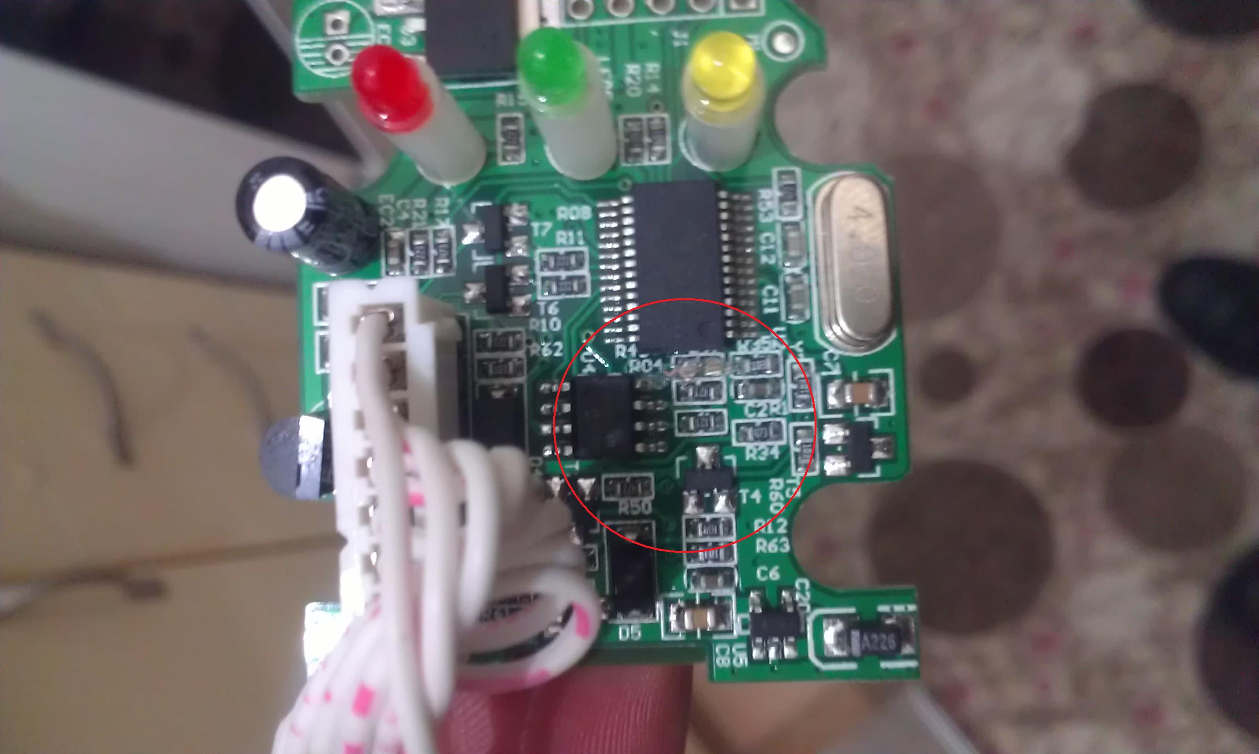

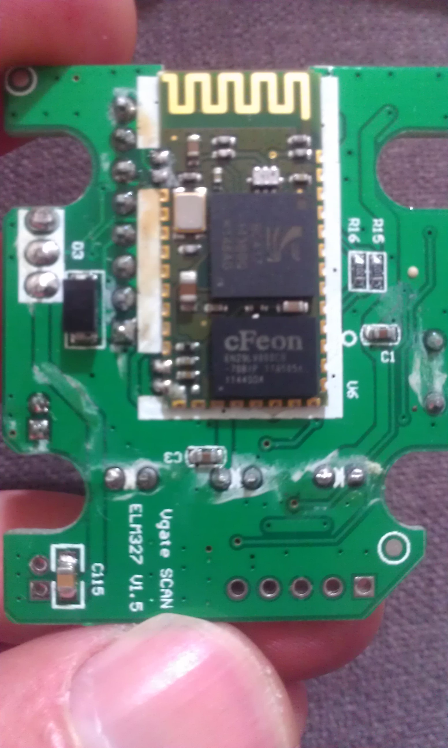

My elm is here v1.5 bluetooth. İ want to modifications this elm and i want to open cruise control. My car is fiat linea 1.3 95hp 2013 euro5
Hello Gieboue
Thank you for the better picture
Remove big the resistor R04, in the red frame
P1010006 (Large) markiert.jpg (171.45 KiB) Viewed 7087 times
Hello Andrea
Even with your interface the resistor R04 is the problem
Remove R04 (red frame) and your interface will work
d272b0cab2a2902c0621a25ee1de6934 markiert.jpg (68.55 KiB) Viewed 7087 times

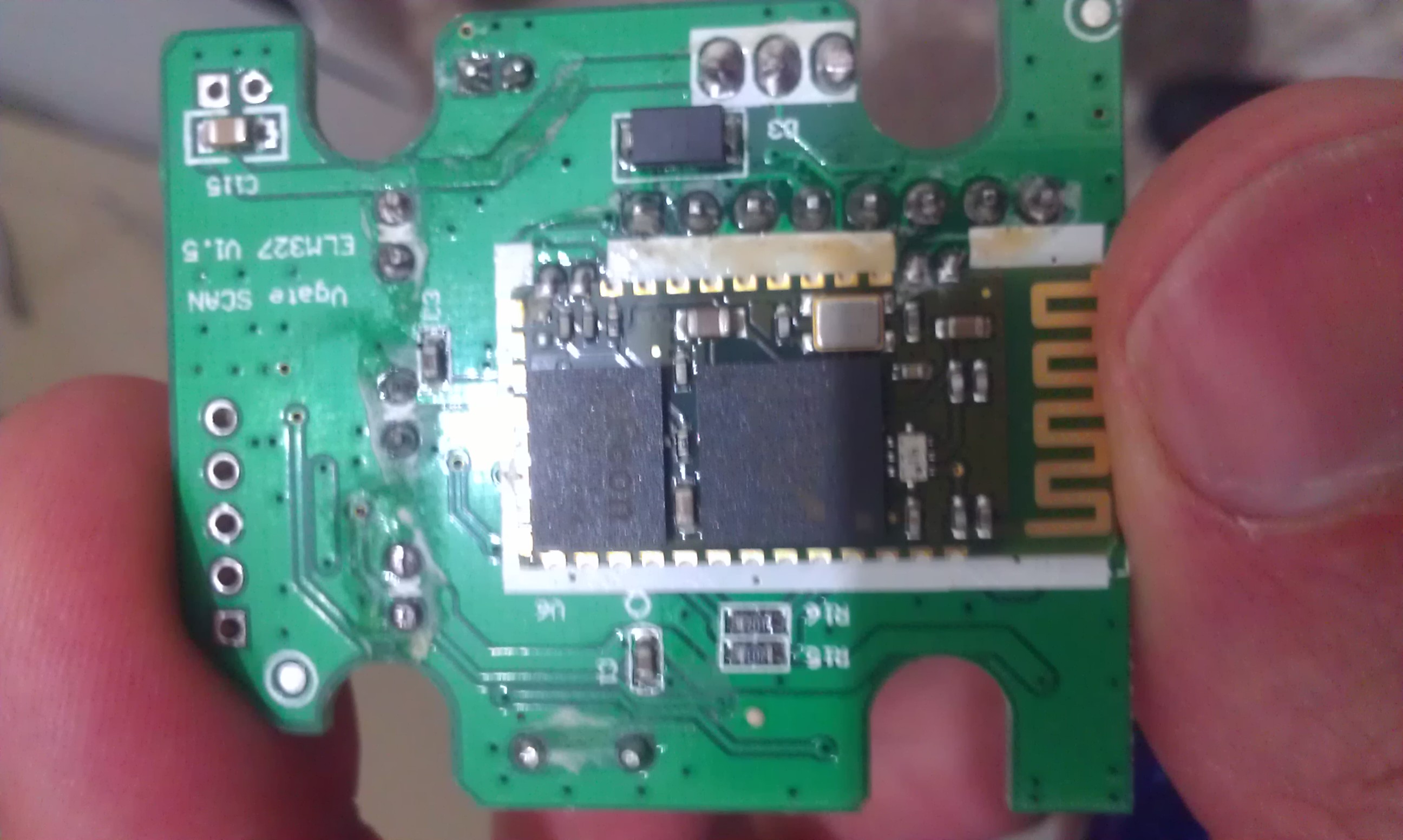

Hello Juanito
Your picture is unfortunately very blurry.
I can not see any numbers on it.
Do not hesitate to a better picture of the area in the red circle
IMAG0388 markiert.jpg (269.16 KiB) Viewed 7087 times
juanito
Joined: 20 Feb 2014, 22:22
Post by juanito »
Hello again
not red circle in my elm v1.5 bluetooth. I remove r04 but i cant activate cruise control again. Thanks.

Hi Alfaeddy,
thanks for the answer ,
I have removed the resistor R04 but the problem is the same.. :cry:
do you have another solution?
thanks !
Andrea

Hello Andrea
The red marked resistor is already correct
If your connection still does not work it may be the only driver to adjustment.
Just try this driver
