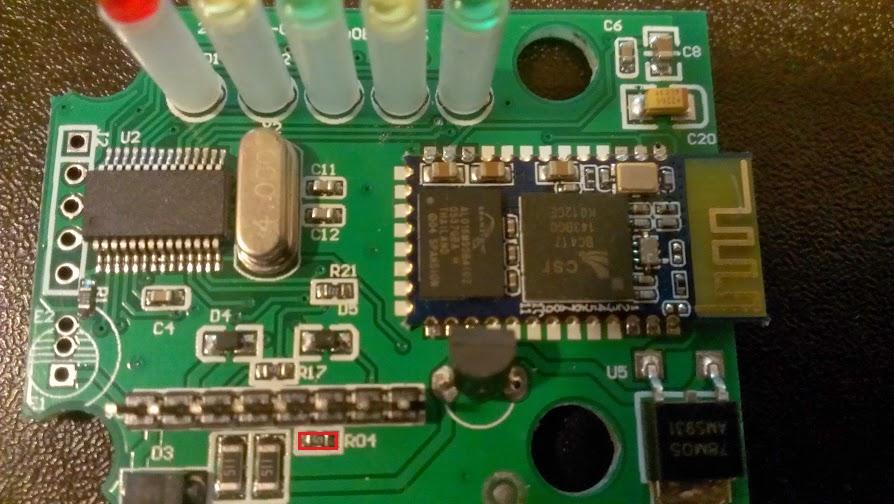

Hi guys. Hoping you can help. Trying to connect to CAN on my 147. Just need to know what I need to remove
https://lh3.googleusercontent.com/-2EQV ... AG0140.jpg
https://lh6.googleusercontent.com/-WJFq ... AG0141.jpg
Thanks in advance
Adrian
What problem you have while reading your 147?
In addition, this resistor (red marked) be removed if you can not produce a CAN connection
This interface has been repeatedly described here
IMAG0140 markiert.jpg (75 KiB) Viewed 11200 times

Unfortunately, there are no other possibility for you,
Open the ELM and find this bridge resistor and remove
This ELM we had several times already but here you have to look yourself
set or an image.

Take now please a multimeter to pin 6 and pin 14 and measure the resistor between two pins
Then you can measure whether a bridge resistor is present.
