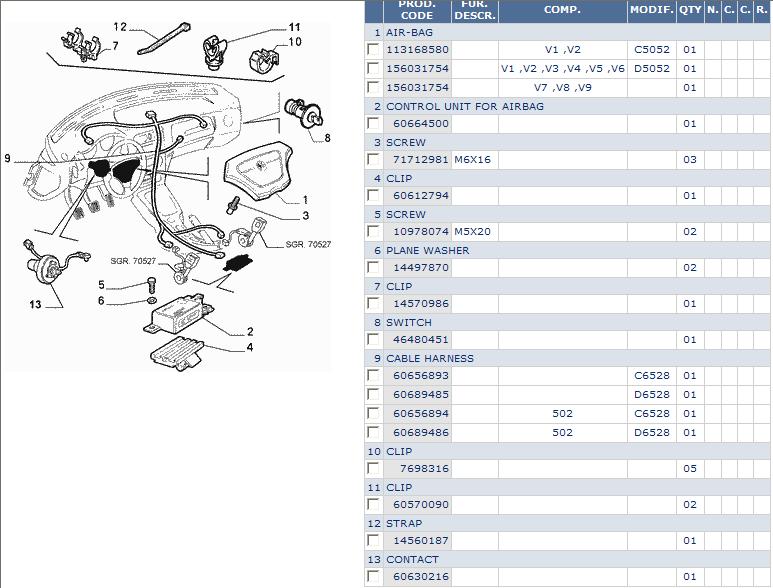

Viking wrote: I have 2 airbags and 2 seat belts pretensioners - I will check connectors tomorrow and let you know.
If U have only 2 airbags then only check connector under passenger seat, there is(should be) connector of mat, which is responsible for checking if the passenger is on the seat.
But it's also possible that the mat is broken.

Nope, there is no mat in my car... only 2 airbags and 2 seat belt pretensioners.

True, check all connections, if no succes then probably control unit is broken.
