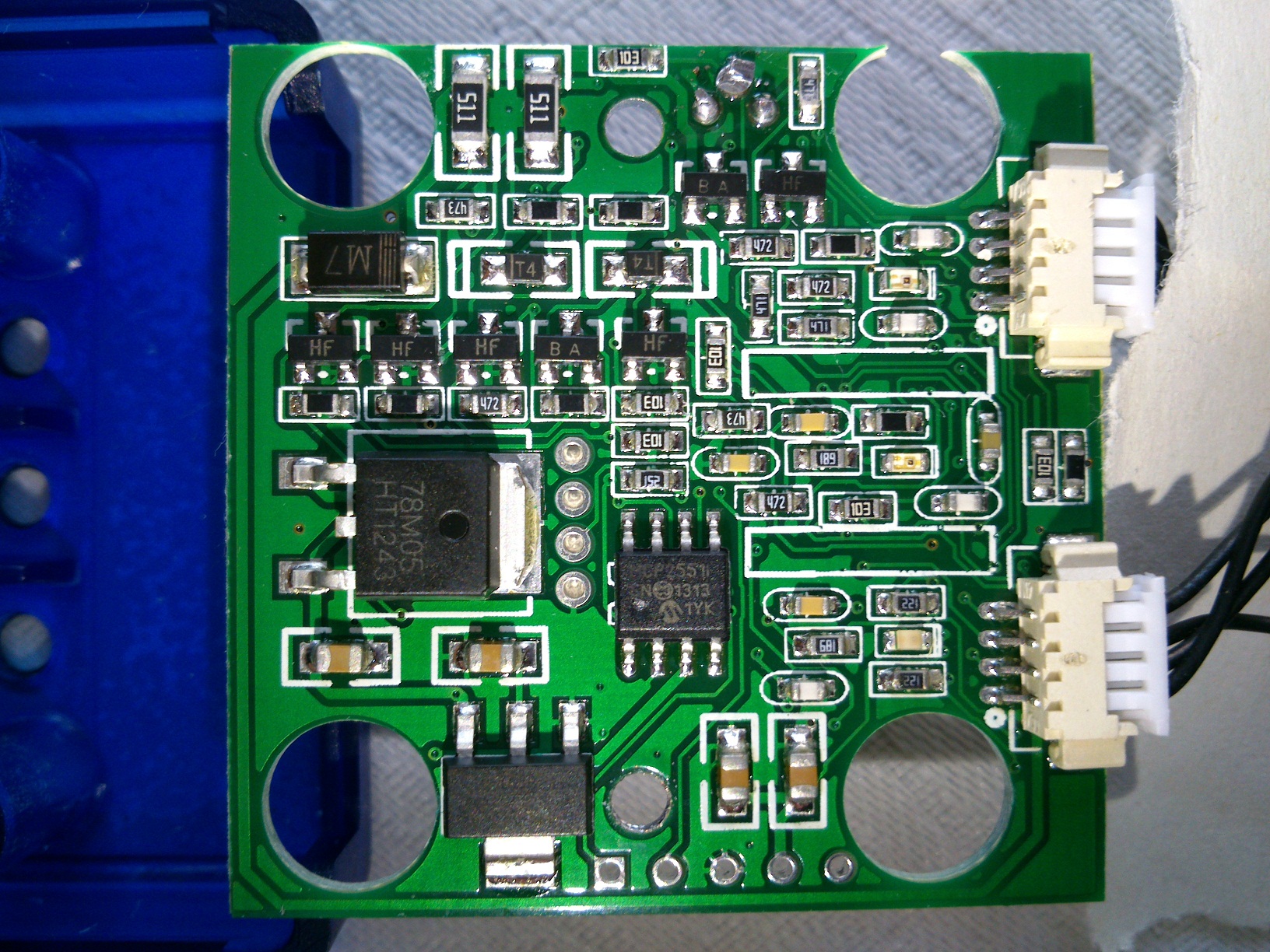

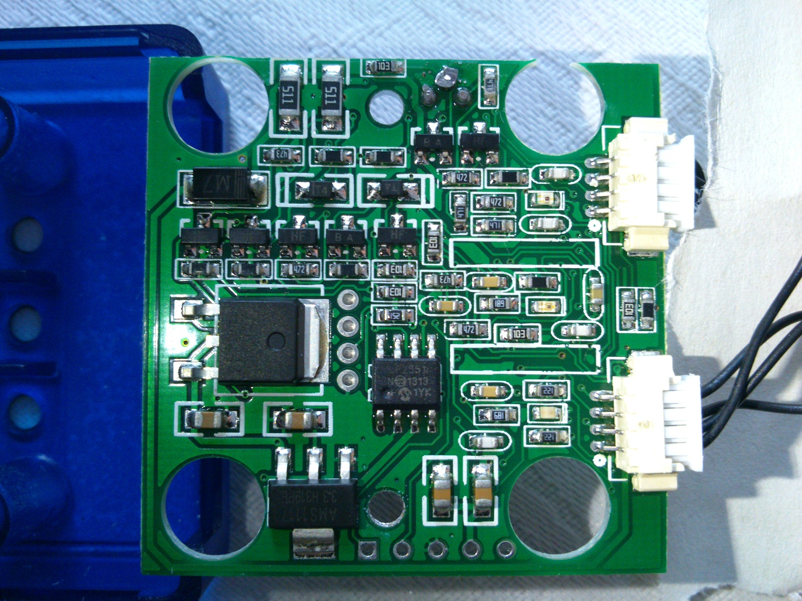

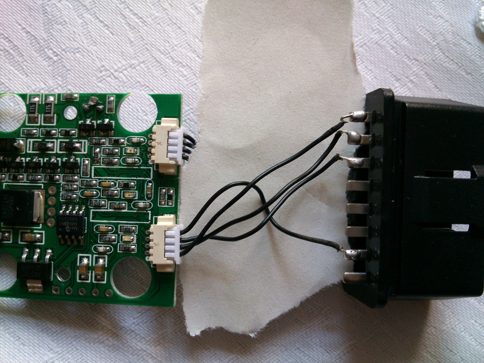

And explanation of the points 1 ; 2 ; 3??
I'm just marked to show that is not easy to follow the interconnects.

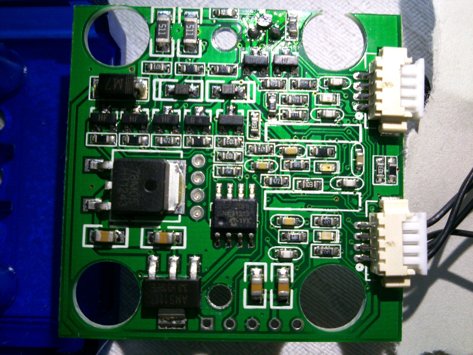

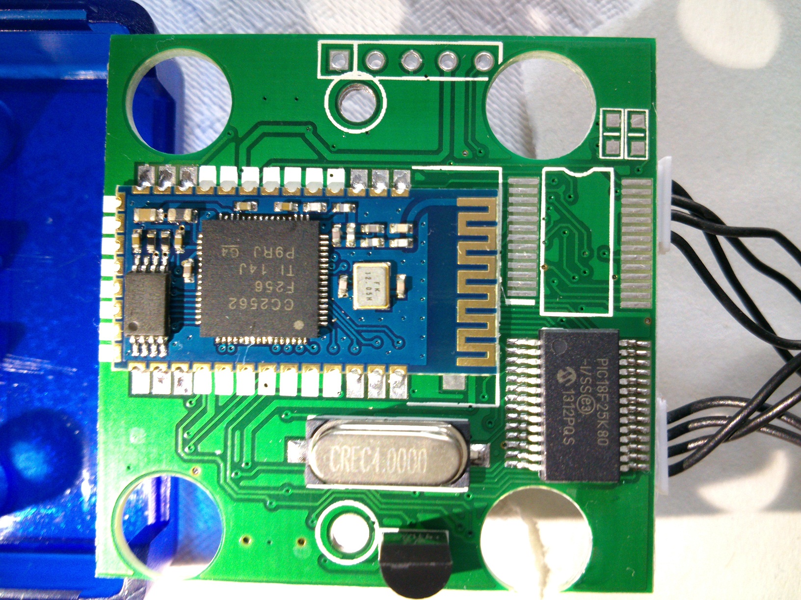

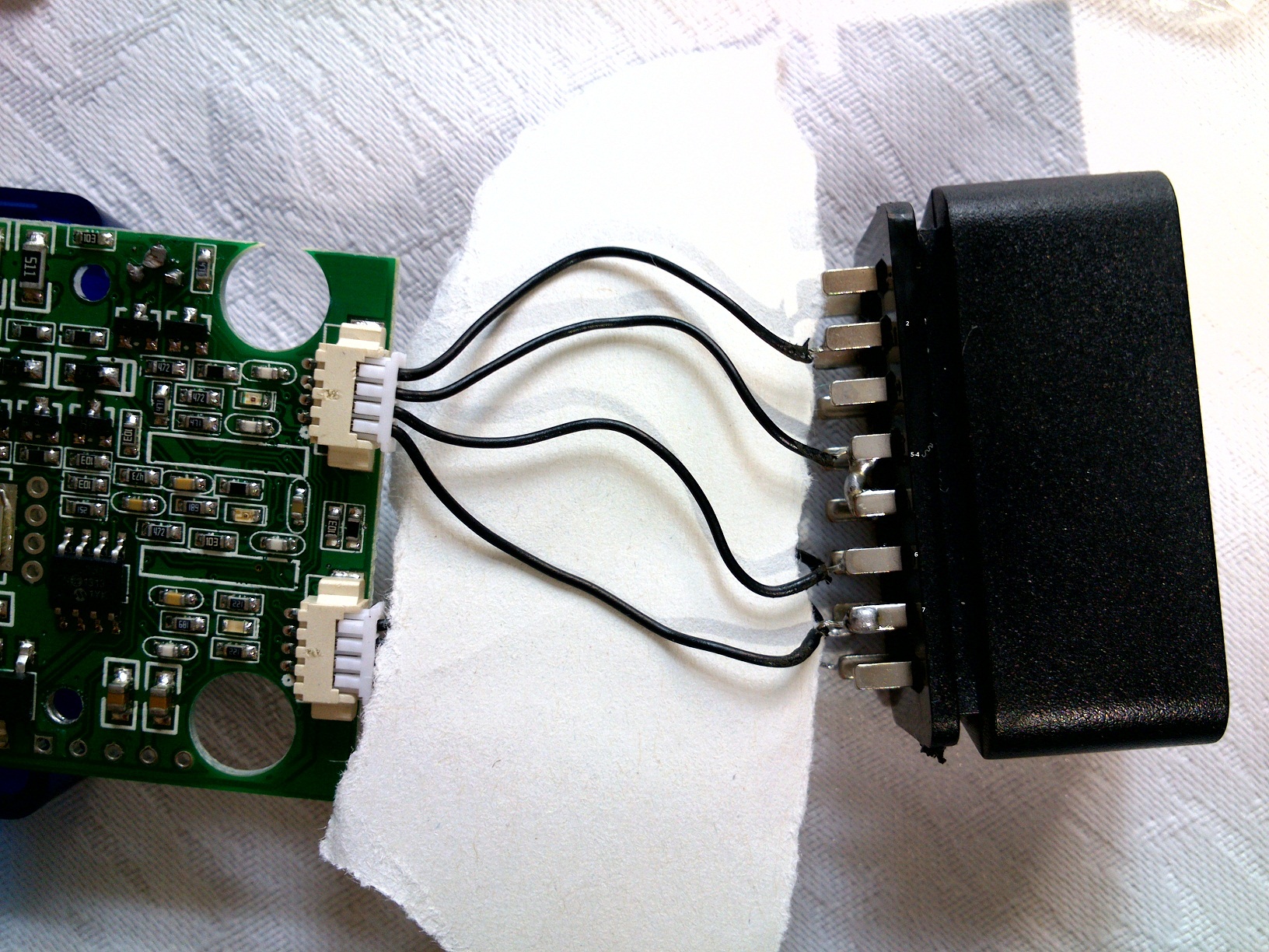

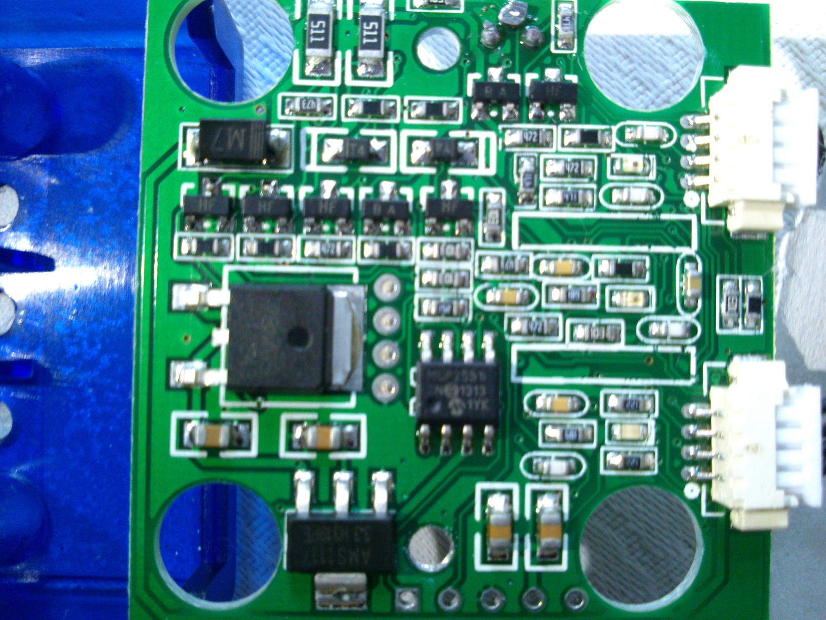

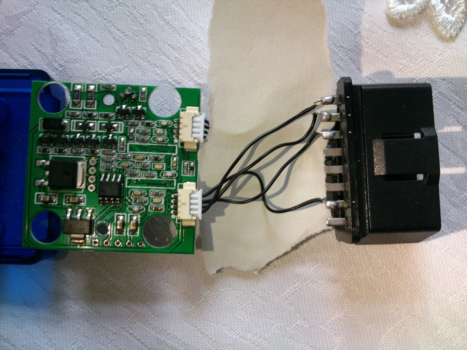

Hello Jordandc
After close as possible persecution of the tracks I can not see any bridge resistor !
Thus, the interface should also Multiecuscan with the CAN bus protocol to read.

so you think that all is good?
So why multiecuscan reading Just engine?
pls give Me any solution

Eddy i make a bad.
My interface is connecting to abs and engine in grande punto. No other. I want to remove service interval but can't connect to service option.
So you think that elm allow to connect other options? Hmm so if my elm is connecting to engine and abs this could be my computer problem?

Hello Jordandc
And on the steering??
For all other controllers you use the yellow adapter A3??
It really is not a computer problem!

Eddy engine and abs working. Im not checked sterring, because I want just remove service inspection. I bought yellow adapter but also working. Fiat Linea is also connecting just engine, as I know Linea need adapter just to abs, I think.
So in my opinion this is interface problem.
Maybe can you through your eyes again.
Edit: As I see in Elm 327 Faulty thread, my interface is the first, which no one can solved problem =[

Eddy I own voltmeter and ohmometer If you tell me where to put + and - im not good electronic.
I really want to solve that elm. I think that this is resistor problem.
