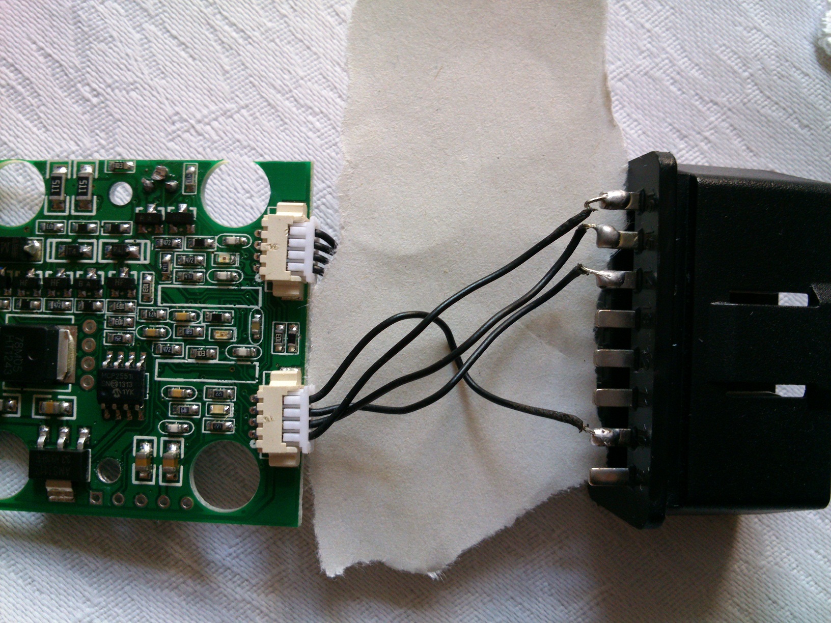

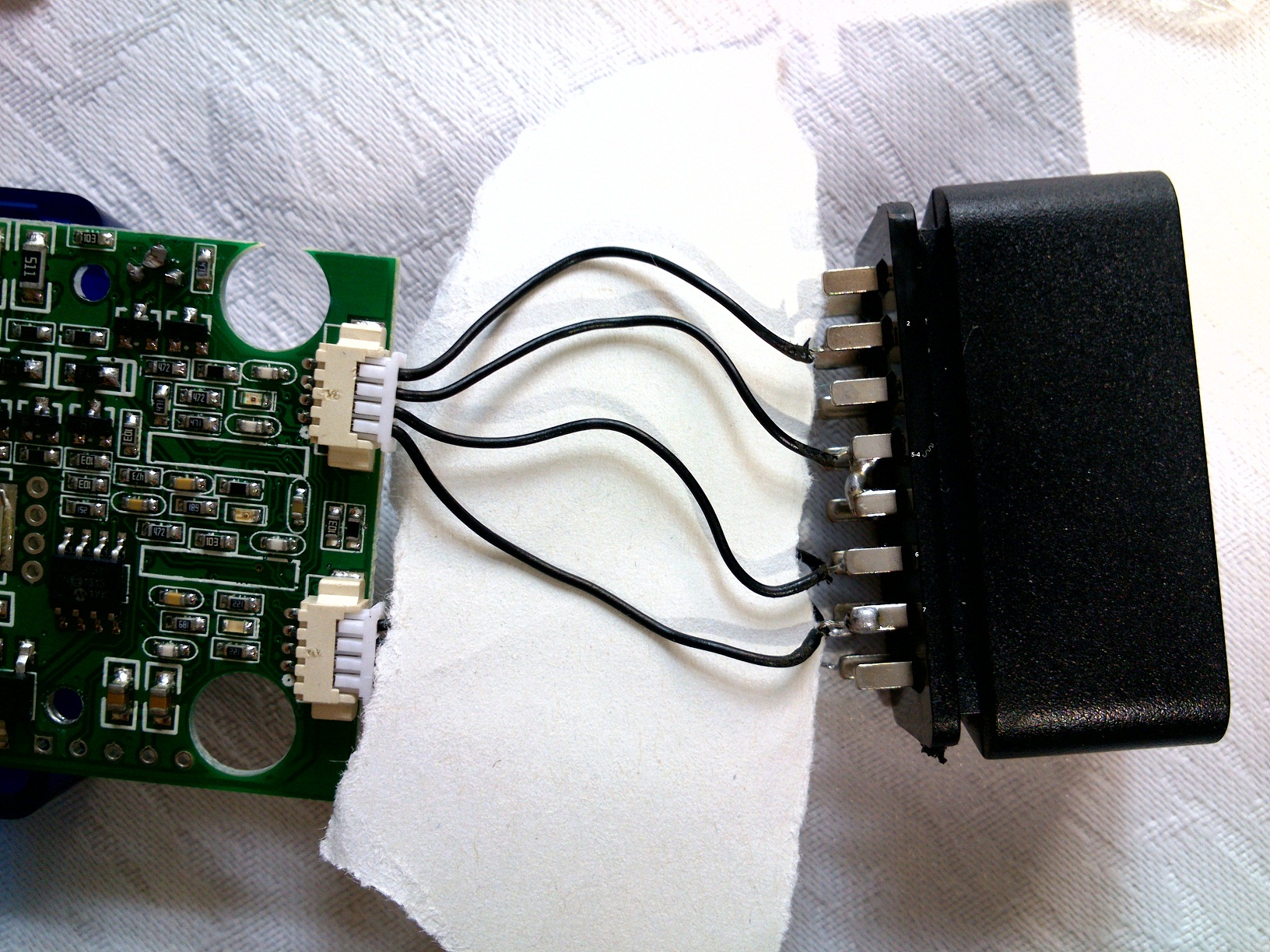

And explanation of the points 1 ; 2 ; 3??
I'm just marked to show that is not easy to follow the interconnects.

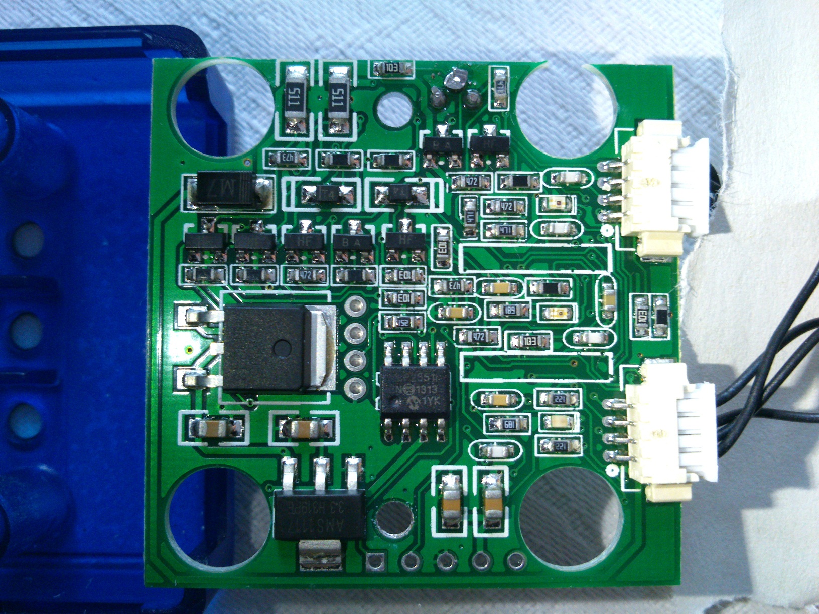

Re: Elm 327 v.1.5 (V Gate Bluetooth) Connect problem

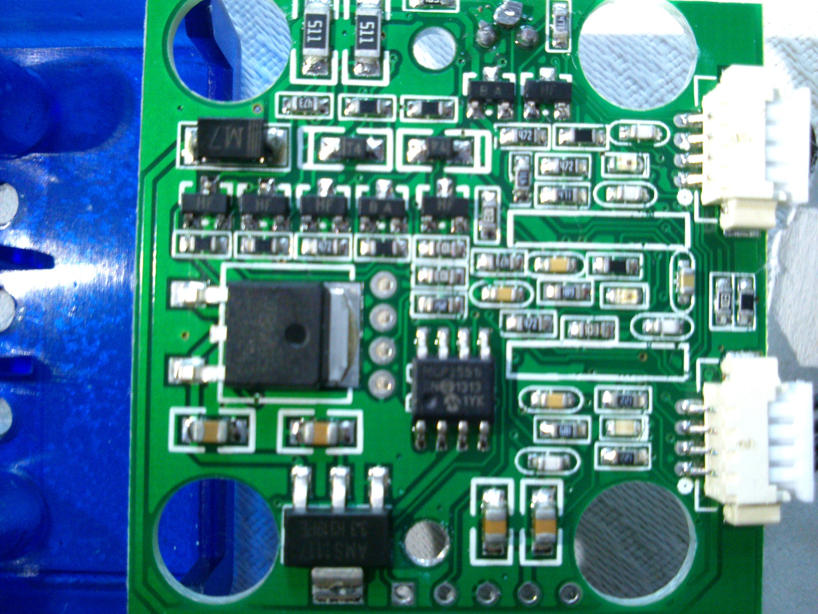

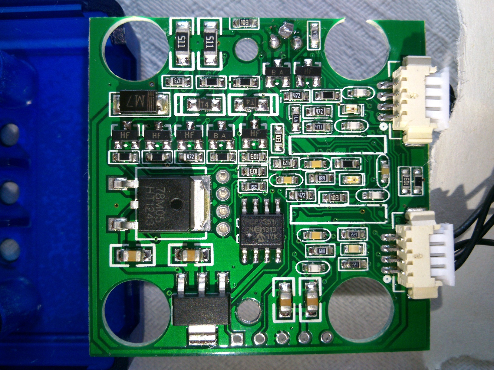

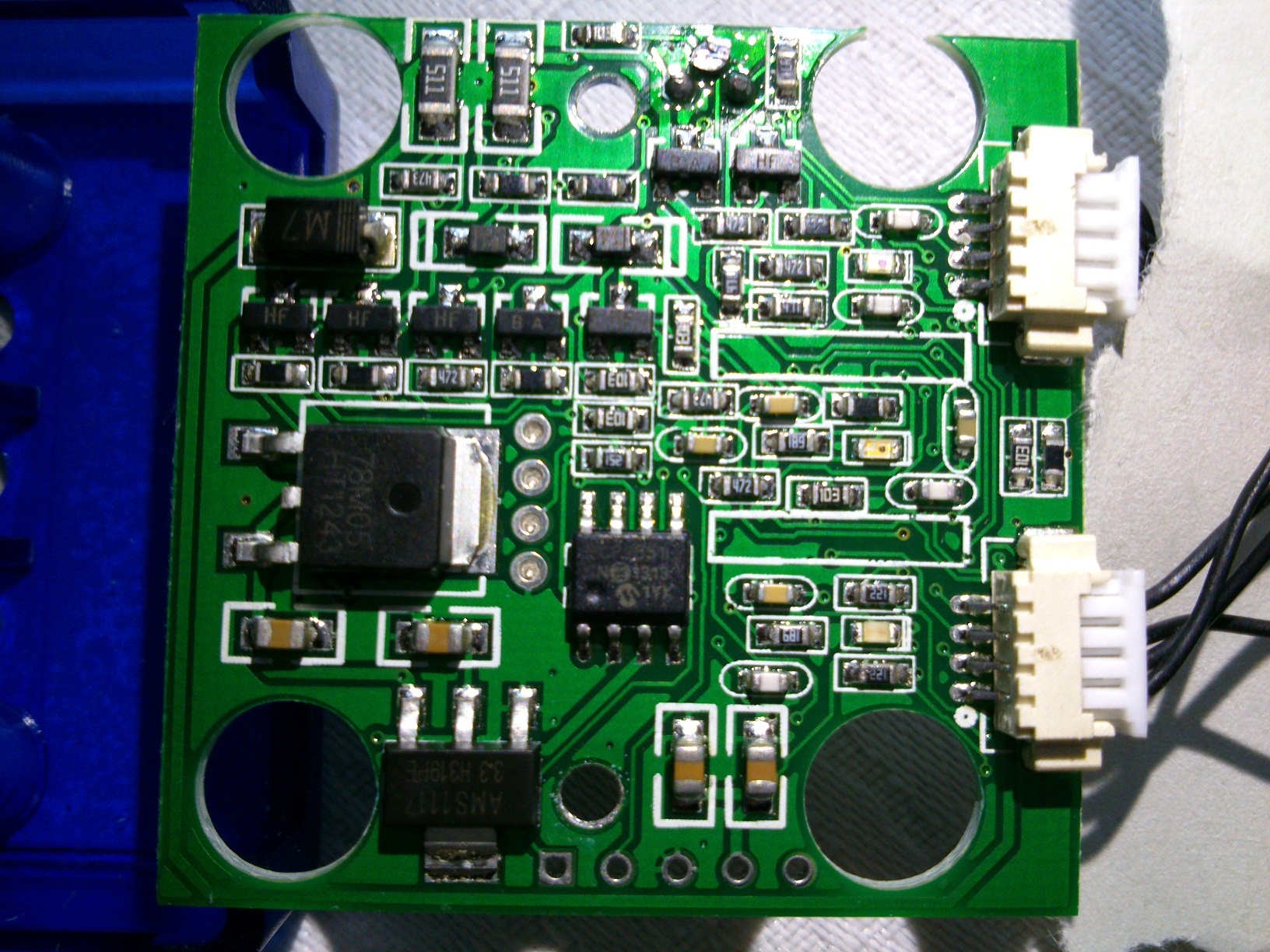

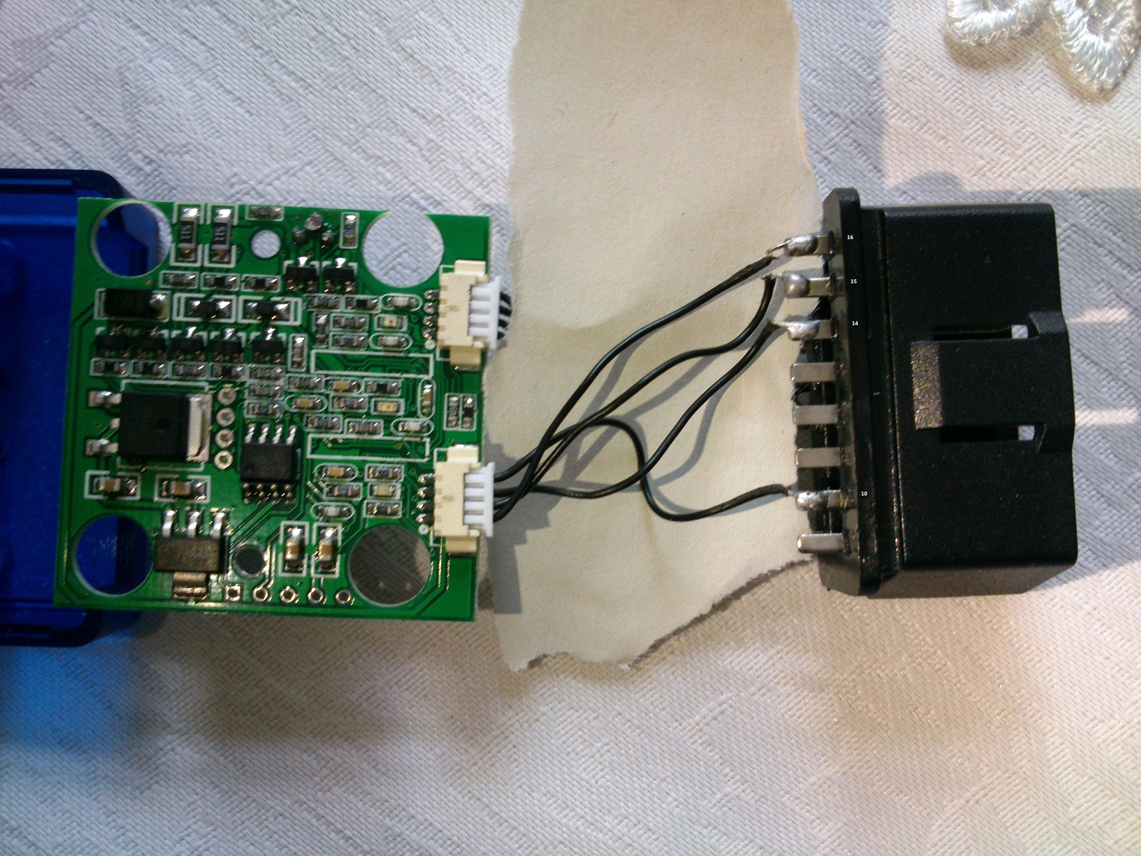

Hello Jordandc
After close as possible persecution of the tracks I can not see any bridge resistor !
Thus, the interface should also Multiecuscan with the CAN bus protocol to read.

Eddy I own voltmeter and ohmometer If you tell me where to put + and - im not good electronic.
I really want to solve that elm. I think that this is resistor problem.
